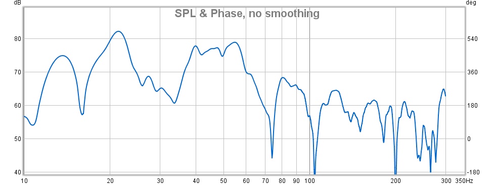

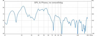

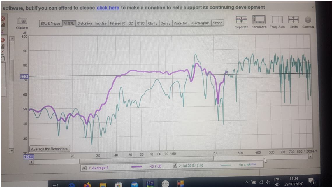

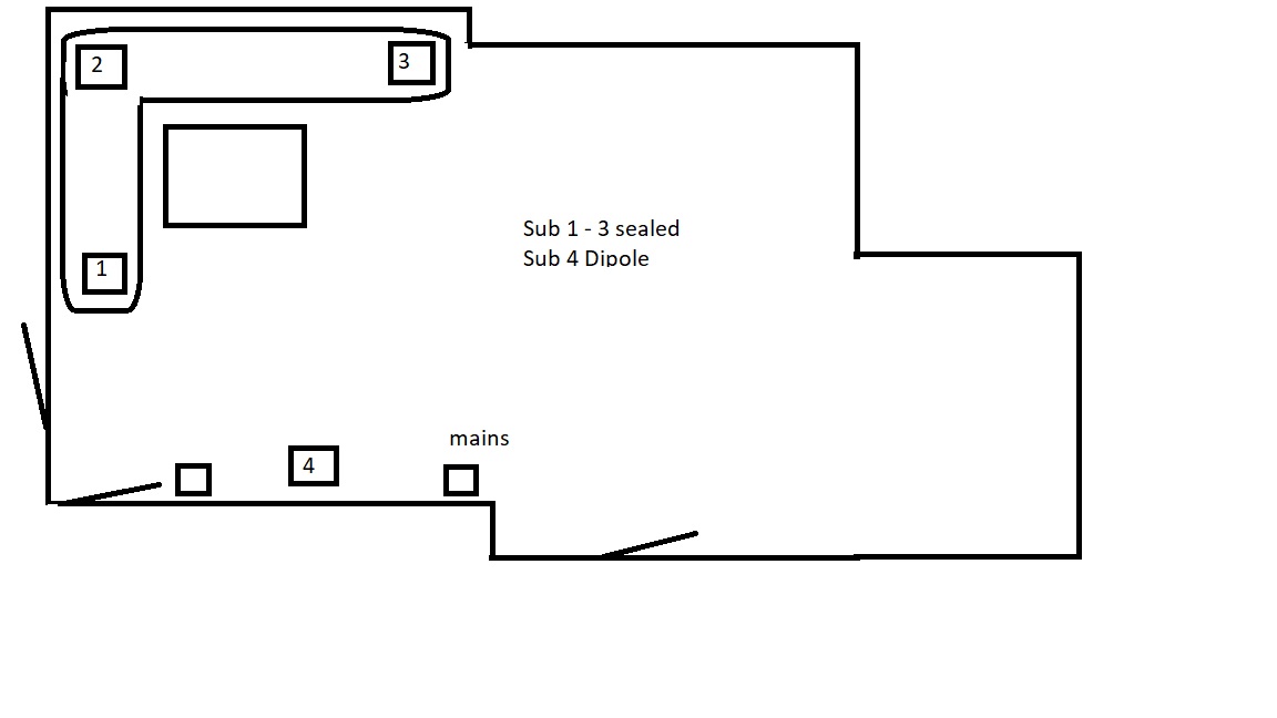

After reading most of this thread, the whitepapers and trying to generally learn some acoustic principles, this is what I managed for first try. There are serious limitations since this is the family living-room, and scattered "sound-boxes" all around is not too welcome by the better half, but also the room has few options in regards to free space and variations in placements. Room is around 35m2
System consists of three small sealed cabs with low profile 10" positioned under the sofa, plus one H-frame dipole centered between the speakers. MiniDSP 2x4HD and two power-amps. Too much compromises to achieve any "perfection" but when I had a few go's at the setup I got bass that impressed me quite much. XTZ speakers, too close to front wall, 6,5" vented with some stuffing in ports
What surprised me was what looked great in REW sounded like a dreadful, incoherent and muddy mess. This was with individual delay. New try without delay, but could not get a very smooth FR, but this sounded better than any other "living-room" hifi I have heard as I can remember. Not perfect, but engaging and quite precise
First picture: Thick Purple = average four seats in sofa / green = speakers only at best listening pos.
Second picture: Thick green = average four seats in sofa / purple best listening pos. / red = speakers only at best listening pos.

Why do you have the subs playing out that far? Where do you cross your speakers at? I’ve had best results rolling off the subs at 70hz. By 100 the speakers blend into them.

I can't make specific recommendations without a detailed analysis of the setup, and I don't have the ambition to get into the details. But here are some generalizations:
I have found that in general the subs don't all play at the same level, hence output capability would not need to be the same either. Hence a "bigger to smaller" mix would be appropriate. As far as "sub quality" goes, I don't give that much credence - all long as the sub is not being overloaded (which is far easier and more common than most people think) all subs are about the same to me. Just be sure that none of them are being overloaded and you will be fine.

Show us the graph of your subs playing with your mains. There is usually a mess in the 100-150 hz range where they are interacting with each other. You don’t need the subs past 100 if your speakers are capable of that. It doesn’t sound as clean either. Too bassy.
Like Gedlee states, there are no crossover. The subs all have LP, but at different frequencies. I have not experienced the blending above 100Hz to be an issue at all, but it took a lot of testing before subs blended nicely with mains. The measurements are from last summer and after these attempts I have since changed the speakers twice and have every time managed to blend the subs well, but FR in REW does not always look super smooth.
Is there any general rule in regards to using individual delay in MiniDSP? On my first attempt I just added delay individually until curve was on its smoothest, but adding around 12ms delay, I guess is equal to one whole wavelength around 80Hz. So my notion is that cant be too successful.

I guess one of the downfalls of my setup are that I am stuck with placing the subs in one half of the room (under sofa), so I probably can never achieve proper smoothing of room modes. Maybe I could post measurements of all sources individually, and you could help me understand where my setup needs most attention?

Lalaland: Try play with the inbuilt room simulation in REW. The tool it awesome to give you a grasp of what is going on, when moving subs around the room. Flipping phase, changing delay, crossover and so on. You Can also chance the F3 of the subs and mains. Bonus is that it Can simulate multiple seat variation on the fly.
I will do that when time permits. I really like REW and am all for learning how to use all the functions, but I am really on a steep learning-curve on all this acoustic stuff

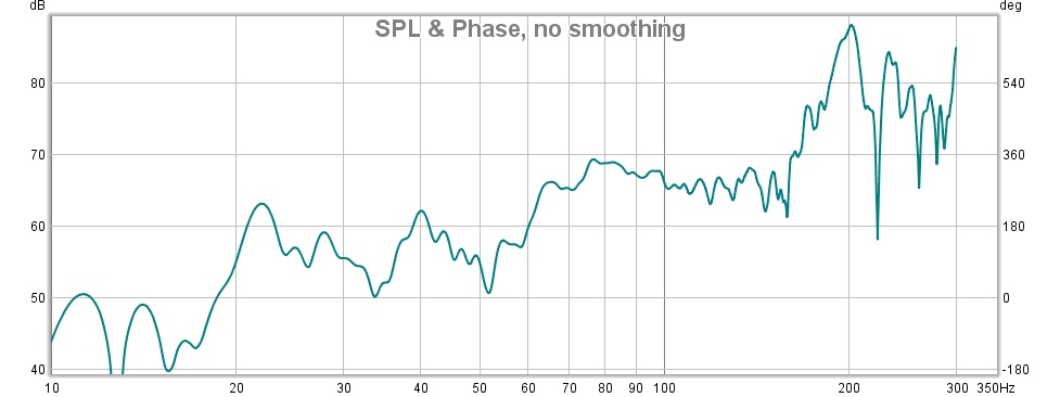

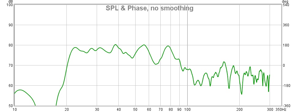

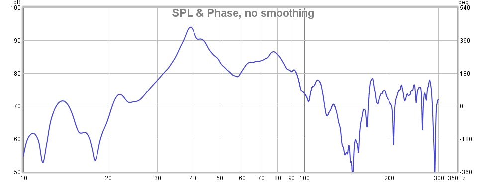

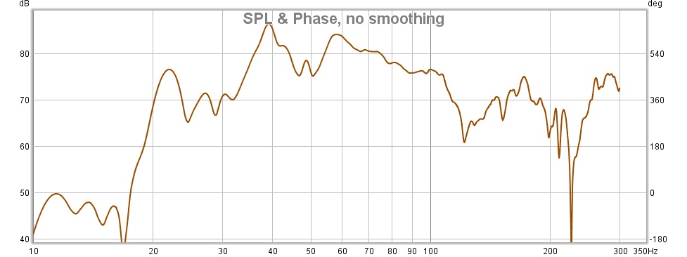

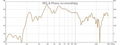

Posted some measurements from listening pos. All is taken with mike in one spot
I just mean relative phase between the subs. Changing phase, either by polarity or phase shift, can have huge effects on the combined response. It's all about how all these sources add up at the listener that matters - specifics aren't important as long as the solution works to smooth the response.
Sub 1 is clearly going to be the dominate one owing to its already smooth response (unless its low output limits its ability to be the main sub.) Then you'll need something to fill in the deep hole at 150 Hz because sub 1 can't do that.
Got it! I'll have another go as soon as I can have the house to myself for a round of measurements.
Sub output is indeed limited as you point out. They have a chunk of boost down low(a la Linkwitz transform), just to get some output down to 20hz. Without boost they roll off at around 40hz but output is off course up.
That big hole around 150hz was the reason I made the dipole (Sub 4). Another issue is the big peak at 40hz from the mains. I have no EQ on them, so maybe some stuffing in ports or some other trick is needed
