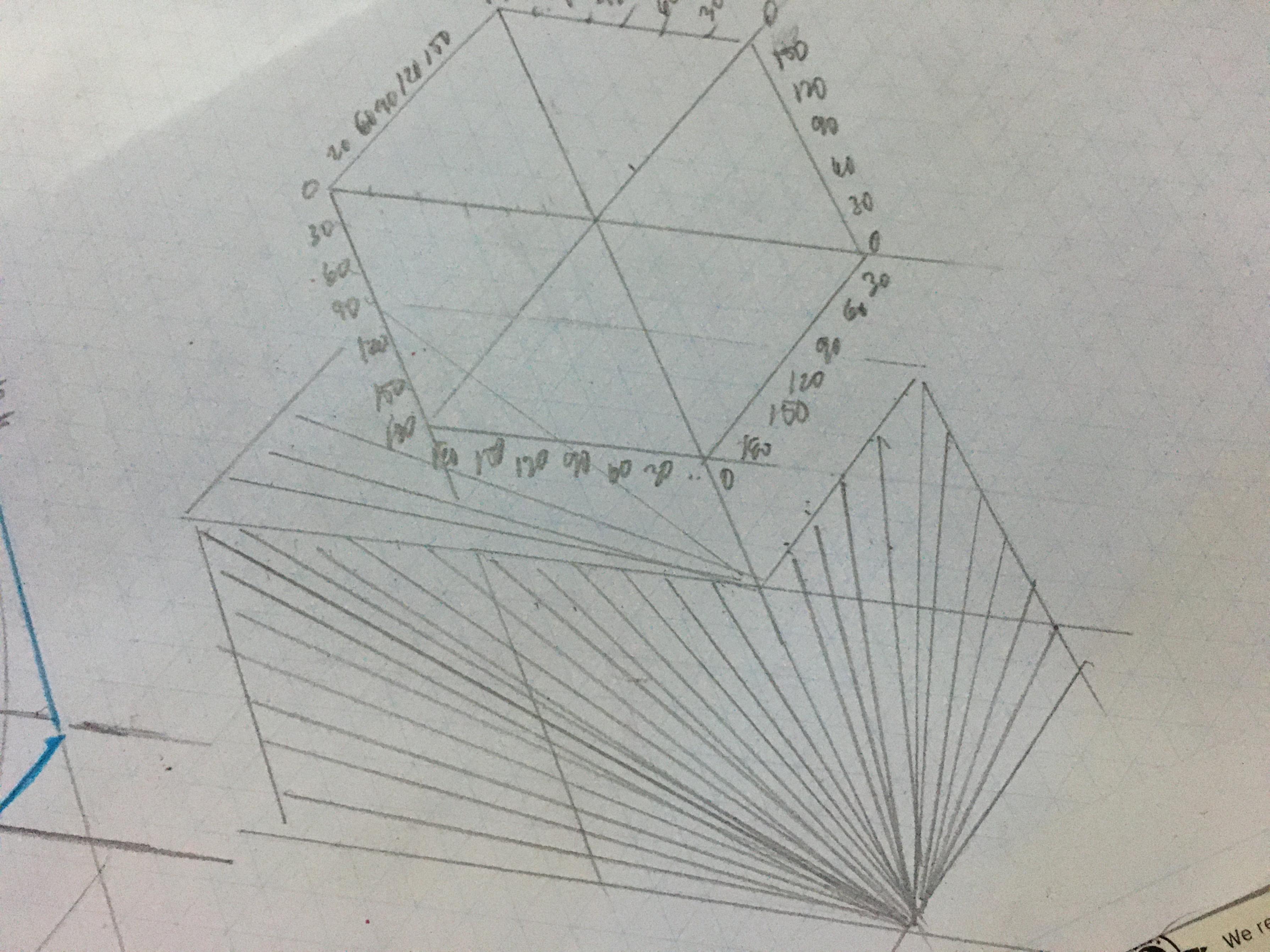

If I drive an 8thbirder qw pipe from both ends at 0.5326 from zero and 360 . I am forced into a window of simulation that’s incredibly unique.. once I add a certain waveguide length (0.5236) I get a perfect alignment out from 860-8600….. all in store if 860 to beyond as total void per the seconds in a day on earth minus 400.
All because of the speed of light as 29.99792458 is arc seconds to 0.5236 radian ?
What if I apply this to the subwoofers AND the room? In a car it’s a huge reflection off the windshield. But if a bass trap is located in a corkscrew at the other end … another chapter in an endless battle against outle own offset in time (and reality) as the optic nerve and brain and hearing all gave a qw pickup functions to default to I guess? That’s at the high and low end of maths too?
That box is 360 plus 30. But it’s a waveguide Shake too?it’s not just a poor like the rest . It’s a parabolic/conical 2x in 30 cm.ot item that aouhnoerfectky to 8600 and 860 from (86.4?) .

6 of the same circle will surround one perfectly. But in 3d as sphere it becomes 12. If tiu look at the volume of a Sphere I natybbs it’s 3,4,5,6… abd240 dinensin versions it gets stake at about 5.25 in the ongoing factor of 0.5, 1,2, 3.142857, 4.1888, 5.2…. It flattens out as the acruing size in 1,2,3,4,5,6… of volumetric
cm3 cubed, cubed.. cubed. Just like with harmonic cycles?
But start in the box (one qw path) before the big box 3 more from
The opposite side of the driver ) and then the biggest box is the rooom? But it’s got miners to work with instead of random messes?
A hexagon as 30 degrees in 180 at each side (last pic) is a ot of phase angles from everywhere ? You can draw this ? But also it’s offset in a box by one cube in 9 or 3 of them grouped. Make it all 30 cm and it’s seer okay unique to 360 and offset of 1440, 720, 1080 is the same as leap year. And (the math and simulation say it’s ‘perfection’? It’s working the 0.3492 of 7. As it’s does in qw pipes in 4th order offset driver entry. (Odd harmonic ?)

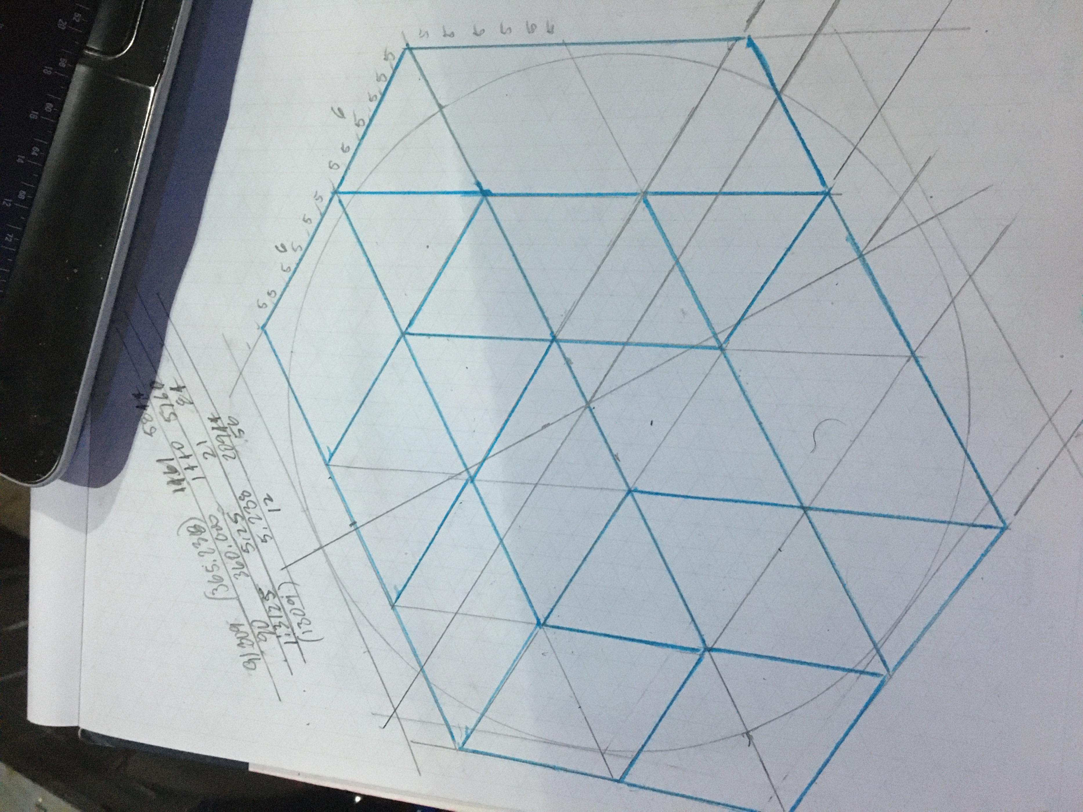

6 circle will surround one perfectly. But in 3d as sphere it becomes 12. If tiu look at the volume of a Sphere I natybbs it’s 3,4,5,6… abd240 dinensin versions it gets stacked at about 5.25 in the ongoing factor of 0.5, 1,2, 3.142857, 4.1888, 5.2…. It flattens out as the acruing size in 1,2,3,4,5,6… of volumetric
The opposite side of the driver ) and then the biggest box is the rooom? But it’s got numbers in sync to work with instead of random messes?
If we look at more than 360 as 365.25 we see the 1461 at Saturn(not 1440) . Or 1433. Or more as that Elipse I so shape has no offset . Not we can do that ? In the speaker duct? And the room?
I find a 1.75” elipse fits a 6x6 cube ironically.? Also the Elipse is 22x44mm /7 ? Look at this metric to standard issue and they overlap in sim system that’s hard to see why nobody would?
6 circle will surround one perfectly. But in 3d as sphere it becomes 12. If tiu look at the volume of a Sphere I natybbs it’s 3,4,5,6… abd240 dinensin versions it gets stake at about 5.25 in the ongoing factor of 0.5, 1,2, 3.142857, 4.1888, 5.2…. It flattens out as the acruing size in 1,2,3,4,5,6… of volumetric
