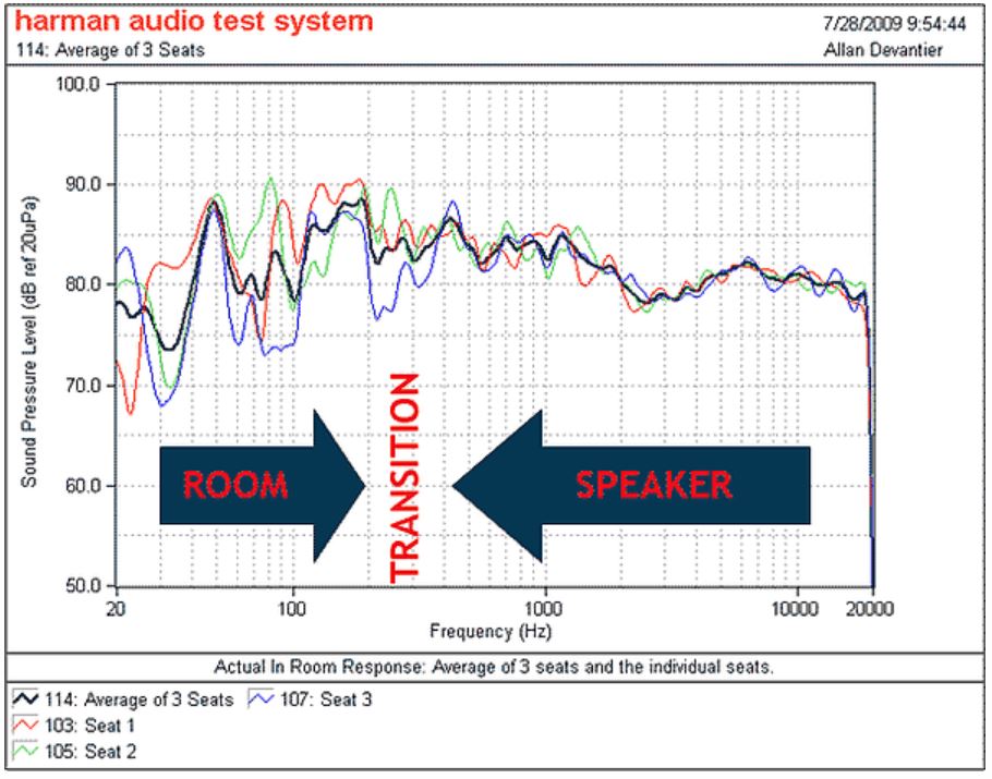

Perhaps a little graphic for small room acoustics can help describe that below Schroeder (i.e. the rooms transition frequency), the room is in control and above that the loudspeaker is in control:
attachment.php
Thanks Mitch, this is an important point.
Notice how a "transition" is shown, meaning that both sets of characteristics hold to varying degrees. I would say that the example is a fairly small room, so the Fs is very high, about 300 Hz. in this example. The room does not have much LF damping (a typical problem.)
Yeah Mitch, second the thanks.
I'm familiar with Schroeder frequency. I got it to about 60 Hz in the room described earlier, the combination of room size and quite a bit of damping.
Had a pretty smooth RT60 across the spectrum of about 0.2-0.3 sec.
And yep, I totally get there is a transition zone, if for no other reason than RT60 variation by frequency. And then there's the shape of the room, and how does it connect or open up to adjoining spaces...lot's going on huh?
