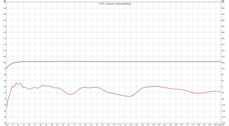

I subscribe to the Geddes approach of multiple subs. I have (4) asymmetrically distributed subs in a room that is 16 feet wide, 10 feet tall and 26 feet deep. Small 50Hz notch is a ceiling mode and not audible as it is not wide range. Getting close to 200Hz or so is probably Schroeder frequency transition. Only area of boost EQ is around 15-30Hz area, which makes absolute sense acoustically. 3 days and 6 hours of measurements each day. Only manipulated sub positions, various XO points, slopes and phase. No delay used at all. Mains run full range without a HP crossover.
LF response, 50 dB vertical range, 5 dB vertical scaling, no smoothing:
LF response, 70 dB vertical range, 10 dB vertical scaling, no smoothing:
LF response, 50 dB vertical range, 5 dB vertical scaling, 1/12th octave smoothing:
LF response, 70 dB vertical range, 10 dB vertical scaling, 1/12th octave smoothing:
LF response, 70 dB vertical range, 10 dB vertical scaling, 1/12th octave smoothing, with Target Curve overlay:
Subjectively I am deeply satisfied. Target Overlay shows an overall gentle rise from 150Hz to 20Hz of about 5 dB which I find subjectively more 'pleasing' and dynamic. That's still experimental but the only area of experimentation at this point.

You think my FR is pretty darn good? Unfortunately, it isn't. It may look good with some smoothing but it sure does not sound good.
Here's another plot with 3 subs with proposed smoothing. This was the best result I could get but it still didn't satisfy my ears. I could feel some vibrations behind my seat so clearly something wasn't right.

Can you repost your FR plot? It’s very hard to interpret as is because it lacks resolution. Please change your vertical range to 50-100dB and change your horizontal range to 20-200Hz. Remove all smoothing at first to examine the “warts” in the frequency response curve.
How many subs do you have? What are your main speakers? Do you have any low frequency damping/room treatments in your room? What is your wall construction? Concrete or wood? A picture would be useful.

You could have awful sound despite a great FR - with distortions, troublesome reflections, dunno what.....Here's another plot with 3 subs with proposed smoothing. This was the best result I could get but it still didn't satisfy my ears. I could feel some vibrations behind my seat so clearly something wasn't right.
But as far as your FR goes, I'd send it to the Guiness Book of World Records. It is as perfect as they come.
