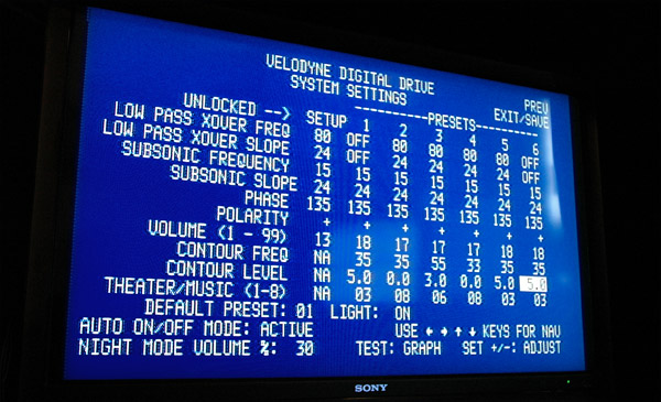

What if one doesn't have any external DSP? Some subs have all kinds of settings (hi/lo pas filter; hi/lo slope, 8 band PEQ ...). I wonder if this could replace an external DSP processor?

Many subs now have digital settings so I don't see a problem setting them to exact values.
Here's one example.
Thx
MSO is just a program than can "try out" dsp settings. So every parameter that is available in a dsp: delay, gain, xover slopes (all kinds), all pass filters, parametric EQ filters, shelving filters, polarity reversal, notches. So all filters that exist in IIR dsp's. You're free to add filters as you see fit.
That Velodyne also had music/HT setting and contour filter. You can't simulate those of course as those are unknown EQ filters. Xover slope could be LR24 but maybe also some other slope. But you're welcome to try it out 🙂.
OK, so MSO is proposing filters which you can insert in a DSP? Am I getting this correctly?
I don't see any DSP unit at your pics...
Contour is for boosting or cutting the signal in reponse to specific types of source material. It's like changing the volume at only one bass frequency. It can be turned off.
Music/theater setting is not really a part of signal processing. It's for controlling servo gain.
