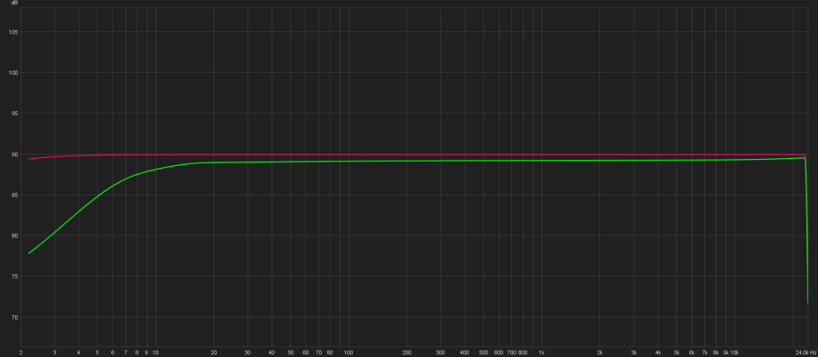

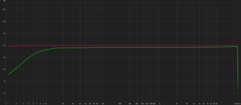

For those who go for the isolation solution, here is an inexpensive route:
TY-250P Triad Magnetics | Mouser
I've included measurements of the frequency response of the transformer compared to a flat loop:
attachment.php
-3dB @6Hz on the low end. About 1dB of signal loss. I have distortion graphs if anyone is interested. Also you can wire it for ~5dB boost in signal with a little steeper low end rolloff.

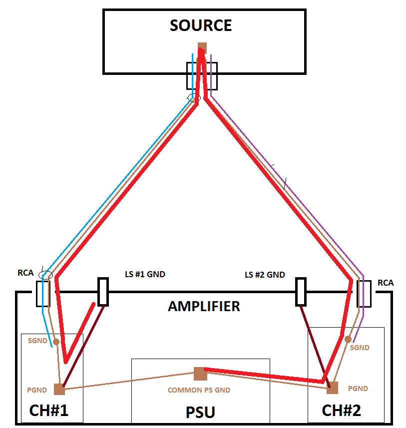

Hi!
I try my question here as well (originally it was posted here).
Question: am I right with this assumption about the RED line current?
What kind of solutions are there (without signal trafo isolation)?
Only a GND loop breaker resistor?
F7 has a current sensing resistor before the P-GND at the PCB.
Isn't this a problem if we apply a breaker resistor between them?
Thanks!
To be honest I'm still confused about this "looped" common RCA + PS
GND layout regarding both hum + common impedance coupling.
I just draw a 2nd image with the same layout showing a possible current path (RED line) via the signal GND loop:
  • let's assume there is a large output current impulse on channel #1
  • it goes out to the LS and comes back via the LS #1 GND "port"
  • then most of it goes of course to the common PS GND via the CH#1 P-GND wire
  • but because of the impedance of this wire ("loaded" with the actual output current)
  • if there is no current at the moment on channel #2
  • a certain current can flow through the signal GND loop the other channels GND
  • in this case this current will modulate/distort the original signal
  • and in a special way because it's amplitude depends on the difference of the actual output currents of the 2 channels
Any thoughts on that..?

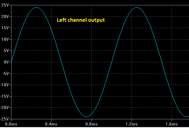

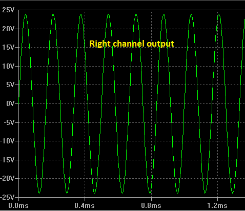

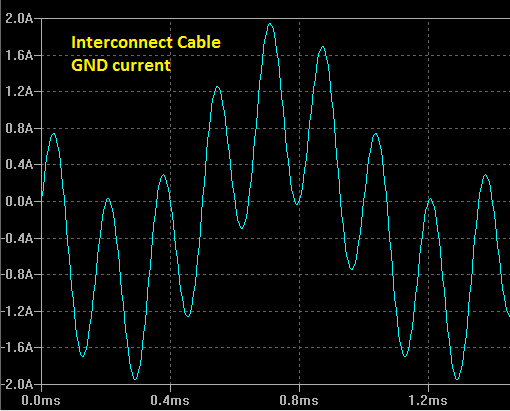

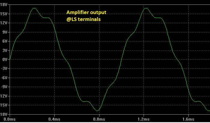

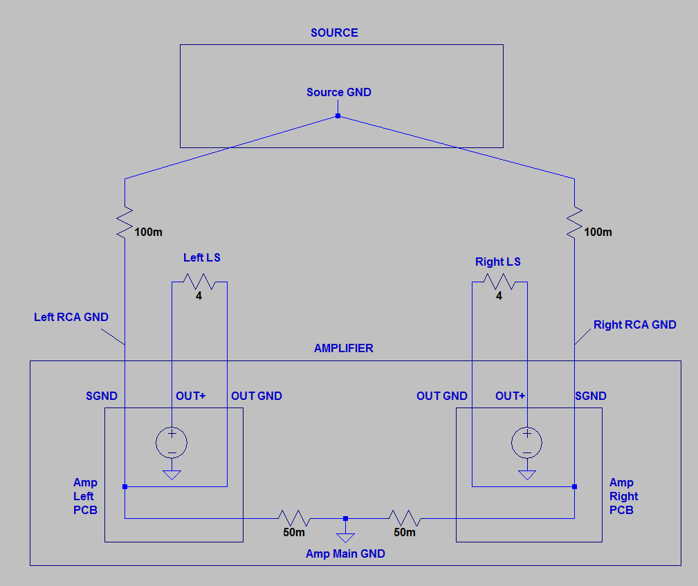

Here are my simulations:
  • on the layout you can see the simulated wire impedances: 50m and 100m ohms
  • output stages are represented with an ideal voltage source based on the main PS GND
  • left channel output is a 1kHz +/-24V sine wave
  • right channel output is a 6kHz +/-24V sine wave
  • on the last image the current of the interconnect GND wire is shown...
Or am I missing something..?

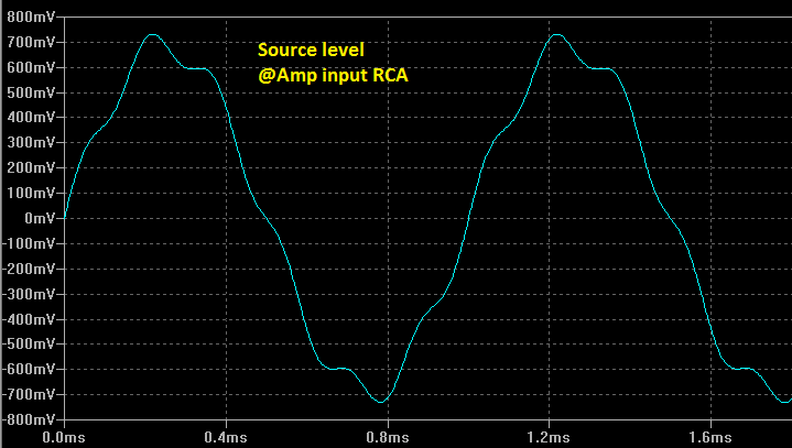

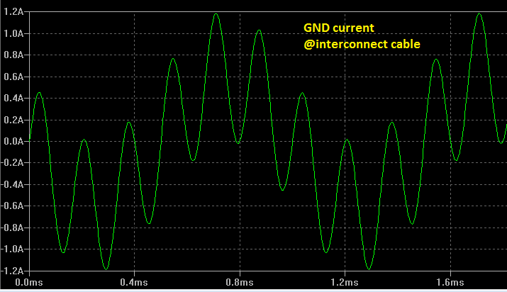

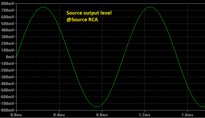

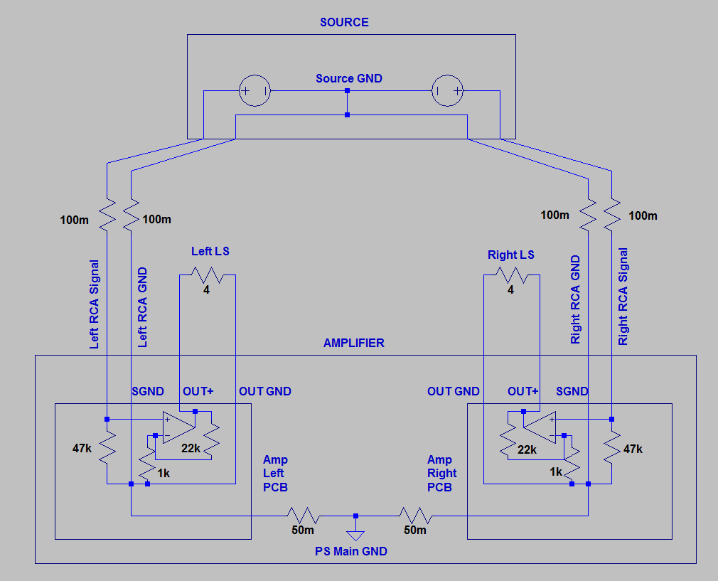

I just made a more sophisticated version with:
  • signal generators at the source
  • input stage simulated with 47k resistor
  • output stage simulated with opamp
  • applying feedback
Here are the results...
Cheers!
