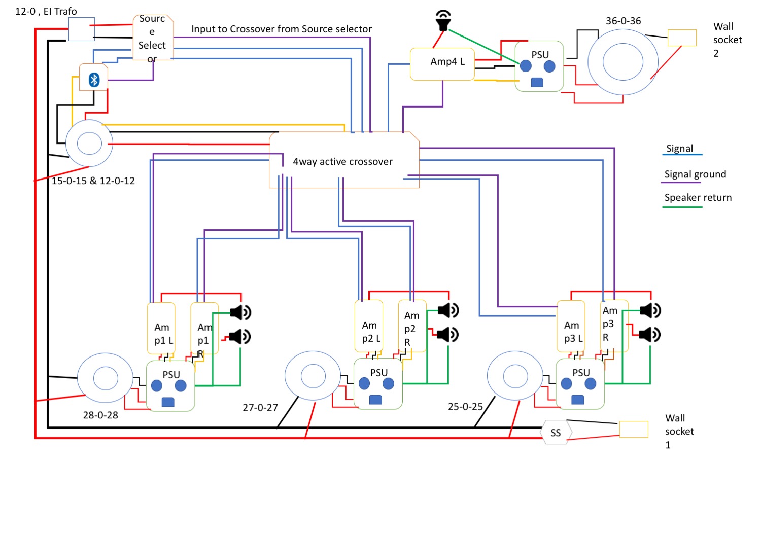

Hello Folks ,
Just finished my 4 way active project . When I tested individual amps( two p3As and 4 Elvee'Circlophones and single LJM150D ) they all performed really well. But when I connected all of them to 4 way active crossover, there is ground loop noise . can anyone suggest me better way to wire them all.
I went through various thread and gathered many information. I am seeking advice before implementing any changes.

Hi. There are plenty of potential loops there through the signal wires, it depends largely on what is inside the loops, therefore the actual physical layout is important. You may still have to cheat 😉🙂
Thanks for your note Scottjoplin. I understand there are multiple potential loop.
So far I have tried one option : I disconnected all 3 signal ground to the right
channel from active crossover board . but the problem still persist.
Next I want to try connecting all PSU ground to 1 star point and disconnect all signal ground from crossover board (Except Amp4= which is a subwoofer amp and located in a completely different enclosure). do you think that is good idea ?
With respect to physical layout : 6 amps (2of P3A and 4 of Circlophone ) are in same enclosure along with active crossover , source selector and bluetooth receiver . Amp4L(Subwoofer amp) and its PSU and 36-0-36 transformers are in another enclosure.
Connecting the PSU grounds together will probably create more loops. How are they connected to the chassis? Can you post pictures?

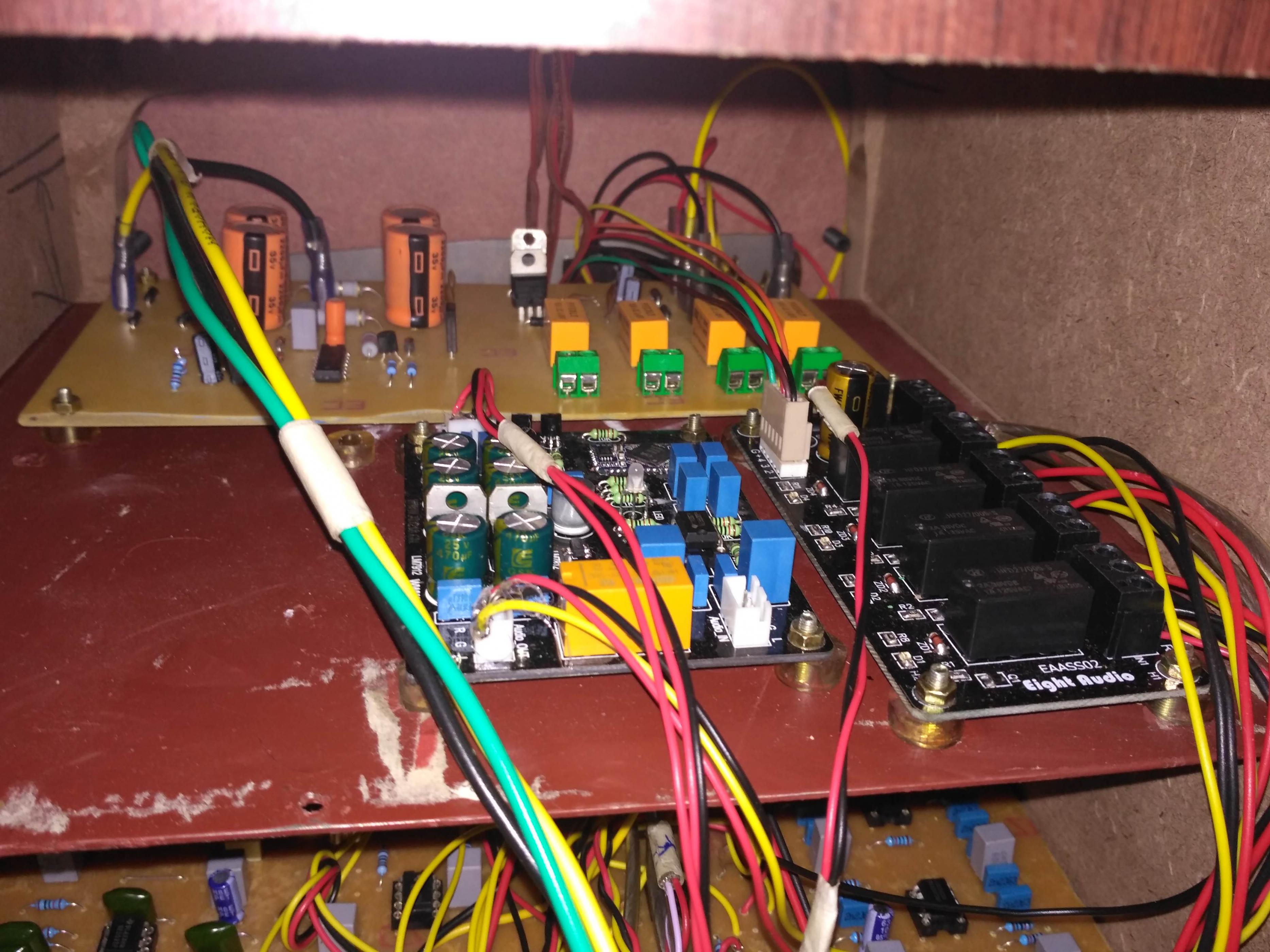

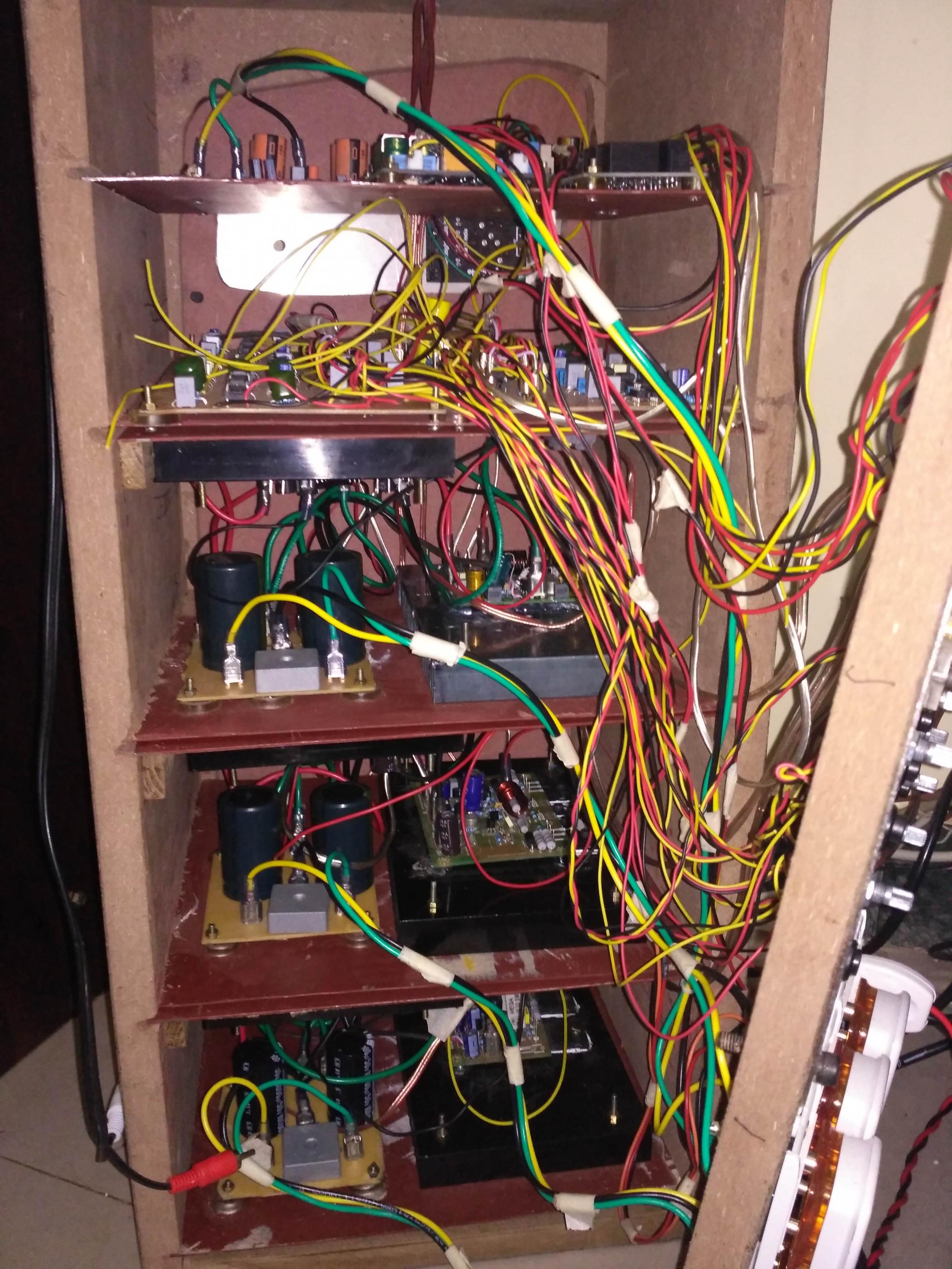

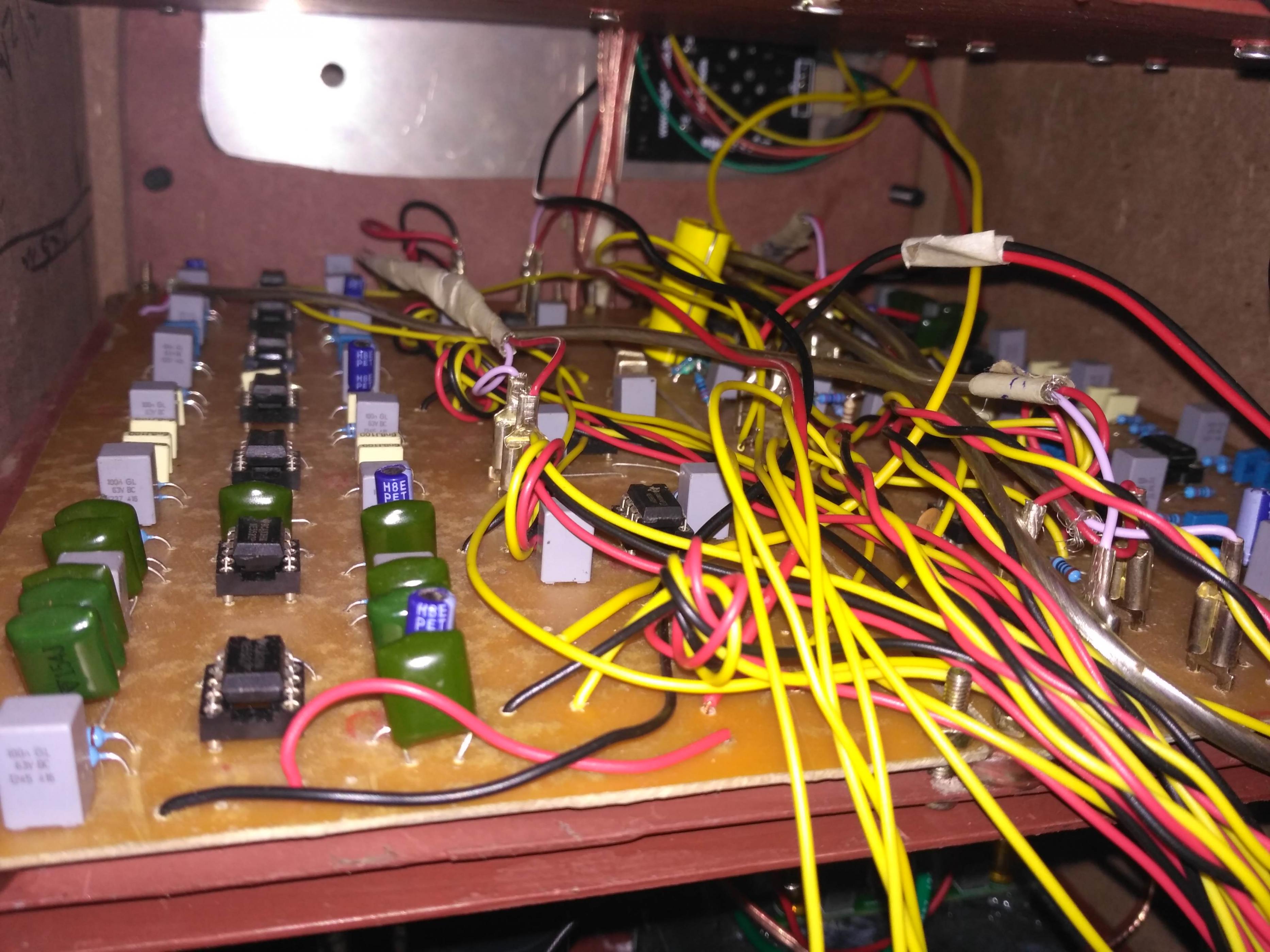

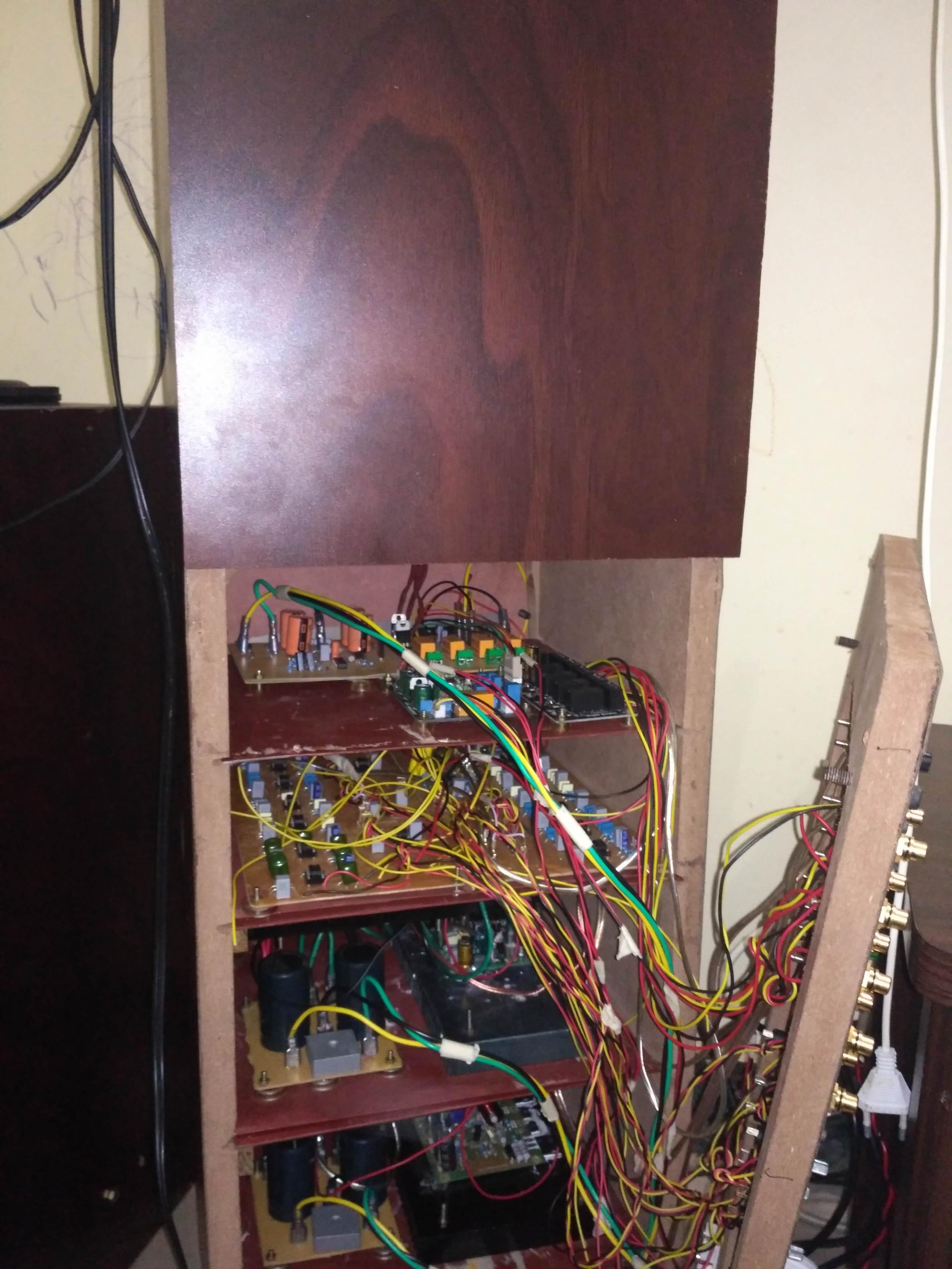

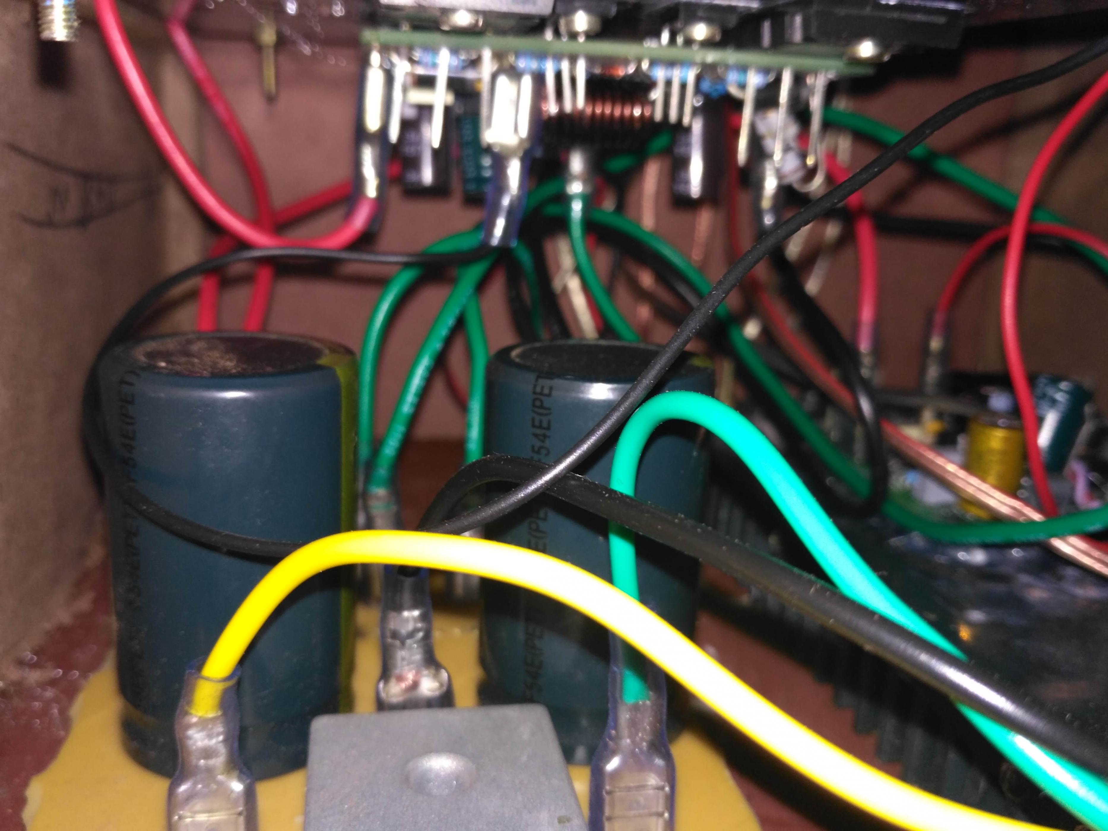

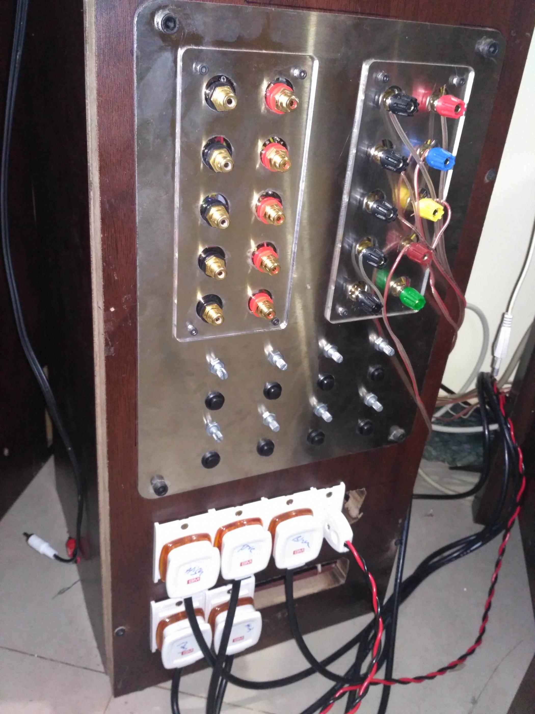

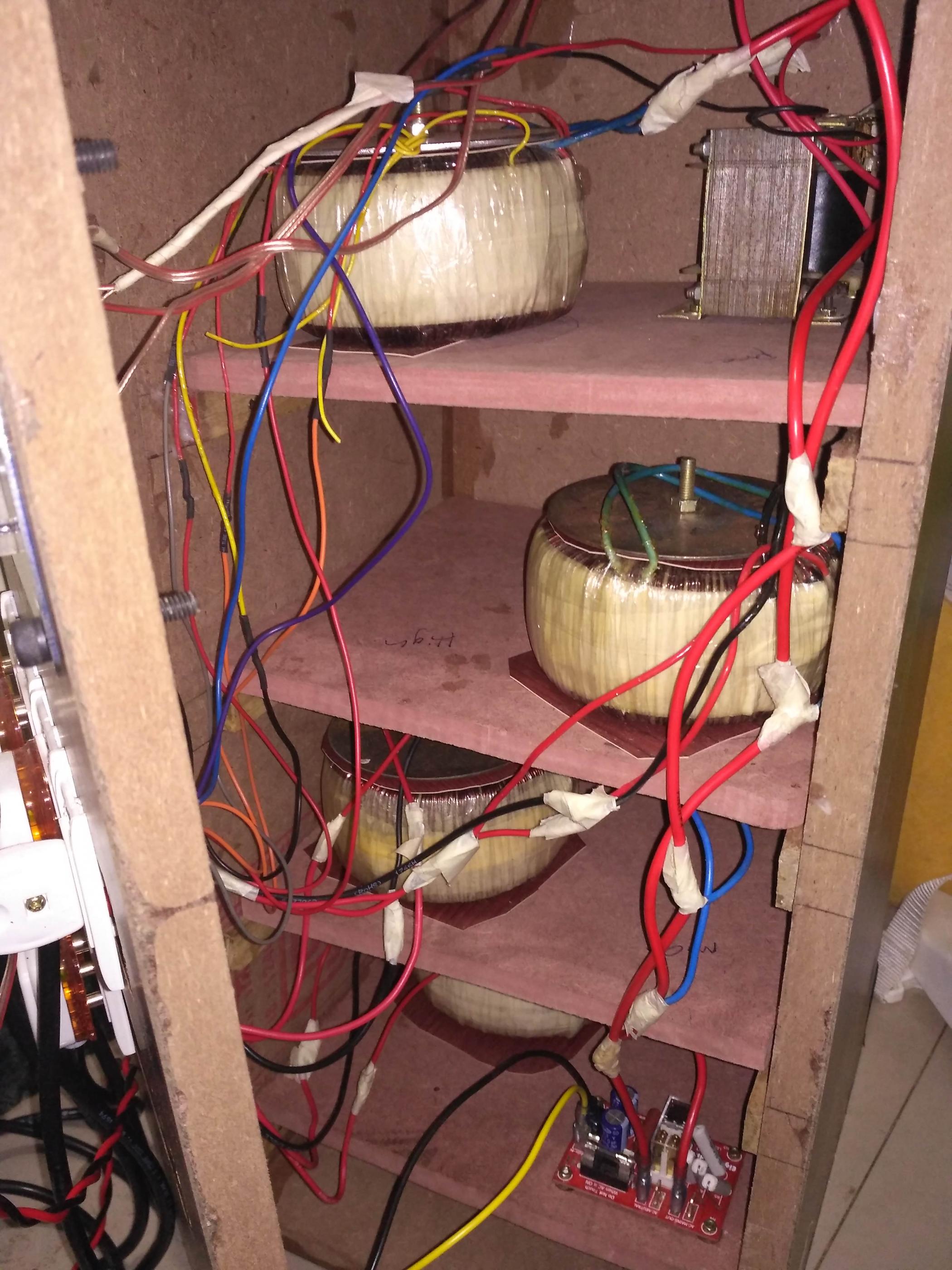

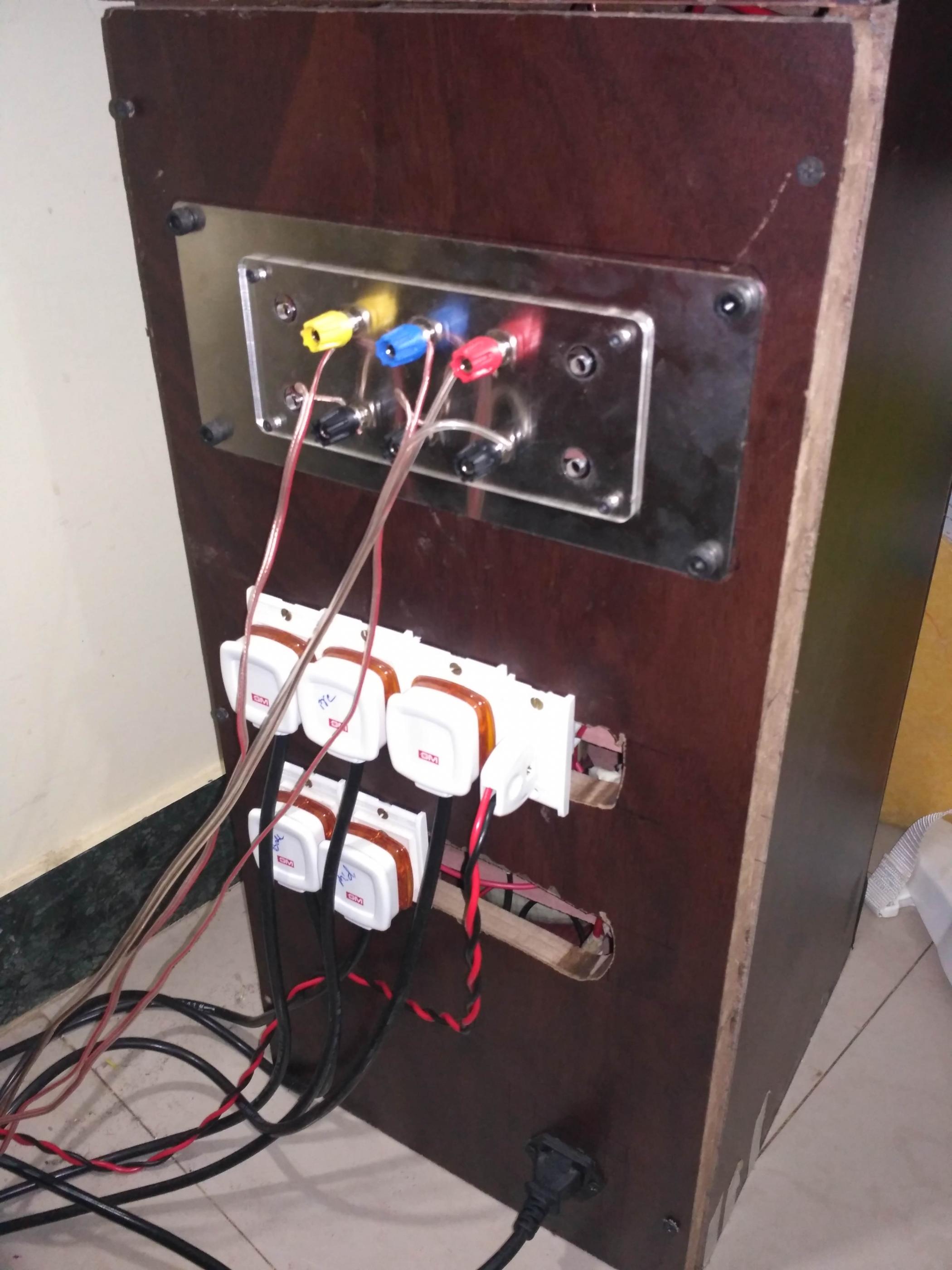

Photos of the setup. I will arrange the cable properly with a cable tie. I thought of doing it after testing it.

Just short the main input. Ideally the inputs should use screened cable, you may possibly get away with them being tightly twisted. All speaker pairs and power cables should be tightly twisted.
Thank you very much for your time and patience Scottjoplin. I am bit new to these and no engineer either . I think I am using screened cable. It has 3 conductors. 2 Insulated with different color plastic and third strands of aluminum surrounding these 2 insulated conductors. I am not using surrounding aluminum for anything .Just short the main input. Ideally the inputs should use screened cable, you may possibly get away with them being tightly twisted. All speaker pairs and power cables should be tightly twisted.

Yes, that's screened twisted pair (STP), how are you connecting the conductors and screen? You should be using coax, one internal conductor for signal flow and screen for signal return (signal ground). You can isolate the inputs with transformers, but it shouldn't be necessary. It's a very ambitious project for somebody new to it 🙂
I am being stupid here😀 . Connected one wire to signal and other to signal ground . Completely cutting off the screen . Will change the cables to coax on next iteration.

Question regarding safety ground in a wooden enclosure like mine. I am planning to connect all the 0V line from PSU to star point and then connect it to ground socket of mains. I need to implement loop breaker circuit in this scenario . I am thinking of 3 alternatives :-
1 )loop breaker (Bridge rectifier , resistor and a capacitor )circuit for each PSU 0V where they join star point .(This, I think will work)
2) only one loop breaker where star point connects to ground terminal of wall socket.
3) Both option 1 &2 .
Which one you guys recommend ? since it is multi channel/ multiple transformer I know it is very complex.(I think I bit off more than I could chew

This would be best.1 )loop breaker (Bridge rectifier , resistor and a capacitor )circuit for each PSU 0V where they join star point .(This, I think will work)
It's possible to have similar problems with a stereo amp, monoblocks solve the problem of cross channel ground loops because they have separate supplies
- Multichannel amplifier internal ground loop
