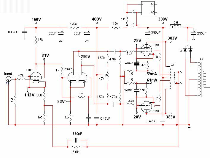

Last Questions
Thanx for the advice on the vol. issue.
Some last questions refering to attached image.
These are final voltage and current values, basically the same for both amps. I just want to confirm that all are exceptable, especially the currents in EL34's.
1)Can I leave the 59mA and 61mA as is, or will it be better to reduce them?
2)I measured Vout over a 8ohm load, with a 100Hz sine wave applied. It started to clip at 35Vpp. This translates to 76W. Does this mean that the amp, can actually deliver 76W max. or do I reason/understand incorrect?
Thanx for all assistance and further suggestions.

Re: Last Questions
The currents seem to be in the right range. My Lowther LL26 amps are similar in design and B+ (though fixed bias) and are 55mA/tube.
35Vpp = 17.5Vpk = 17.5/sqrt 2 = 12.37Vrms
P=V^2/R = (12.37)^2/8 = 19.1W
Cheers

Re: Last Questions
I did understand correct, just did not think correct (basics, basics, basics...)

SINE WAVES ONLY!
The most important thing to remember is that those equations are for sine waves only. You'd be amazed how many people try to apply them to other waveforms...
