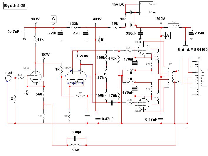

Circuit improvements
After applying the improvements suggested by Mr. Claus Byrith, my amp now look like the following. I can see or hear virtually no noise/ripple. My only questions now are these:
1)Somebody mentioned that the 235uF and 390uF caps are too high for tube amp, why is this so and what are the negative effects of "too high" ?
2)To improve sound, I must bypass big caps with smaller values, what values will be good and what type of caps?
3)How can I calculate or measure currents at points A, B & C ?
Thanx for all advise/suggestions.
Circuit now called "Byrith 4-25" (After his mods. 4 valves, 25Watt)
The negative effects of too much capacitance are:
increased hum in some cases, and large startup currents placing stress on the rectifier, power transformer, and the caps themselves.
Like anything else in life - only use as much as you need to use - more than that is not better. 😉
Joel

Yes, in a capacitor input supply, the ripple current rating of the reservoir capacitor is often the deciding factor, rather than its capacitance. Switch-on surges can be tamed by Negative temperaure Co-efficient (NTC) resistors, and zero-voltage switching relays.

Is this the same as they do to avoid the fuse blowing with big cap.banks iow by placing a thermistor (NTC) - or 2 in serie - on the life of the 230V supply line on the prim. of the transformer?
[Any suggestions on questions 2 and 3? ]

Yes. NTCs and zero-voltage switching relays in the mains path protect the capacitors and rectumfriers (get that in before Frank or John does).
A2 Modern capacitors don't often need bypassing. Choose low ESR types intended fro switched-mode power supplies. Lower inductance ones have longer cans.
A3 (c) Ohm's law on the 47k anode load.
(b) Ohm's law on the 82k cathode resistor.
(c) Ohm's law on each of the 470 ohm cathode resistors, and sum the currents.

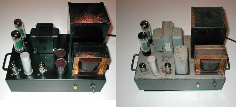

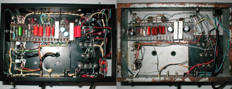

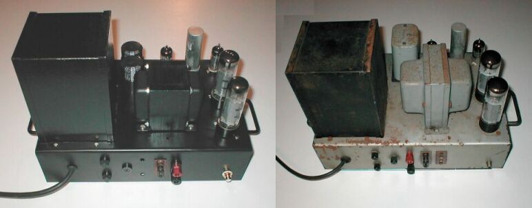

Finished
I eventually got my new OT's today and completed the recon. and mods on those old Mullard 5-20's. I 1st fit the EL34EH for now, will get better 1's later. Although OT's and tubes must 1st burn in (I suppose), the amps sound beautifull. Plenty of the classic tube warmth (what I'hve read and heard about so much), excellent base - full & controlled, clear highs. I just love it. I have very little experience with tube amps, but are very pleased with these 2. Compared to my Aleph30, well .... I am sorry but A30 will have to move over and make space. Only problem is that I use CD player direct with amps, and vol. control are very sensitive.
Is it a good idea to just fit a POT on amp. and turn vol. down with that , or are there a better way?
Here are some before and after pics.
Please comment/suggets on anything.
Wow!
Let me be the first to compliment you on a really pretty job. I'm glad they sound as good as they look. I've just tried PTFE capacitors, and have been very impressed - you might like to change your coupling capacitors to the Soviet 100n 500V PTFE types (if there's room - they're big).
I hope you've shown photographs of your efforts to the chap who sold them to you (so that he knows they went to a good home).

Thanx EC8010, I will definately now slowly begin with improvements. Where do you buy those Soviet caps? I am actually going to the Soviet in August, will look for some there 😉
What's your suggestion on my vol. control problem?
EC8010 said:Let me be the first to compliment you on a really pretty job. I'm glad they sound as good as they look. I've just tried PTFE capacitors, and have been very impressed - you might like to change your coupling capacitors to the Soviet 100n 500V PTFE types (if there's room - they're big).
The teflons can be obtained from:
http://www.anthonywelsh.com/?action...32&PHPSESSID=e7a9ac7a9b3487b8e6a02cd1a30037f1
But I expect that there are other places. Cathode bypass capacitors can be usefully replaced by low-ESR types intended for switched-mode power supplies. Don't be afraid to use a higher voltage type to gain an advantage in ESR.
Your volume control problem is less easily solved. Since you have monoblocks, it makes sense to put each amplifier adjacent to its loudspeaker, and minimise the length of loudspeaker cable. If you only use CD, I suppose you could put it between the loudspeakers, and make a bodgebox containg a 10k volume control.
I loathe and despise line stages, but this is probably a case for one. If you had a cathode follower line stage, you could precede it with a 100k stepped attenuator, and drive the cable from your listening position to the power amplifiers. 6C45 on an EF184 10mA constant current sink makes a very nice cathode follower.
