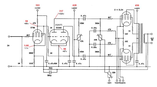

Mullard 5-20 : Episode II - Return of the trafo's
Just over 2 years ago I started this project and thread. At that time I eventually got them working but not to the specs of the Claus Byrith re-design (which was my final goal).
I now got the correct transformer and chokes and re-build them again, also using matched Svetlana El34's , Auricaps and Riken Ohm carbon resistors (looks and sounds beautifull - those Rikens 😉 )
Accordng to Mr. Byriths design notes, you should get certain vlotages at certain points. Although I had the HT transformer made according to spec. , I get a little more out of it - HT.
My measured values differ now from the specified values, and I want to know if I must adjust resistors, or are my values acceptable? I also did order the Morgan Jones 3rd edition on Valve Amplifiers, so should be able to answer these questions myself within the next month or two
After these "expensive" mods. I must say, it was worth every $. Get almost 40W out of each, sound improved on all areas, bass, clarity, soundstage, imaging - just wonderfull, also virtually no humm : 1.4mV on scope.
Measurements:

Hi JdeV,
Congrats on your "remake"! It is fun doing this. My 5-20s all use the Byrith front end (I did not require all the gain that the EF86 offered in pentode mode) but I still use Cathode Bias. At some time in the future, I might - or might not - fit a separate Bias transformer for the output valves, as my original Mains transformers don't have a suitable tapping for this.
Your voltages are not too far out of spec, in fact they are pretty good. However, there are a copuple of points you can look at:
Check the voltage of your AC supply. We used to have a nominal 220V supply here, but this has been upped to 240V to confirm with EC standards. I have on occasion measured 247VAC mains, which is a bit high for my liking. Move the Mains Input of your transformer to a 250v tap (if you have one) and see how this affects your HT. The difference it might have on your LT filament windings is negligible.
If your voltages are still high, insert a wire-wound resistor between each secondary tapping of your HT transformer windings and the rectifier. You can work out the value by taking the nominal current value and applying Ohm's Law, but it probably would not be more than 100 ohms or so. Remember to allow for a suitable wattage, those resistors can get hot!

Re: Mullard 5-20 : Episode II - Return of the trafo's
After rolling some tubes today, I noticed with some of the older tubes, (for EF86), the voltages are spot on - as specified. So with time the new tubes I am currently using will also give the same voltages.

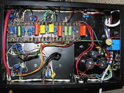

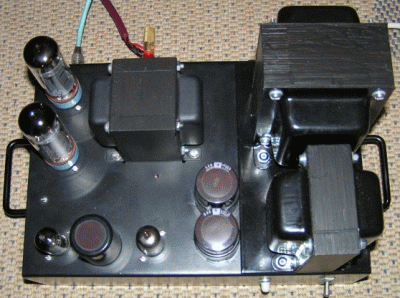

Just for the fun, a pic or 2:
Introducing..... the all new super duper Mullard designed, Byrith modified.... EL34 35W monoblock. 😎
