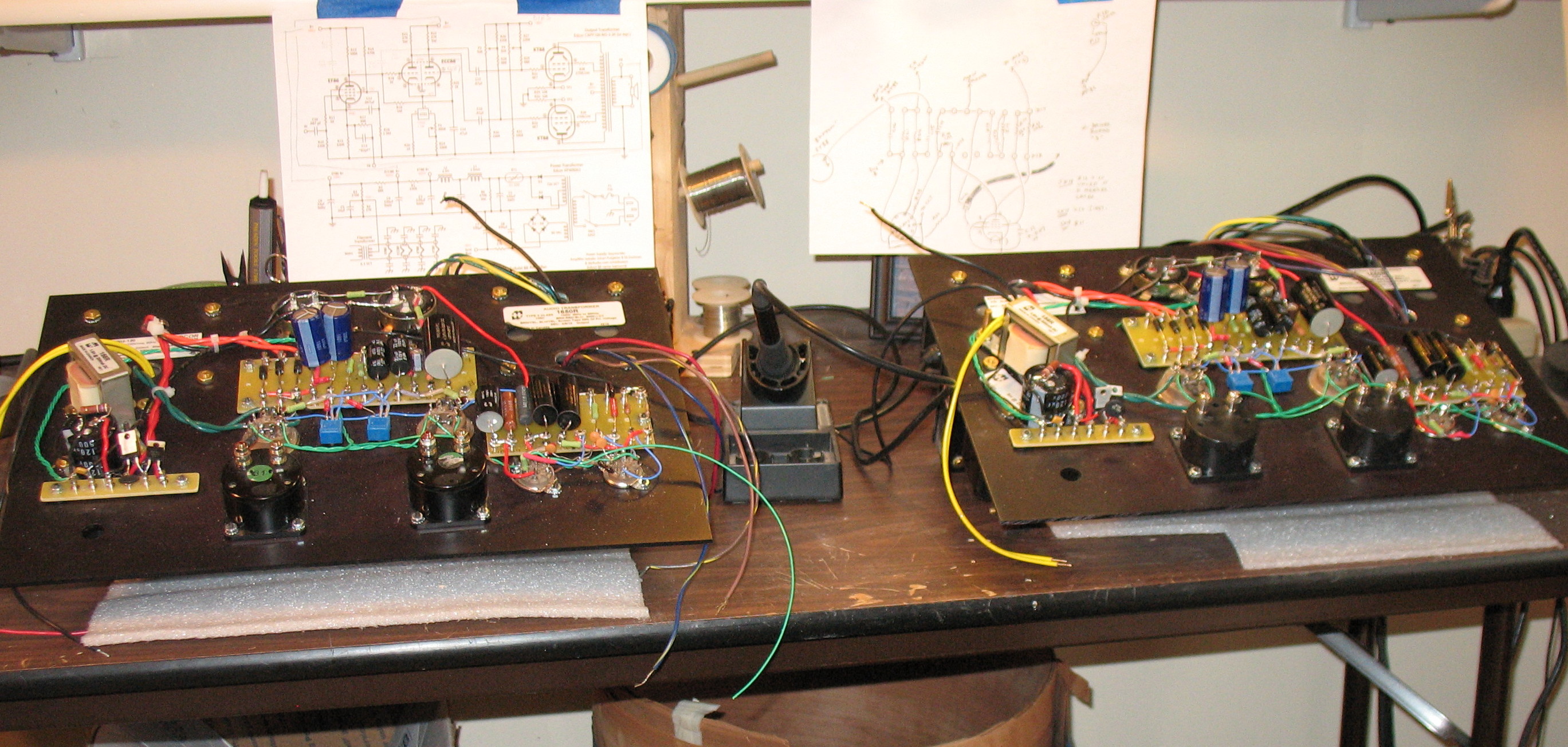

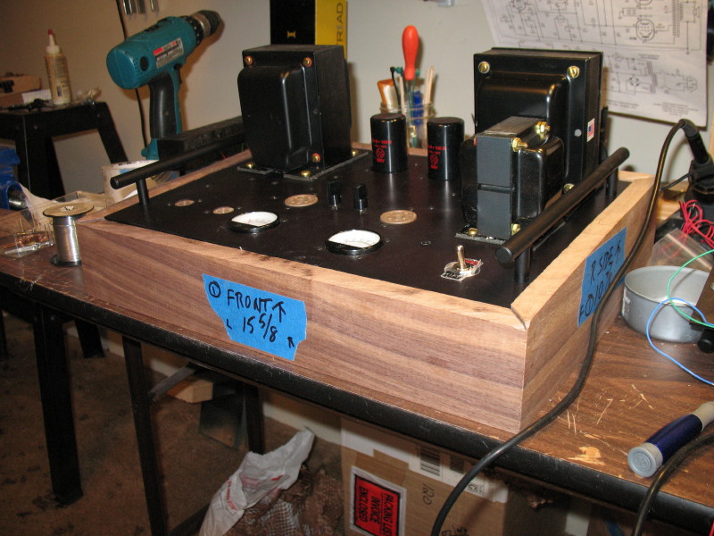

After dozens of e-mails that Steve Brown patiently answered, the two chassis are wired up (minus the CCSs) and ready to go in the bases.

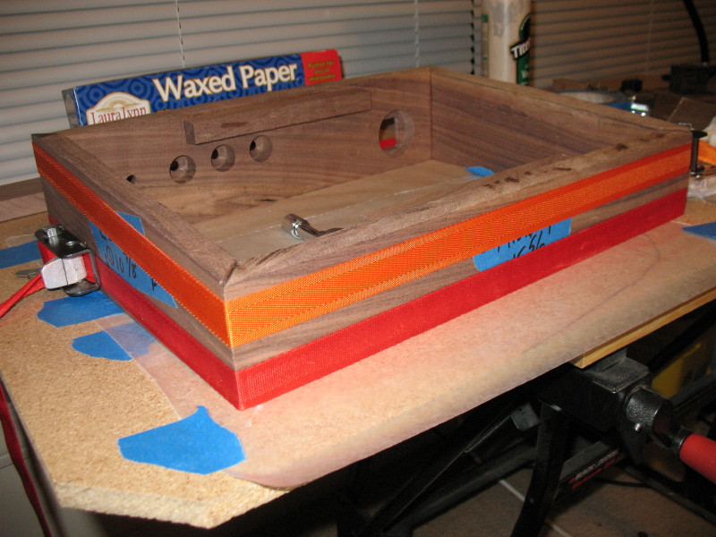

Got one base glued up and ready to trim after making certain it fit.
Seeing daylight and getting excited after only 2 years of gestation!

After three years of learning, blundering, stops, starts, surgeries and finally a 3000 mile trek to the home of my pal Steve Brown, my Soloist 88s a la Steve are playing.
There were issues with the crummy quality control of Edcor over the 40 volts, not 60 of the bias supply. The outrageously high gain due to omitting NFB was cured by triode wiring the EF86 and padding the input with 275k resistors. Steve also recommended Mundorf MCap Supremes for the .47s. He also performed a few other tweaks simplifying the bias supply.
We are listening to the Saint-Saens Organ Symphony and loving the power of the bass with the room vibrating from the pedal tones but still having beautiful tone from the violins and wood winds. Hearing the sweetness of Alison Krause voice a little later shows the finesse possible from this circuit, the Hammond 1690 OPTs and the Gold Lion KT 88s.
Steve had built a pair back when the thread was current but wound up converting them, not that impressed, to 300Bs. Hearing these amps with the changes he made, Steve is seriously considering building them again, they sound that good. I would put the quality of sound up against any of the KR Audio amps, several of which I have had at home for extended periods.
They're are so many competing designs here and all with their proponents. The Soloist 88s deserve a place near the top of what the DiY'r should build in this category.
