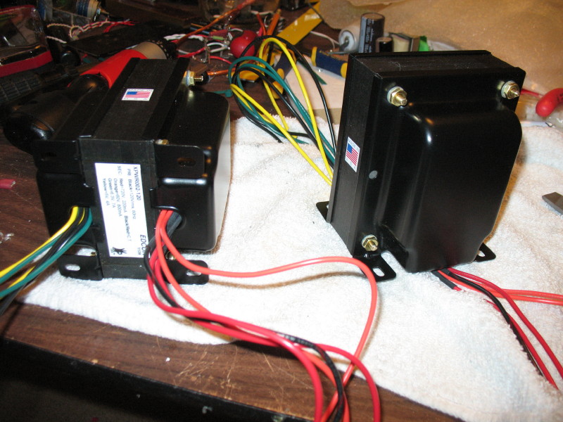

One question for you guys. I have two James 5k 6255HF 50W output transformers. Would these work for this build or are they to small? I was going to put them in my current amp, but this thread got me thinking.
Unfortunately, the James trafos are too small for use with a KT88 Mullard setup. Remember, the O/P trafo is inside a GNFB loop and magnetic headroom is essential. You could use Mullard style circuitry with your "iron" in combination with EL34 family tubes. The yield would be approx. 35 WPC.

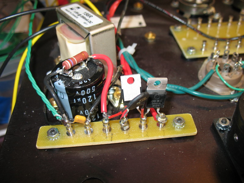

I'm extremely green when it comes to "point to point" wiring, and I'm having trouble laying out the HT supply. My last amp used a "Cap board" so I was cheating. MY issue with this amp layout is that I seem to want to lay it out just as it is drawn, which i'm sure is the wrong route to take. I just lack solid experience! I've never even really seen what one even looks like other than on a PC board Any chance some of you seasoned builders might be able to roughly sketch out the Supply out in a efficient, but easily doable layout? Something using a few turret, or terminal strips, or what ever?
Can anyone help me get going with this creative part. If I had a basic starting point, I think I could run with it, and alter to my specific needs with this chassis.....

Can I suggest using paper cartoons. Cut out pcs of paper the size of components and then place them in a frame the size of your space. I did it with CAD as I was use to using it. Paper works just as well though.
