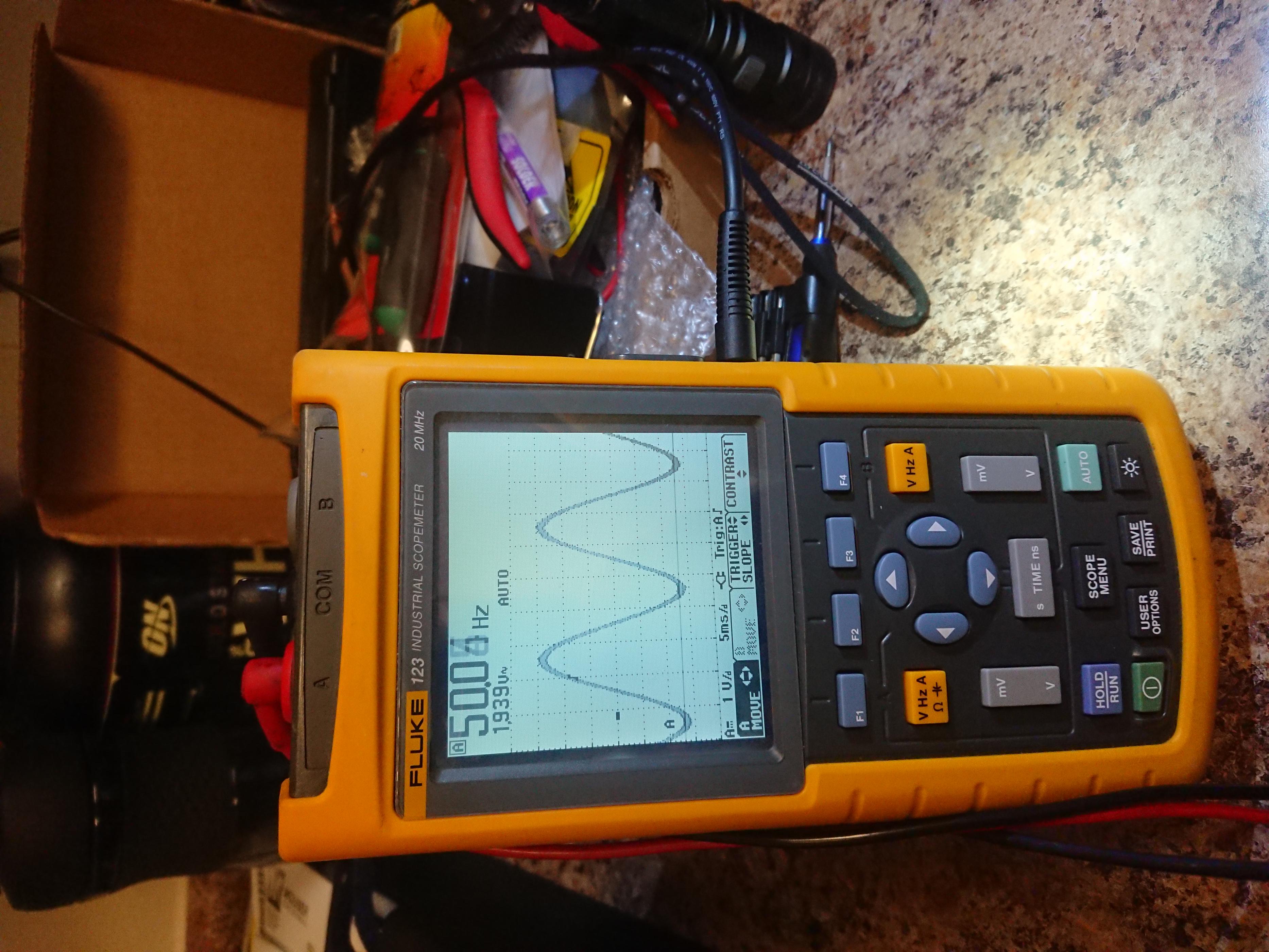

Mtx ta92001 distorted output.
+0.009 volt this is a 50hz test tone. by the RCA input

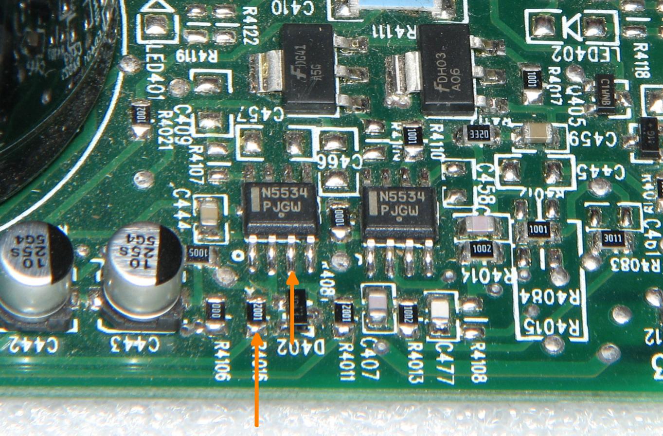

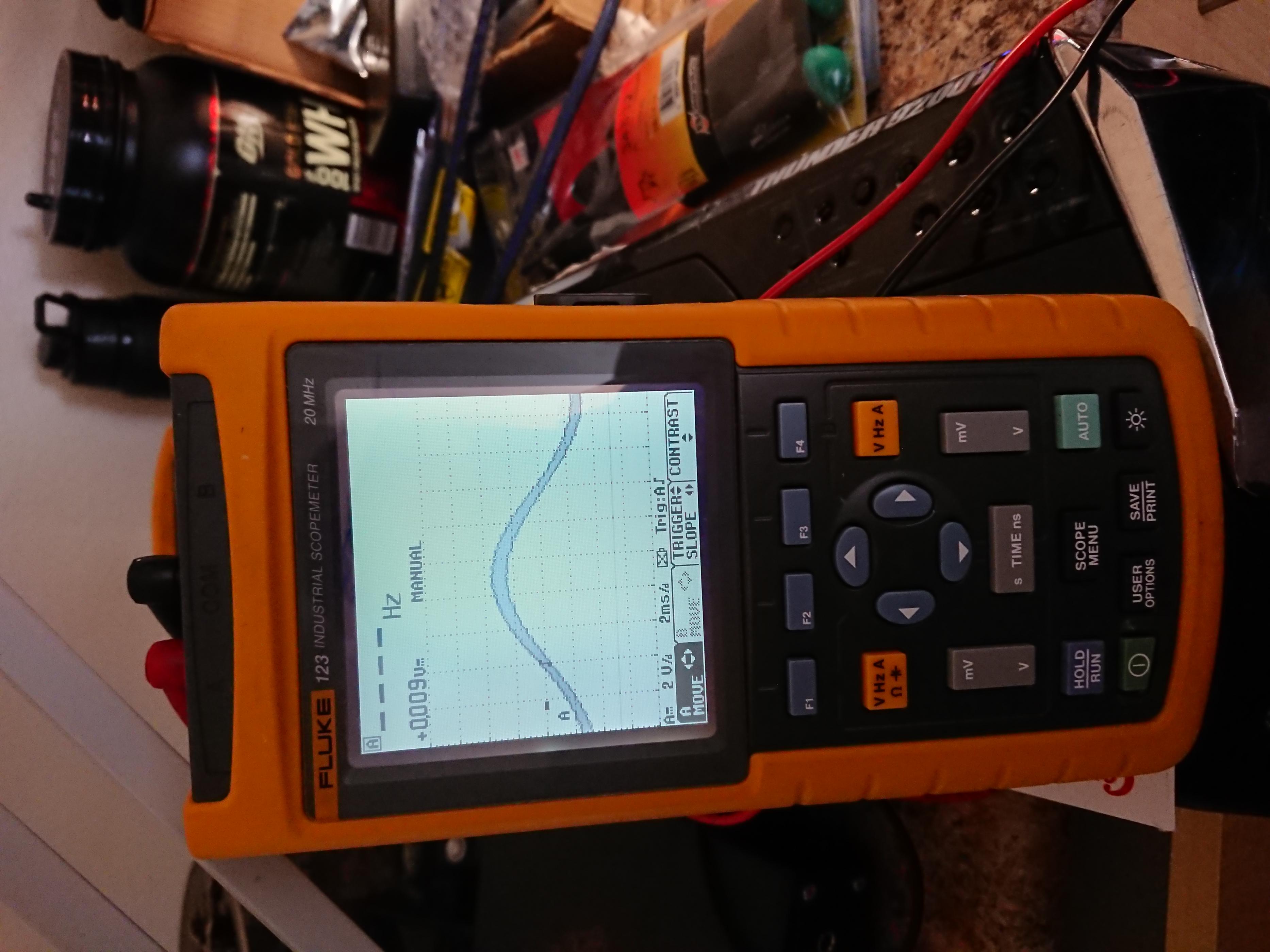

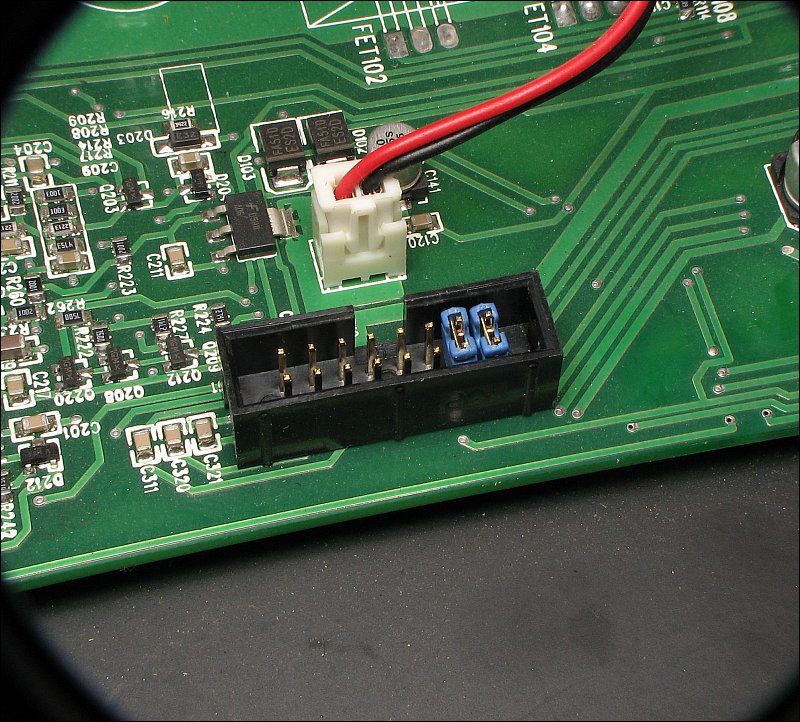

I removed R4011 resistor. I have 50hz test tone on the resistor pad comeing from the header. The other side of the resistor pad going to pin 3 of the op-amp I do not have 50hz. I check to make shore the Trace comeing from pin 3 to the resistor r4011 is not damaged by setting the meter to continuity. It checks out good. Does this mean resistor R4011 is bad?
