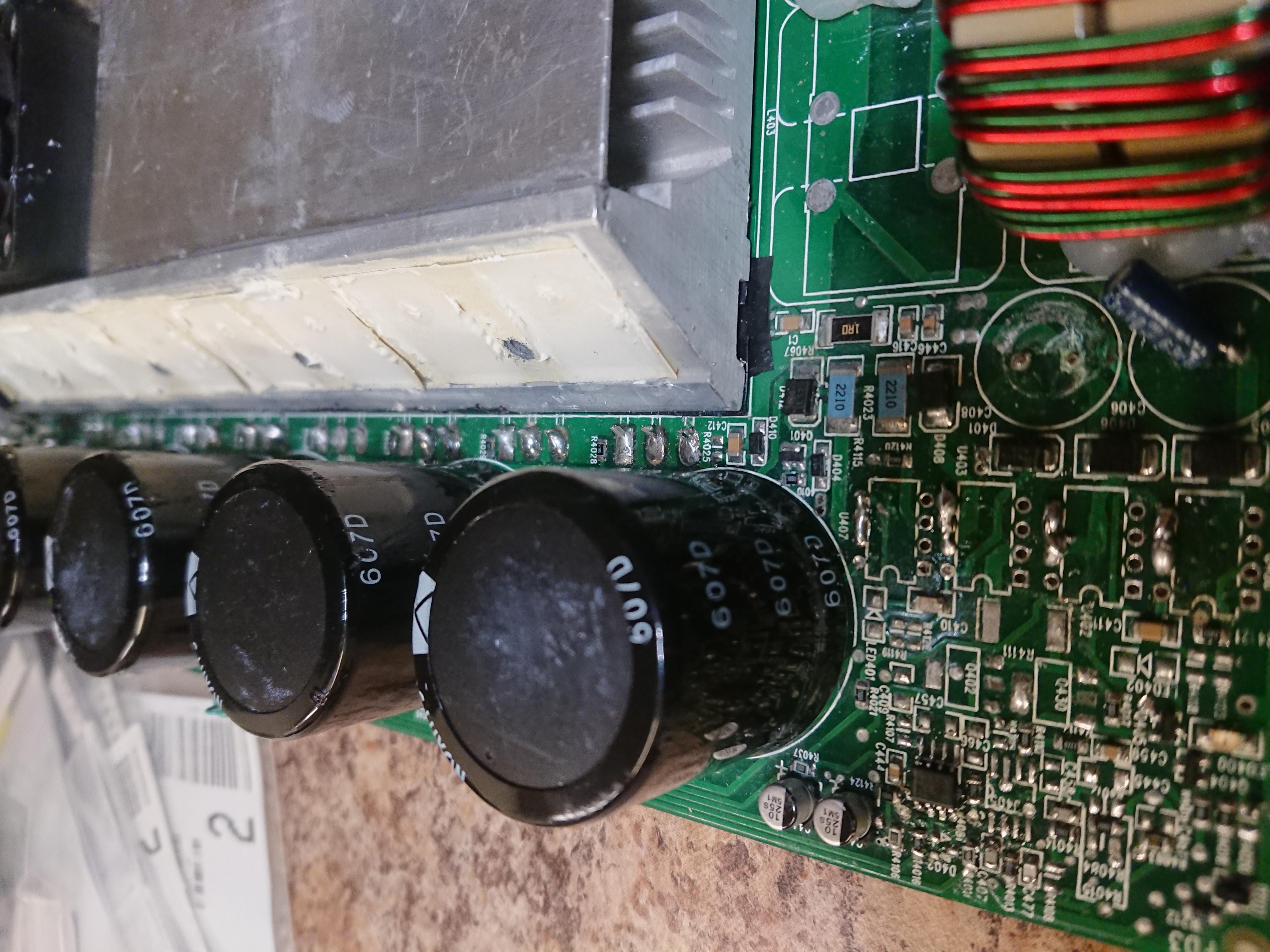

I haven't yet. I was tracing the Trace from the large resistor to see where the 22 volts is coming from. Be for the large resistor I geting 108 DC volt. After the resistor. I'm getting 22 volts. The same volt at the speaker terminal. After the large resistor it goes to the pin of the op-couplers
No. When I connect a speaker to push all the way out. What would cause my rail voltage to be uneven between negative and positive rail voltage.

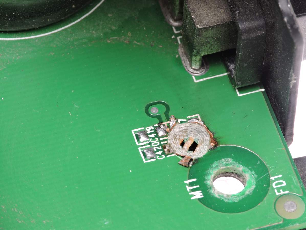

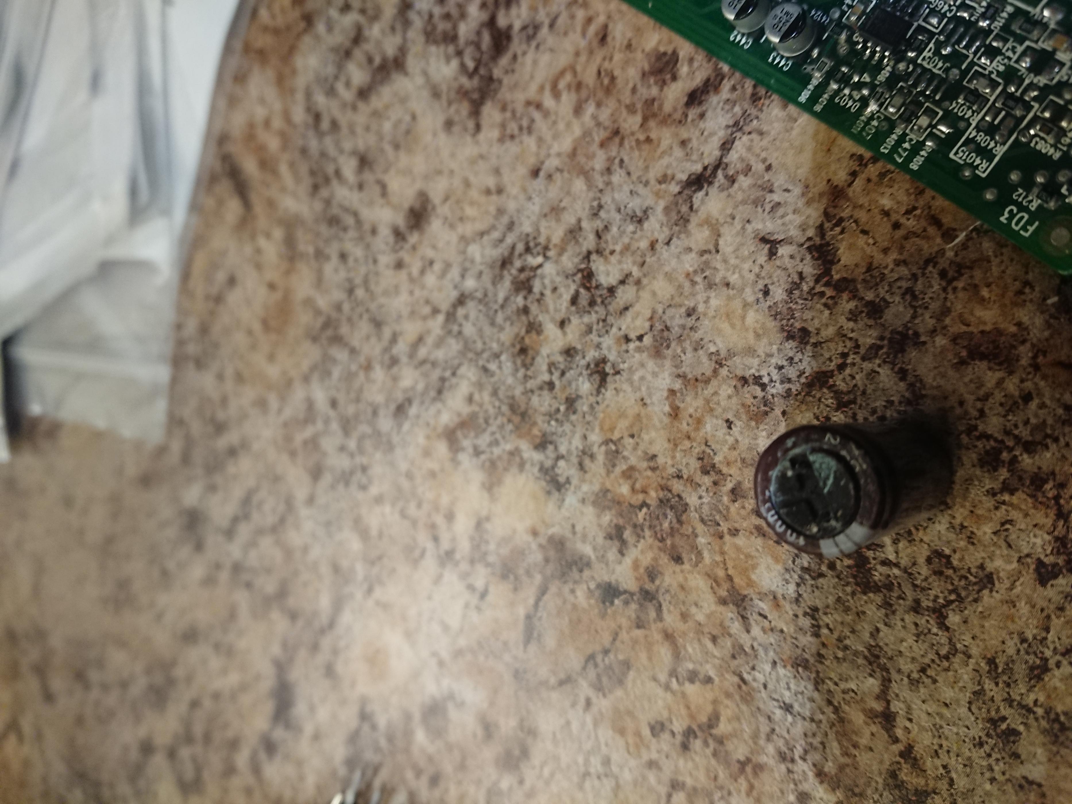

Yes. I was tracing the voltage leak.I remove the capacitor by the inductors and this is what I found underneath it
The collector of the PZTA56 goes to the negative low-voltage power supply. It's the same supply that feeds the op-amps.
are both Transistors this part number [PZTA56]?
I have fought these components to be fail.

Does anybody know where does pin 1 of the N5534 go? one closest to the rail caps . The pad lift it up.
