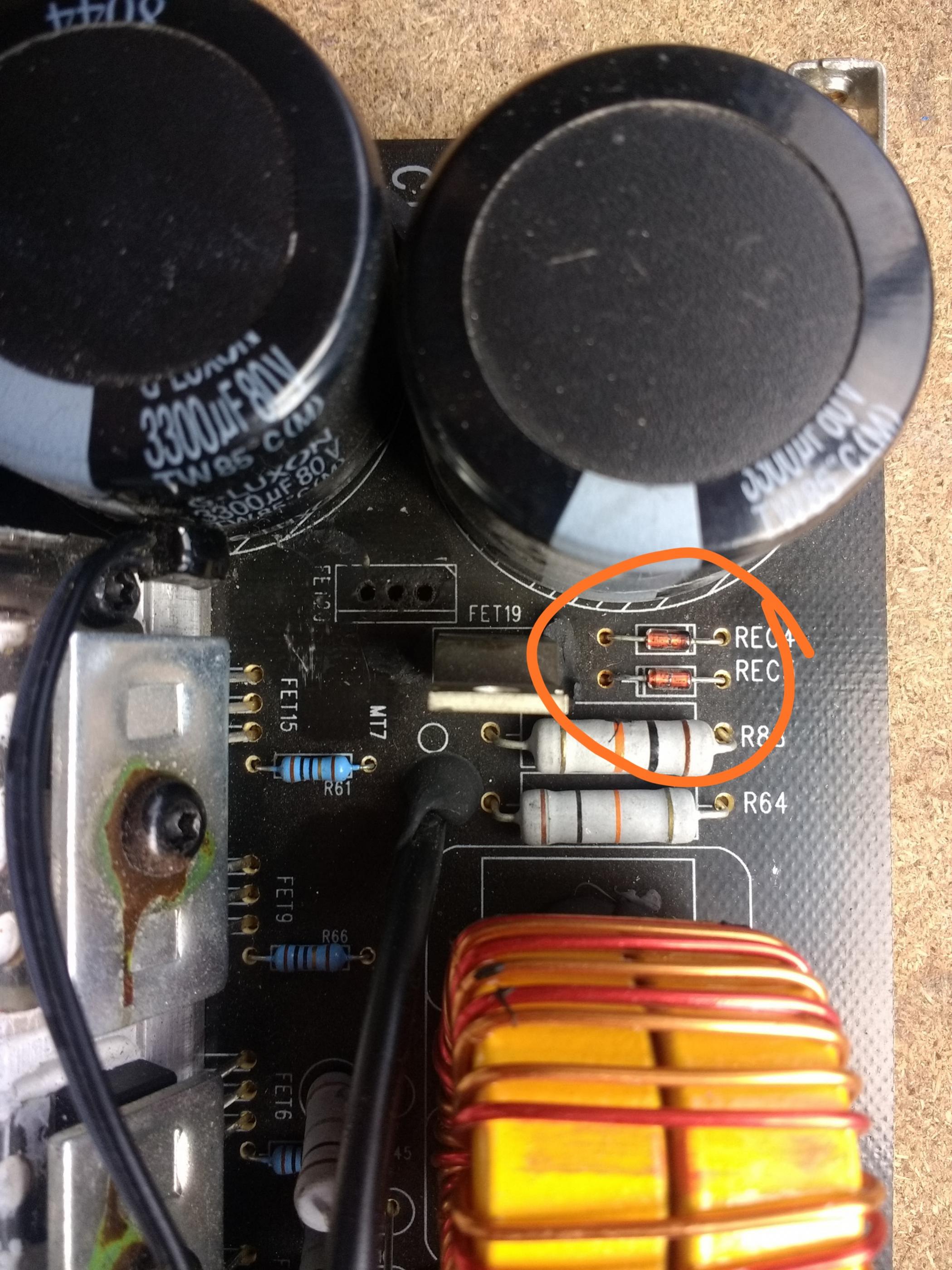

Good evening. Please help me with the repair of Mtx jh12000. He came to me without many complete sets and I am trying to restore them. Can anyone know what resistors should be in the allocated places? And another problem is + -15v. put new lm317 lm337 but they heat up even without load, 70 volts come to their input after tip29 tip30 ..

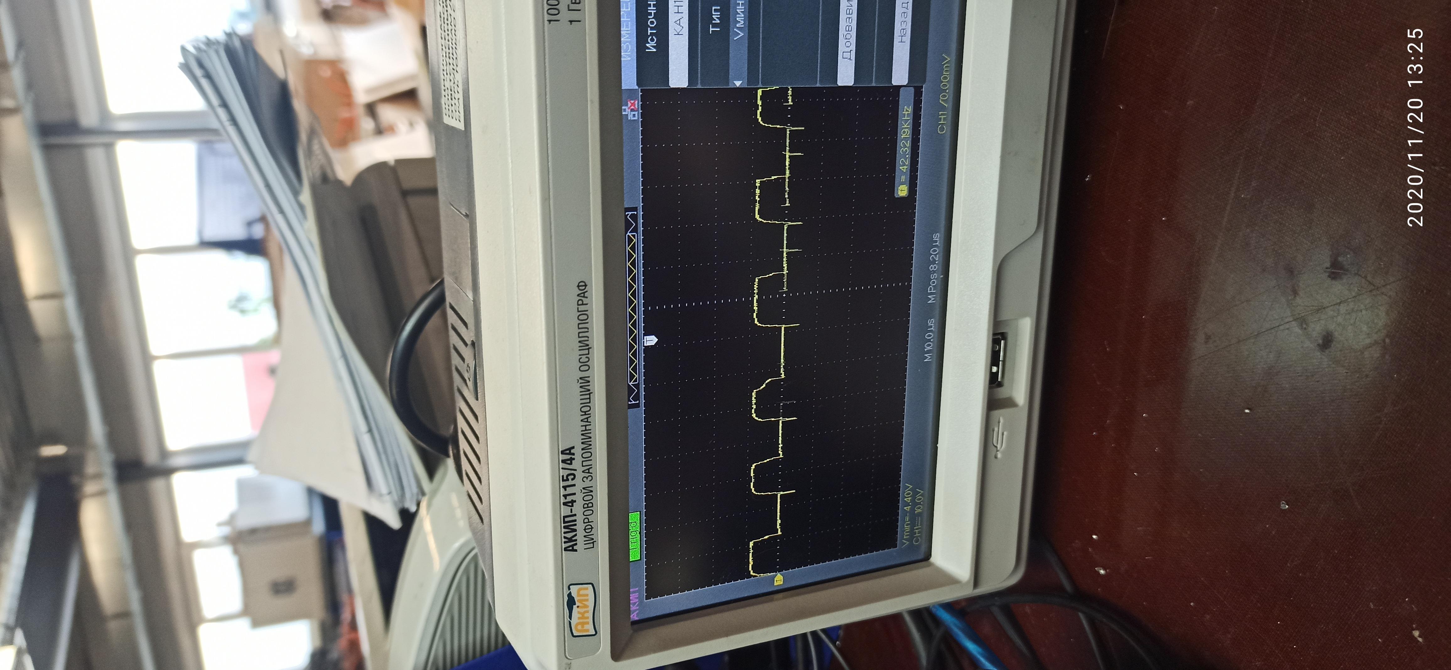

Tip29c and Tip30c I replaced with bd911 bd912 Did I do it right? I could not buy original spare parts in our city. I also attached a photo of the pulse on the shutters of the power supply, is everything good there? Thanks in advance to everyone who responds ...

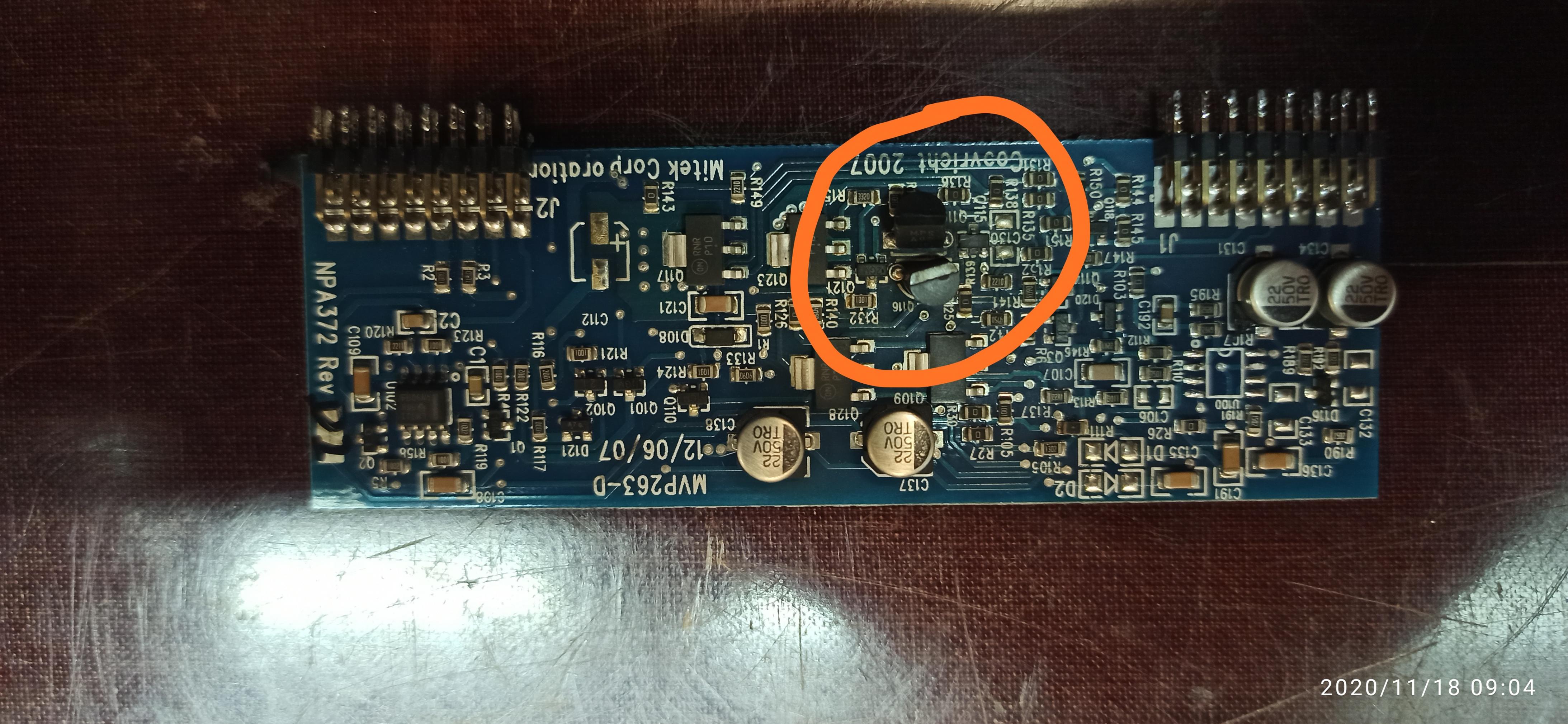

I installed new operational amplifiers tl074 tl072, a sound appeared and after 5 seconds everything burned out .... I evaporated them .. as I understand it, these + -15 are needed to power them ... but even without them lm337 and lm317 are hot .. Tomorrow I will take a photo ... Maybe there is a circuit of this amplifier? are the resistors between the base and the collector on bd911 and bd912 correct? I was embarrassed that one had 3.32 Kom and the other had 12Kom
R4 is a 100 ohm. Marked 1000.

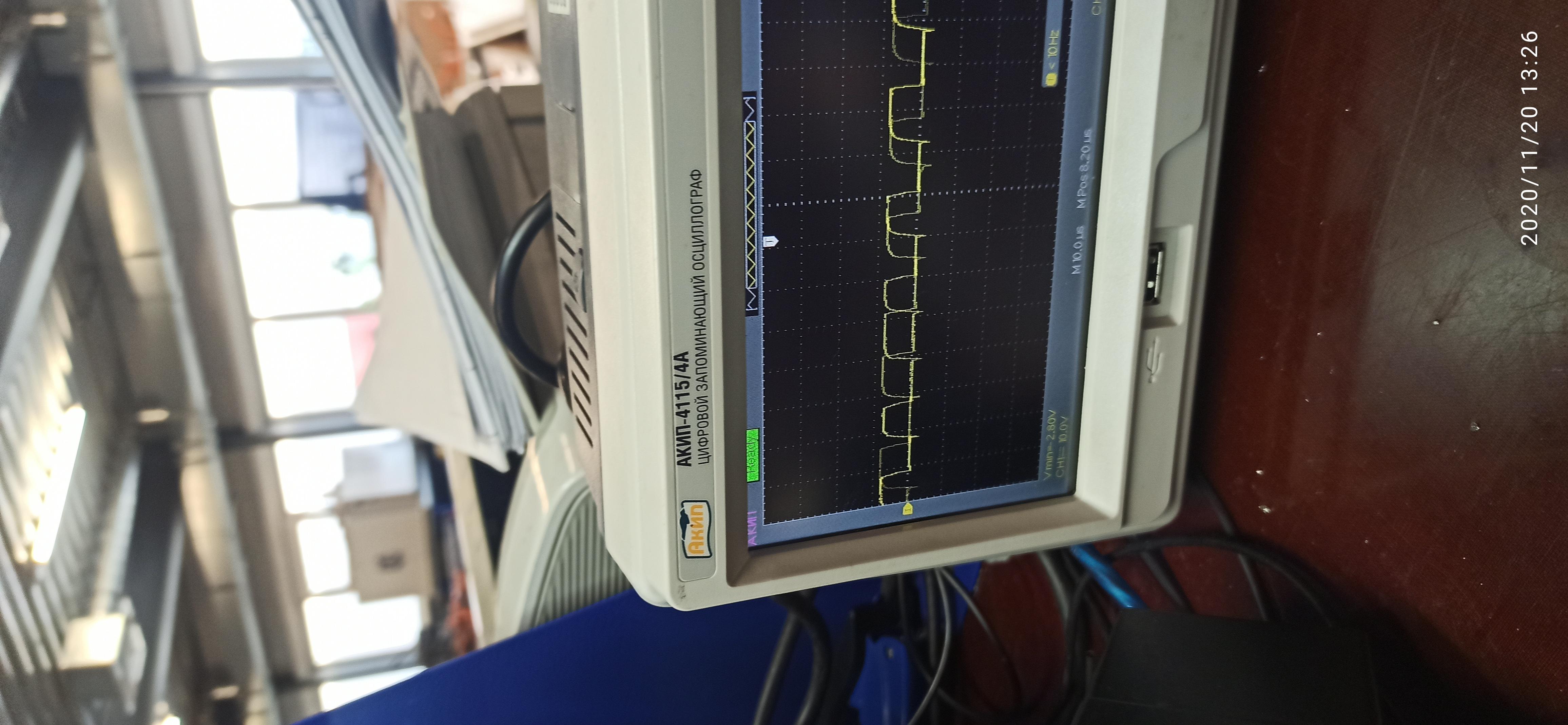

shoulder good work now +-70v
+-15v normal
my problem now very hot q116 q119 This is normal or no ?
Graph out shoulder 1 and out shoulder 2 bad...

Just probed tip29c .... After removing tip29c tip30c lm317 lm337, the cooler started to rotate as expected. The volume level and heating of the thermistor with a soldering iron did not give a result. Maybe there should be zener diodes instead of diodes?
