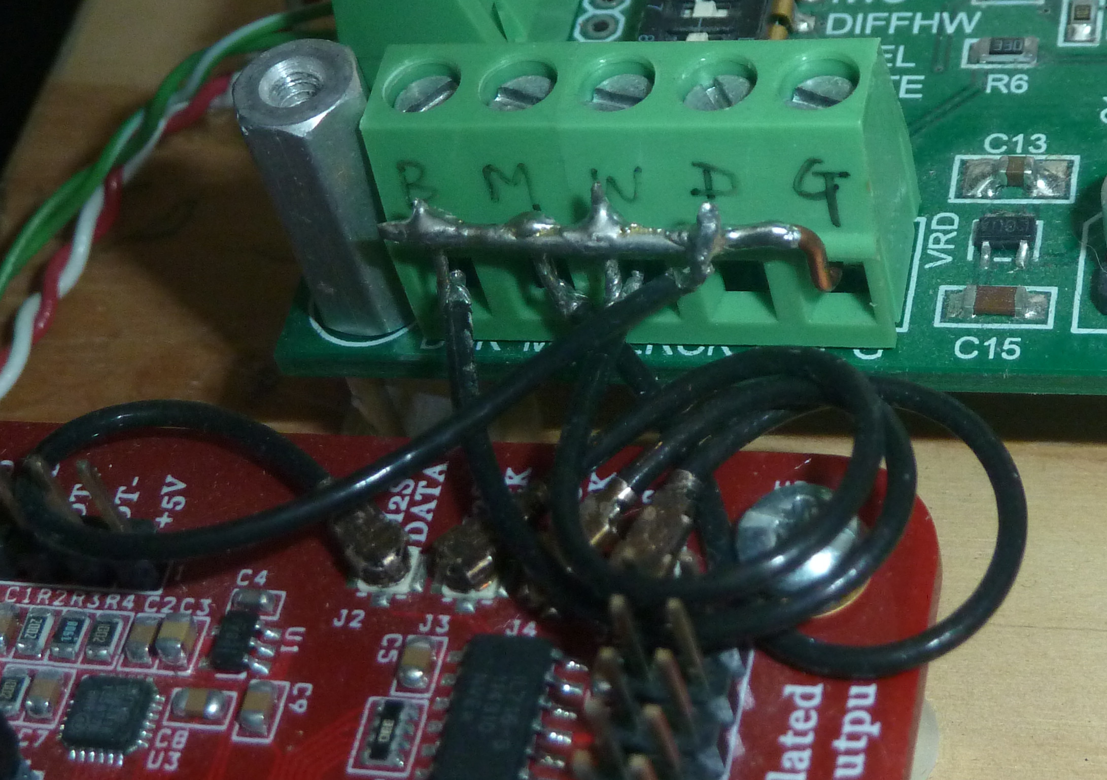

I notice some people are running an Opus with a WaveIO USB to i2s receiver. Are you able to play all sampling rates?
I've tried two boards now, and a variety of debugging, but cannot seem to get the two devices to co-operate at any sampling frequency - all I can hear is clicks and noise. Used a scope to check the lines and there is quite a bit of ringing. Much more so than the DDDAC 1543 MK II i2S outputs. Can't seem to work out what the issue is.
I have not tried removing the screw terminal blocks from the Opus to see if that improves matters. Cabling is as short as it can be to stack the boards, so should not be an issue.
Any comments appreciated!
Absolutely. I use not isolated output with short cable (~50mm) of equal length. Different length cables caused some problems to my setup in the past (distortion and clicks).
