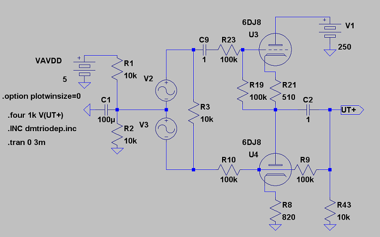

Why on earth would you put a capacitor after WM8741
Remember the DAC has differental outputs! You must do a conversion from balanced to unbalanced and this will not be possible without either active elements(sand or tubes) and/or transformers.
Unless you go balanced from source to loudspeaker.......... But then you need two caps 😉 !
revintage said:Unless you go balanced from source to loudspeaker.......... But then you need two caps 😉 ! [/B]
That depends on the diff input of the next stage. Some are quite capable of dealing with the offset.
What diff input😉 ?
In my small world diff input is not the usual stuff but off course you are right. The same goes for amps equipped with input caps.
With the "right" diff input that can handle +2,5V DC you could skip the caps all together. But I doubt there are amps that really like it🙂 .
This is another way to use a double-triode and two caps( good PIOs or anything equal) to get an unbalanced out. And YES it has got lots of NFB.
But I think I am in the wrong territory proposing tube circuits
You are not in the wrong territory but the solution you propose is way too complicated for a DAC that does not need any electronics at the output. You can hook it up without transformer or added electronics.
However, i can understand why you would want this. I made this stage but have no been able to find time to test it.

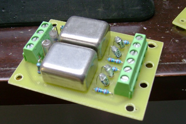

Hi Jean-Paul,
The DAC must be followed by either active elements or transformer if wanting to go unbalanced and using both + and - outputs.
And only transformer, which is what I like, is not an option due to the DACs required series-resistors if your following amp demands feeding from a low impedance source. This is explained in my post above.
The question is: Are the series-resistors necessary together with a transformer as this only loads the DAC at very low frequencies due to its inductance?
About the CF, it was just a joke. I would never dream of using it.
For testing I just followed datasheet instructions of using 1.65 kOhm at the primary windings ( so 2 resistors ). I just added a Zobel secondary again following the datasheet. I am talking about the datasheet of the transformer ! The DAC wll not complain about the transformer loading it I think. The 1.65 kOhm exceed the minimal specifications of 1 kOhm anyway.
You are right about using it unbalanced: it can not be done with both outputs without added electronics. It can be done using only one output but the output voltage is too low then and the DAC is not performing at its best. I wanted it running passive, that's why I made the transformer bal-unbal stage.

Jean-Paul,
Lets do some guesswork going unbalanced with only transformers. I have not checked the data sheets and do not know the data of your trannys so this is not exact:
With a 1:1 transformer Zout = DACZout 2*50ohm + resistors2*1650+ DCR of primary500 + DCR of secondary500= ca 4k
With a 2:1 it then should then be ca 1,5k.
Still to high in my opinion.
Mmm, compared to most tube stages it is not that bad. I think I can live with that. The simplicity of passive stages ( despite this kind of drawbacks ) wins from colouration of added electronics IMO. This is purely subjective ! I now recall I did try the output stage and it sounded good at first glance. It did not fit well in my too small enclosure. I did make another one with Haufe transformers but I really lack time for hobbying so that one has not been touched for some months.
BTW I have chosen Neutrik NTL1. I could not attach the full datasheet as it is too big in filesize. But Google is your friend, it'll find the datasheet.
If you want to try this: I have a spare PCB and only one NTL1 left. Send me a PM in that case. I still need some unobtainable LM4562....
