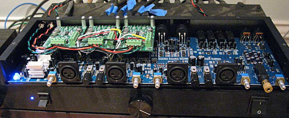

Q: for Brian, Russ, or ?
Hi Guys!
I have been enjoying the Opus boards very much and have a basic question:
I am running the 8741 version in hardware mode. For some recordings I would like to be able to switch from filter #2 to filter #3 using an external switch. ...in other words, change the state of FSEL from "+" to "0". Is this possible using the I/O header? [I presume that '+' on the Opus state switch = 'Z' on the WM8741 data sheet...] Thanks!
Rationale:
I like my music near 'performance levels'.
Unfortunately, my listening room has marginal acoustics (square and not very absorptive) so my powerful midrange speakers can easily produce harshness when recordings include significant overtones. With the Opus, the recordings that tend to be strident (and high SPL in general) are more enjoyable using filter #3 (hardware mode: OSR = '+', FSEL = '0'). However, sweeter, better (and quieter) recordings are much more life-like using filter #2 (OSR and FSEL = '+'). For example, using filter #2 saxophones
seem absolutely live and fine acoustic instruments
have much more genuine timbre. It would be sweet to toggle the DAC filter depending on the recording quality and/or desired volume. I would normally glue egg cartons to the ceiling and walls but for reasons I don't understand my wife objects to that solution!
Frank

Hi Frank,
Yes that is precisely what that header is for. 🙂
Just keep in mind you will need to Cycle the power to the DAC for the change to take effect.
You will need to pull the pins high are low using an external switch or some other mechanism.
I would suggest a pull-up resistor and a switch which closes to GND.
You will then leave the on-board switch open for that position.
Cheers!
Russ
Cheers!
Russ

Russ, you're so generous with your time! I apologize... , I am very naive in this arena plus I suspect a typo above. To confirm, let me rewind and play this back: Is it the case that a pin = "Z" when it is power cycled as neither high nor low? Then, I see that the pins are shorted to ground at dip switch position '1'. Is that situation considered 'high'? ...meaning that dip switch position '0' is low? (
Cheers!
Frank
PS. application in computer sound board shown in attachment - boards are stuffed into a 1U rack box...

Hi Frank,
My mistake. I forgot that the pins are 3 state. Sorry for the confusion.
You would essentially need to mimic what the on-board switch does.
Basically the "-" (It looks like a 1) pulls the pin to GND.
"O(as in Oscar)" leaves it open.
"+" pulls it to VDD (3.3V).
What I would do is use a 3 state switch. One end would be high(VDD), middle open, other end low(GND).
You don't need a resistor at all in this case, but I would probably use a 1K resistor on the high side out of an abundance of caution, in case you accidentally have a short through the switch .
Cheers!
Russ

OK, I opened up the chassis and tinkered some more and I have two items to report.
1. Those Wolfson 8741 chips just want to play! I had mistakenly configured them in serial control mode, but they were still working well. I re-configured them to hardware mode and learned that they will play 44.1kHz I2S regardless of the oversampling rate setting. The SQ is indeed inferior if the OSR setting does not match the source. Interestingly, whatever the defaults are for 2 wire serial mode, that sound was almost as good as hardware mode with the best filter.
2. My favorite filter:
Source material is ALAC files in foobar 9.4.X with DSP crossover, room correction, and kernel streaming. (ASIO is incompatible with some DSP plugins) The Opus DACs are directly connected (no caps) to TXO balanced amps driving home-brew JBL Pro speakers.
The filter choices in hardware at 44.1 kHz are numbers 1, 4 and 5. In my system, staging and detail were best with filter number 1. I hear this particularly in choral music and well-recorded live performances. Well-recorded percussion is strikingly realistic. Also, I agree with Russ that the clipping control really helps with some recordings so I have that enabled as well. One of my 'evaluation' tracks is Diana Krall singing 'the look of love', because there are some clean but very 'hot' vocal highlights. The clipping filter helps control them without ruining the brightness.
FYI, my switch settings for 44.1 material are as follows:
....l..O..+
1 |......X|
2 |X......|
3 |...X...|
4 |X......|
5 |......X|
6 |X......|
7 |X......|
8 |......X|
9 |X......|
When I get around to testing 88.2 or other higher sample rate I2S, I'll report back with a comparison and my favorite filter for that material.
Best,
Frank in Mpls.
Opus testing: software oversampling
To complete the Opus testing at oversampling frequencies I had to remove the software DRC from the signal path (for compatibility). I'm not sure of the reason, but my woofers are playing flatter now than before the Opus upgrade. I have no idea whether the WM8741 is responsible, but now bass sounds better un-filtered even though one cancellation effect is still evident in the scans.
I tested 88.2 and 176.4kHz up-sampled in software from 44.1 music. I felt that regardless of the filter, 88.2 was not as clean as 44.1 running filter #1. Best of all, however, was 176.4kHz where both filters #2 and #3 sounded quite good. Filter #2 is less 'damped' and offers noticably more brightness, space and timbre. Filter #3 produces less detail and poorer staging, but I never heard even the slightest sibillance - even from over-saturated jazz flute. Filter #2 is my fave. For difficult recordings (read: nasty - like grand opera recorded in some opera houses) I will switch to filter #3. The oversampling clearly reduces the 'fatigue' factor and that translates to better dynamics and a more powerful presentation. [The bass from the WM8741 is ear-opening, and in my system is being achieved using simple TXO monoblock amps
driving JBL 2235H's.]
Again, considering what one would spend configuring the 'trendiest' stereo DACs for 6 channels plus I/V, the Opus seems like an unbeatable bargain. ...Perfect for those like me whose DIY objectives include 'frugal-audio'! Again, nice work and thanks to Brian and Russ!!!
Frank in Mpls.
P.S. Here are my favorite oversampled dip-switch settings:

Hi Frank,
Its very cool to see you getting so much use out of the Opus. 🙂
Bravo!
It seems you have also found the same nice synergy I have between the TXO (and to an even greater extent Sympatico) and balanced DACs. 🙂
Running your gear fully balanced results in better dynamic range, which is why I think I will probably never have a single ended power amp again. 🙂
Cheers!
Russ
Bravo!
Cheers!
Russ
