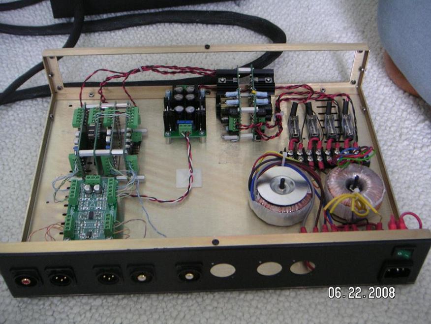

OTTO voltage source
I only have the LCPS (which is set to 7.5v for dual dac etc). How can I get a source of 5v for the OTTO. Do I need to build a 5v power supply. Can I power it from the LCPS? How?

Re: OTTO voltage source
7.5V won't harm the OTTO. It should be fine. It would also be OK for the Opus to turn that voltage down to about 6.5V which would be very safe.

I used these with the WM8740/41:
Available here:
SKpre
They are discrete, class A opamps with on board discrete regulators/PSUs. They can easily be configured for balanced operation, and sound very good indeed, although it's impossible to gaurantee they will beat the LM4562s.
I'd also recommend supplying the clock on the Metronome with a dedicated low noise reg such as can be bought from Tentlabs, NewClassD or similar.

Spartacus, I've thought about providing the clock with its own reg several times. Do you supply a different reg to the whole Metronome board, or do you pipe the power from a separate reg straight to the clock?

freak,
The metronome has local regs, and if you use the LCDPS it is pre-regged too. 🙂
The clock is connected to the VD local reg.
You would have to cut a trace to separately regulate the clock.

Thanks Russ, that's what I thought. I was wondering if Spartacus had done just that and cut the trace.
In my setup, I used a separate clock altogether fed directly to the Opus DAC, then linked back to the ASRC. This way the clock's earth return won't be modulated by other signals.
Spartacus said:In my setup, I used a separate clock altogether fed directly to the Opus DAC, then linked back to the ASRC. This way the clock's earth return won't be modulated by other signals.
Sure that would work fine, and all you need to do in that case is disable the clock (that's why the "Disable" header is there).
Then you can go hog wild with whatever clock scheme your heart desires. 🙂

Interresting. You could actually use another clock alltogether and connect this directly to the Opus? Which clock inputs would you connect it to really?
The SKpre is really good, and a real easy load for the dac. That's a must if you want to run the Opus without an output stage. Capacitive load should be as light as possible. No long shielded cables and heavy input filters on the following amp.
When I said the WM8740 was noisy, I didn't mean a hissing noise. It's more like an unnatural distortion, which makes it feel unpleasant and tiring during longer listening sessions. And as said, there are no other changes than the chip, so cables, preamp, wiring and everything else is the same. Just changed the Opus board. So unless I had a faulty board, I doubt there were any problems.
