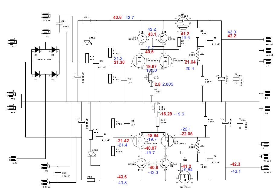

Hi Rick,
That looks like the same voltages I got when I installed KSA/KSC. I would check and make sure you have the correct devices in Q3,4,5&6.

Terry,
FYI, i got PMI's board working.Crappy solder joint..The Single layer board…Beats me. replaced almost everything with same results. He said it had never been tested. It does have a .5v drop across the Pass & ripple is only 1.3 to 1.8 mvac, so maybe i'll just use it as is for a test bed.
