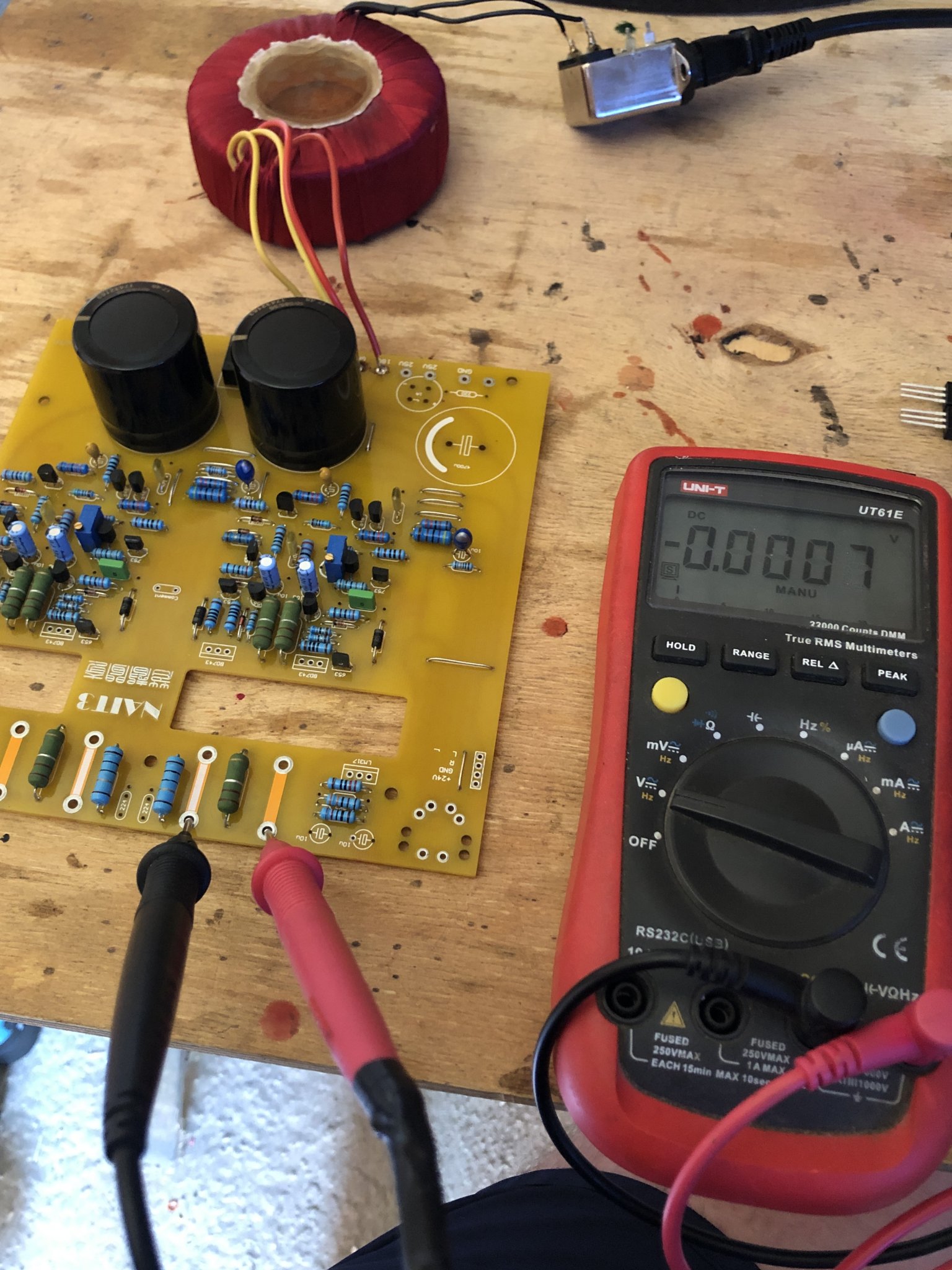

Nait 3 on China Ali pcb
Without output transistors Vout on photo in attachment

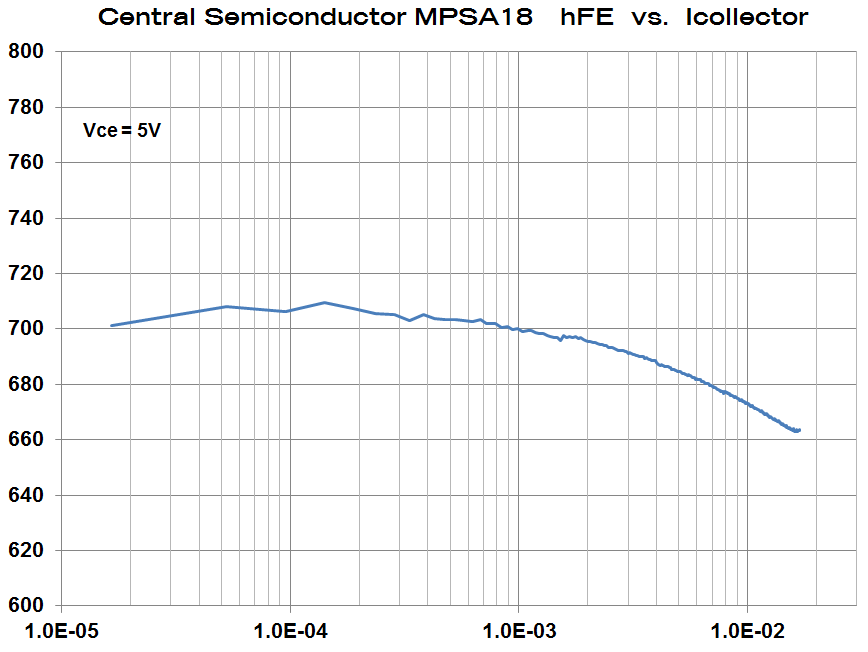

Central Semiconductor of Happague, New York manufactures brand new MPSA18 transistors and sells them through Mouser.com , DigiKey.com , and other distributors (link). I bought a few and put them on the curve tester to examine their current gain Beta , also called hFE . My measured results are attached; I am pleased with the current-production Central MPSA18!
