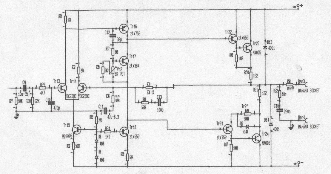

here is a schematic of a naim nap90 from somewhere in the forum,Strange coincidence. I have been hunting for the details of NAP90 for several hours now, because it still has such a good rap. and is quite expensive for a basic, old 30W amp. Thanks, for the advice. Do you have any schematic(s) or references to them, maybe a PCB you used, which would near enough detail what you built?
but i dont know if it is real..........
Thanks for finding and posting that schematic, mjf. It does look like it was drafted correctly from an original NAP90 product, minus the SOA protection, as said. One detail that isn't clear in the image, is the power supply voltages which could be 25 or 29VDC by my reading. I'll guess at +/- 29V and that suggests a 22+22VAC toroid of 160-250VA. Too bad that a stock 22V option was eliminated a few years ago. Hmm!
