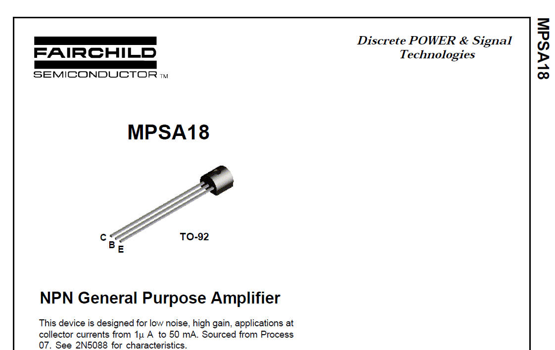

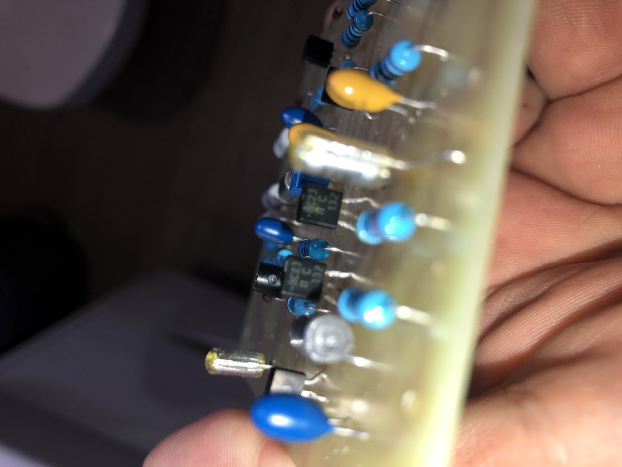

Btw, and as apparently noone noticed it yet: BC550C also is EBC.The screen printing on the pcb is done for the MPSA18 that have EBC pinout instead the BC550C have BCE pinout

- I changed the BC550c's with BC239c's. BC239's Hfe's complately similar (590/591 & 614/614). BC550's Hfe's had very nearly. So, dc offset didn't change with BC239's.
- Bias continuously changing with temprature of case. It's not stable. case box almost close, not air flow in it. Then, bias increasing with temp. of case.

- MPSA18 VS BC239C
