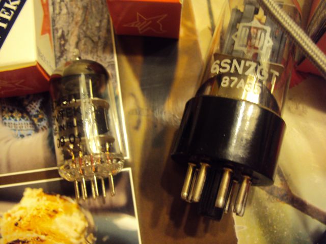

In the meantime i got the tubes for my tube phonostage, some 6C45Pi and i had some 6SN7GT in stock. Actually i changed my mind a bit. The ETF is very soon so i may not find the time to build the fully balanced stage i originally intended. Instead i will grind my teeth on a single ended stage with passive treble and active bass equalisation. The 6SN7GT is useless for that job so i decided on a EC8010 for the active bass equalisation.
It has more Gm and more mu and that is neccesary. Jaap of HAT promissed me that he has some good ones from Valvo. I plan to use LED bias and the T-Reg from Jan Didden.
I have a 5U4GB rectifier NOS Soviet relabelled as ''RSD'' too. Same box art. There must be some rarity value at a point in future for things with East Germany Logo I guess. Sovtek are made in Saratov in the heritage Reflektor factory now run by foreign management and funds by New Sensor Corporation of N.Y. Electro-Harmonix fame. The old boxed anode RSD 6H8C could be originally coming even from FOTON of Tashkent or Melz of Moscow. Black ribbed anode, metal base Melz is the best 6SN7 I ever had listened with. Joachim is preparing to play CITY's vinyl if ''Am Fenster'' on the magazine is any clue. City are RSD original though.

I bought my tube collection around 20 years ago when they where really cheap after consulting with a friend of mine that designed the Intonation preamp. Well, not all of them. The Philips E88CC SQ already costed 130,- DM a pair back then.
In the phono there will be surprises maybe. Some famous types in line level or amps can have inadequate hum to cathode from the heaters, out of spec en, many things. Different from sample to sample. Takes luck. Down to what theoretical Rn the 6C45Π can take the noise spec of the head amp? 1nVrtHz?
edit: I found some analytical spec. Seems like Rn=300R (en=2.2nVrtHz) if run at 10mA so not to create other noises. 2nVrtHz for 20mA, same 50V Va. I hope it will not need a grid stopper due to high gm, that would add up. Do ferrite beads work on tube base pins well?
http://www.triodeel.com/6h30.html
I do not intend to use the 6C45pi directly connected to the MC cartridge. I will use a Lundahl transformer before it. I plan to run the 6C45pi on 15mA with Led bias.
The first version will have a simple Anode resistor but i may try Anode chokes or constant current sources later.

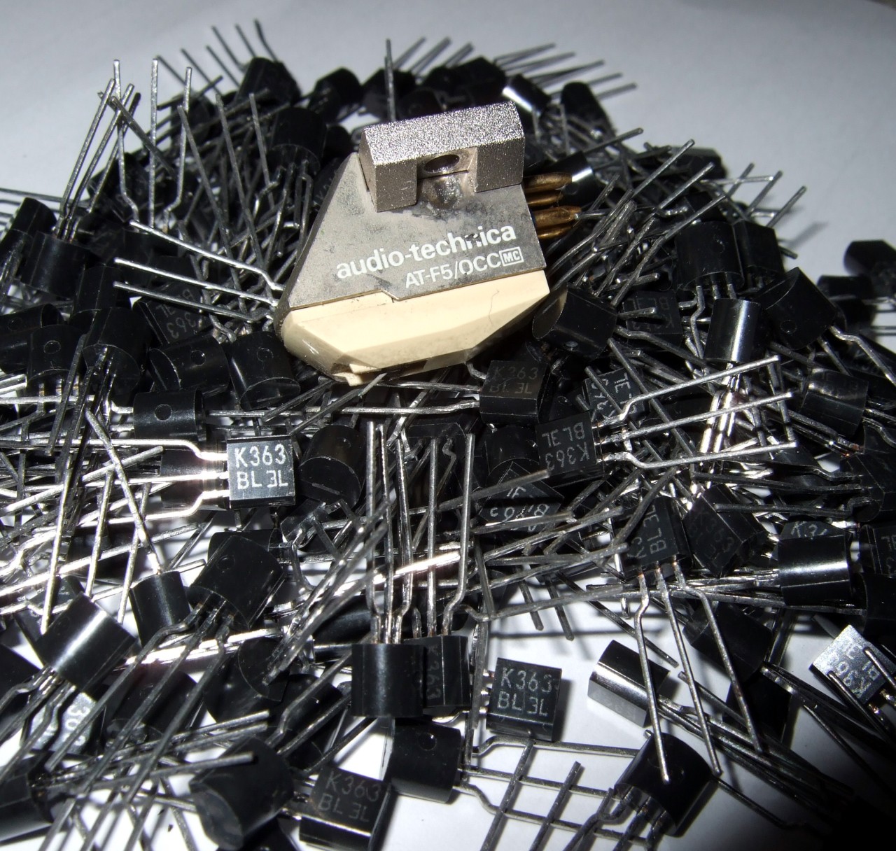

The 6C45pi can stand more current so a Fet-Tube casode could be build like in the Athur Loesch circuit. I could then use 4 x 2SK369 on 40mA total. That whold be very low noise too. The Gm of that stage would be a massive 160mS.

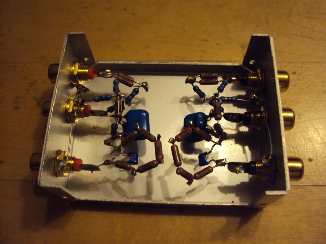

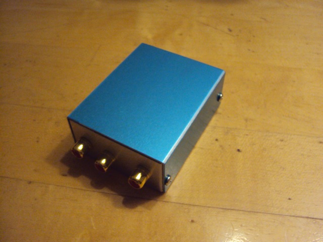

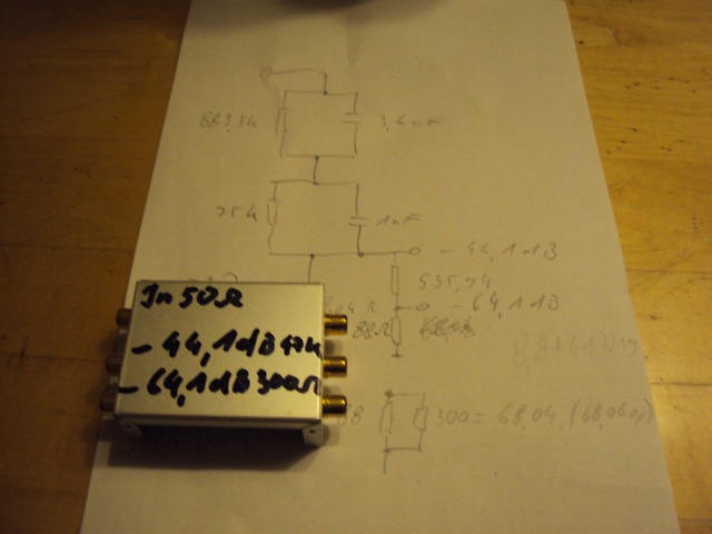

I build a Stereo Anti RIAA. Again i use a slightly modified Lipshitz Legacy network. This time i have optimised the final voltage divider for 300 Ohm loading. I use now 300 Ohm most of the time as input impedance of my MC stages. This Anti RIAA can also be put behind a CD or better SACD player with sufficiently low output impedance and then the player can drive the phonostage. I do not say that this is a fidelity test of any kind but a sraight wire bypass could be quite telling at least about the tonal balance.
