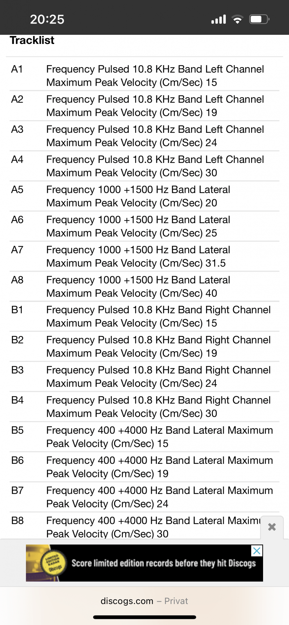

40cm/sec can be cut in Extreme cases over a narrow frequenceband. See Shure Test Record TTR-103. There is a mix of 1kHz and 1,5kHz cut with 40cm/sec. My Atlas Lambda pulls out 0,56mV @ 5cm/sec. So 40cm/sec is 8 times more then that. In extreme cases we can expect 4,48 mV.
150/4,48=33. Overload margin is ca. 30dB.

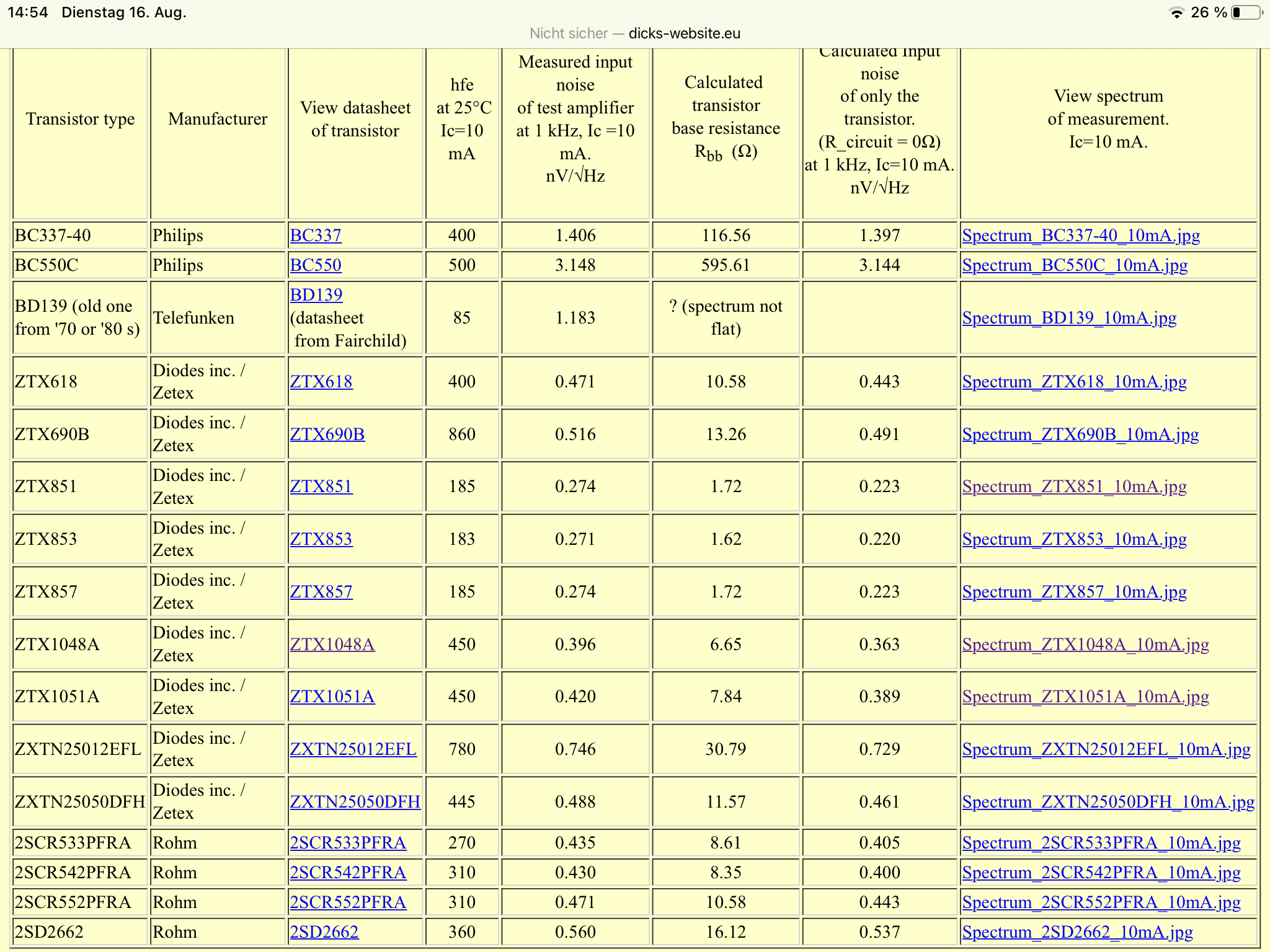

With BJTs the Noise impedance is aprox rBB‘ plus Feedback resistor to ground plus 1/F. ( Excess Noise ) here are some results @ 10mA idle.

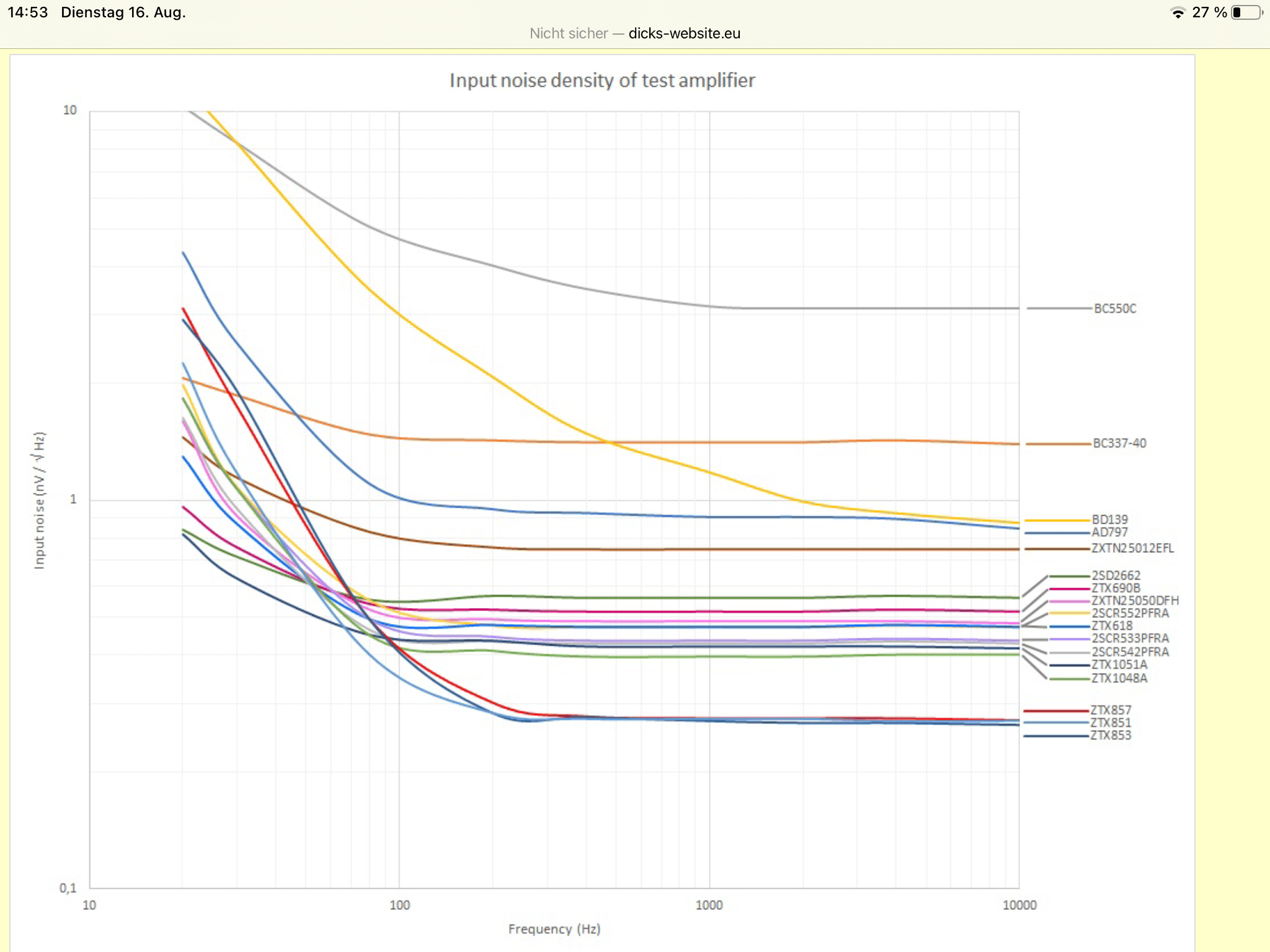

Don’t know how you got these noise images, but they are a bit odd.

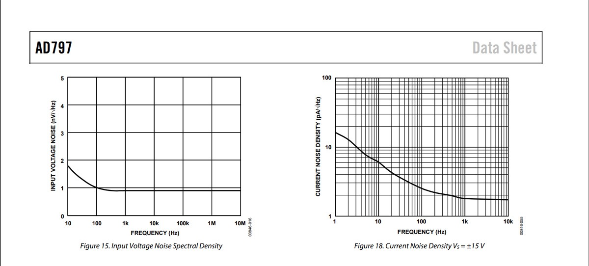

As a reference: the AD797 has a documented and measured ca. 1.5nV/rtHz@20Hz where your graph shows 3 times as much with 4.5nV/rtHz.
Fifteen different ZTX851 samples measured less then 0.3nV/rtHz@20Hz where your graph shows 2.2nV/rtHz , even a factor 7 higher !!
Above 100Hz, the two above samples seem to be fine in your graph.
Hans

In fact the origin of these tables and graphs is in the Netherlands, so they must be trustworthy :

Here's a copy of the AD797 documentation showing 1.5nV/rtHz@20Hz and a copy of a measurement done with the ZTX851 showing less then 0.3nV/rtHz@20Hz.In fact the origin of these tables and graphs is in the Netherlands, so they must be trustworthy :

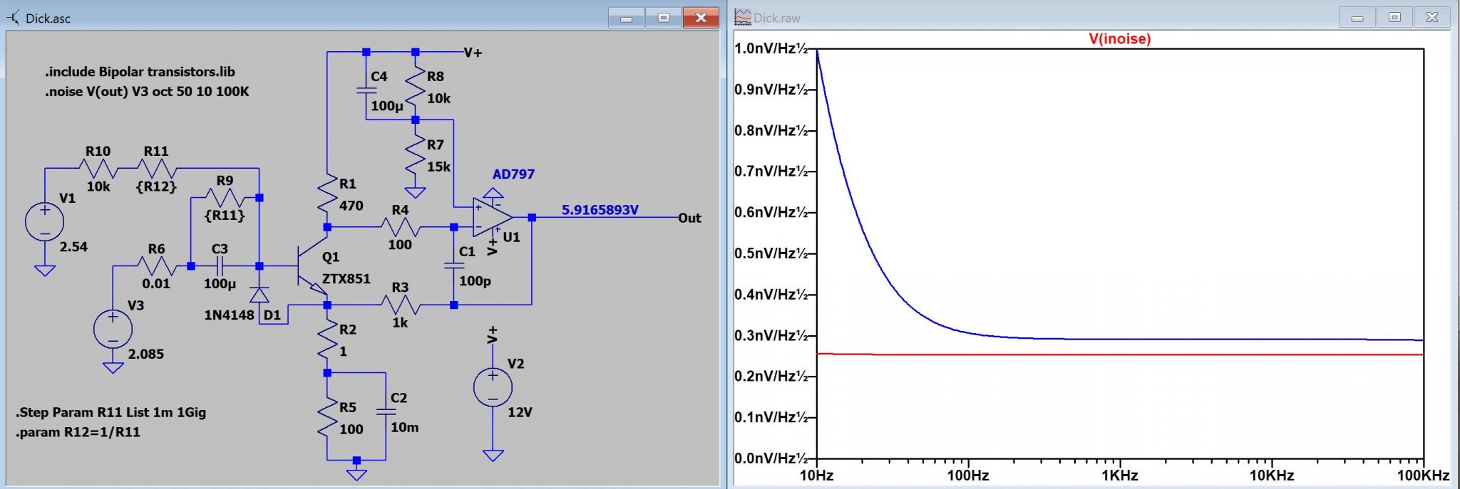

I will reproduce Dick's measuring circuit diagram in LTSpice and see what it brings.
One thing is already obvious, measuring transistor noise with a Cap in series with the base will result in wrong results at LF.
Hans
I made a quick LTSpice copy of Dick's model, of course with an ideal input cap which is definitely better that any physical one, and simulated with and without input cap. In both cases output voltage was held at 6 Volt DC.
It's quite obvious that an input cap pollutes the LF noise figure, red line without and blue line with input cap.
Hans
Hans

I looked at it and don’t agree with the calculation.Did you see his investigation on AD797 ?
http://www.dicks-website.eu/low_noise_amp_part2/part2.html
When done correct, you won’t get a measured value below the specified 0.9nV/rtHz.
Hans
Without reading it all I see 0.82 nV/√Hz from him, not too far away, assuming that Analog Devices gives
typical or even guaranteed figures. And as he says some differences can be explained by FFT settings etc.
