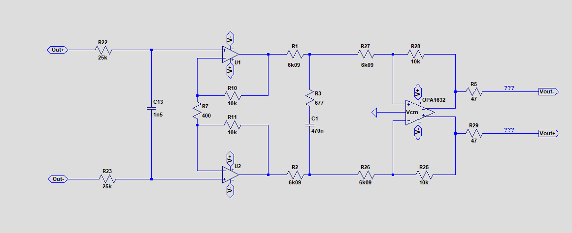

I came late to this thread and never realized you had a commercial goal in mind with this amp.
In that case I could give you some additional tips.
1) For a commercial product to stand off from the crowd, overload margin @20Khz should be at least 30dB or circa 158mV@20Khz for the 0.5mV@1Khz standard.
But that is easy to achieve.
The current design has the whole Riaa correction in one go, directly after the first stage, meaning that after having amplified the MC signal with the IRF3602, it will be attenuated by 40dB @20Khz, bringing it almost back to the original MC output level.
That’s why the noise performance of the second stage is now so critical.
However when you only apply the 75usec pole at this stage, the signal at 20Khz will only be attenuated by 20dB, making it possible to reduce the gain of the first stage a bit to achieve this 30dB OLM without any noise problem in the second stage.
Then between the second and the third stage the 3180usec and 318usec pole zero correction has to be placed and voila, there you are.
2) the second tip I would give to keep the product top notch, is to give it not only a SE but also a differential output. An OPA1632 instead of the OPA1652 will give you exactly that.
Then a question: what exactly do you mean with “matching the channels”.
Gain is set by resistors and not by the dual fet. Only the input capacity can vary from one fet to another, but an MC amp can easily have an input capacity of 1nF, so by adding the proper cap value up to 1nF this seems no problem.
Hans

Where would you place the cap to achieve the 75us pole in the 1st stage ?
To give you an example, this is what I meant.
R7, R25 and R28 optional to set the gain according to your taste.
I have also added the zipped OPA1632 model for your convenience to be unzipped in the same directory as your .asc file.
Hans
P.S. When you don't like the 1632, this can also be done with the OPA1652 SE version, only R1,R2, R26 and R27 have to be recalculated.

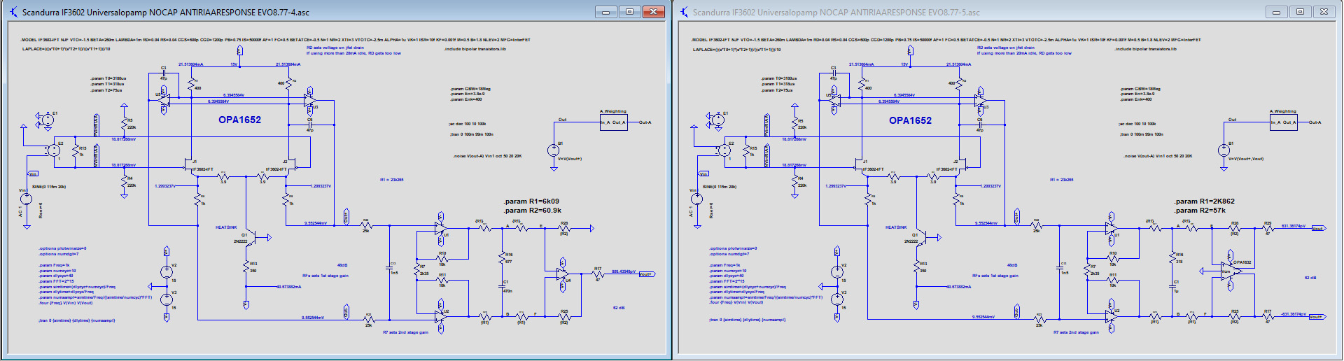

In case it could help finding a proper final design, here two versions, the left one SE out and the right one SE + Diff out.
Both have the maximum possible 61.8dB@1Khz SE gain with the used +/-15V supply. The right one has twice as much with 67.8dB Diff gain.
Maximum input at 20Khz is 115mV, or 20Log(5mV/115mV) = 27.2dB OLM for the standard 0.5mV@1Khz MC Cart.
All three stages have a gain exactly as such that the maximum output right before clipping is achieved simultaneously at each of the 3 stages at the most critical 115mV@20Khz.
For the frequencies below 20Khz, OLM is between 27.2dB and 27.8dB.
Hans

Perfect... I would like to sim those but can not see the values and placement of R1 R2... etc.In case it could help finding a proper final design, here two versions, the left one SE out and the right one SE + Diff out.
Hans
Can you post a pdf or a bigger image Hans ?
