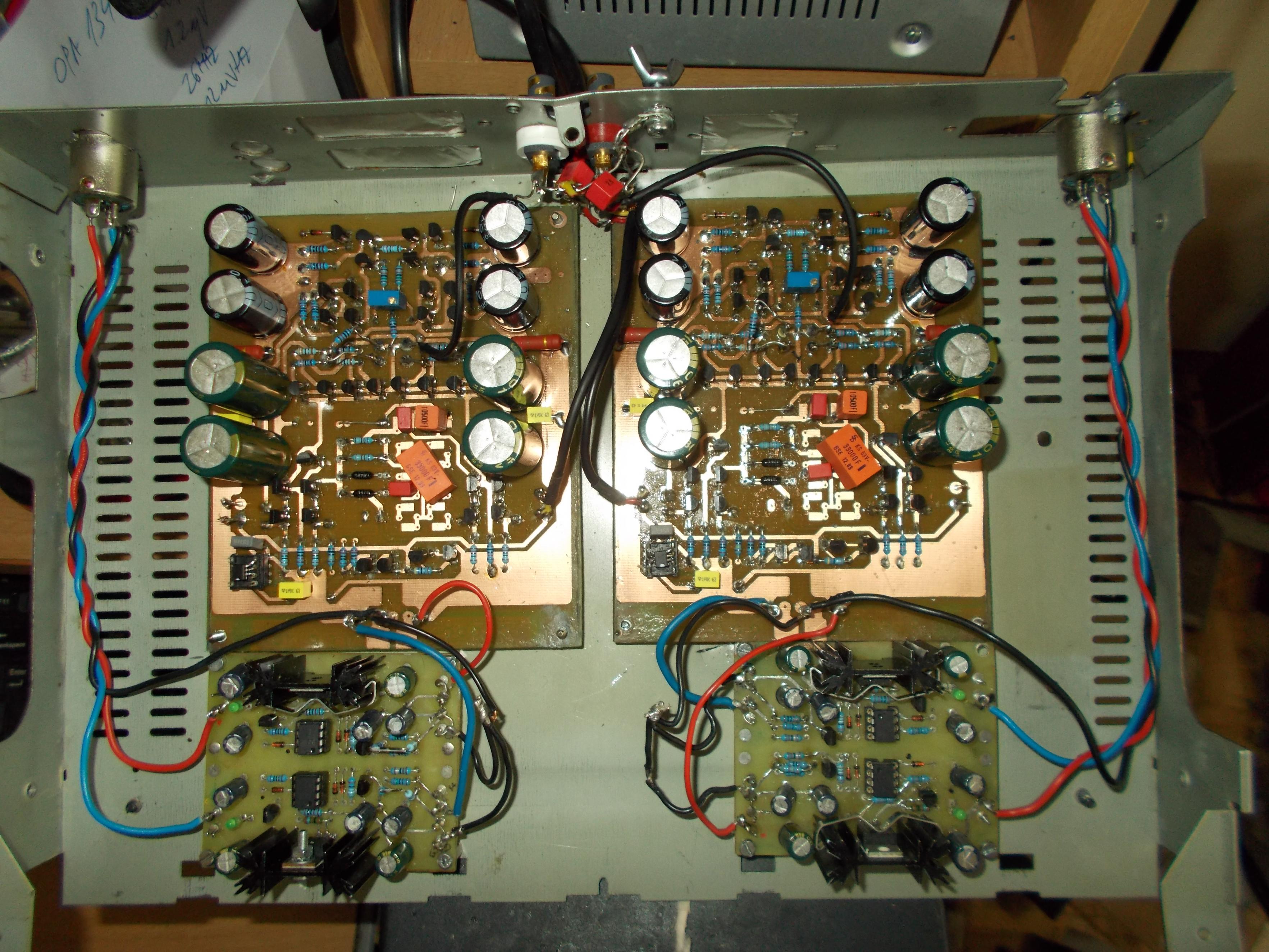

Yes, I know , I have Paradise phono. Input current trimming is a good thing. But, C-37 phono is very expensive phono preamp with perhaps 2000na of input current.
My version of Paradise, with Jung Super regulators. Noise and hum free.

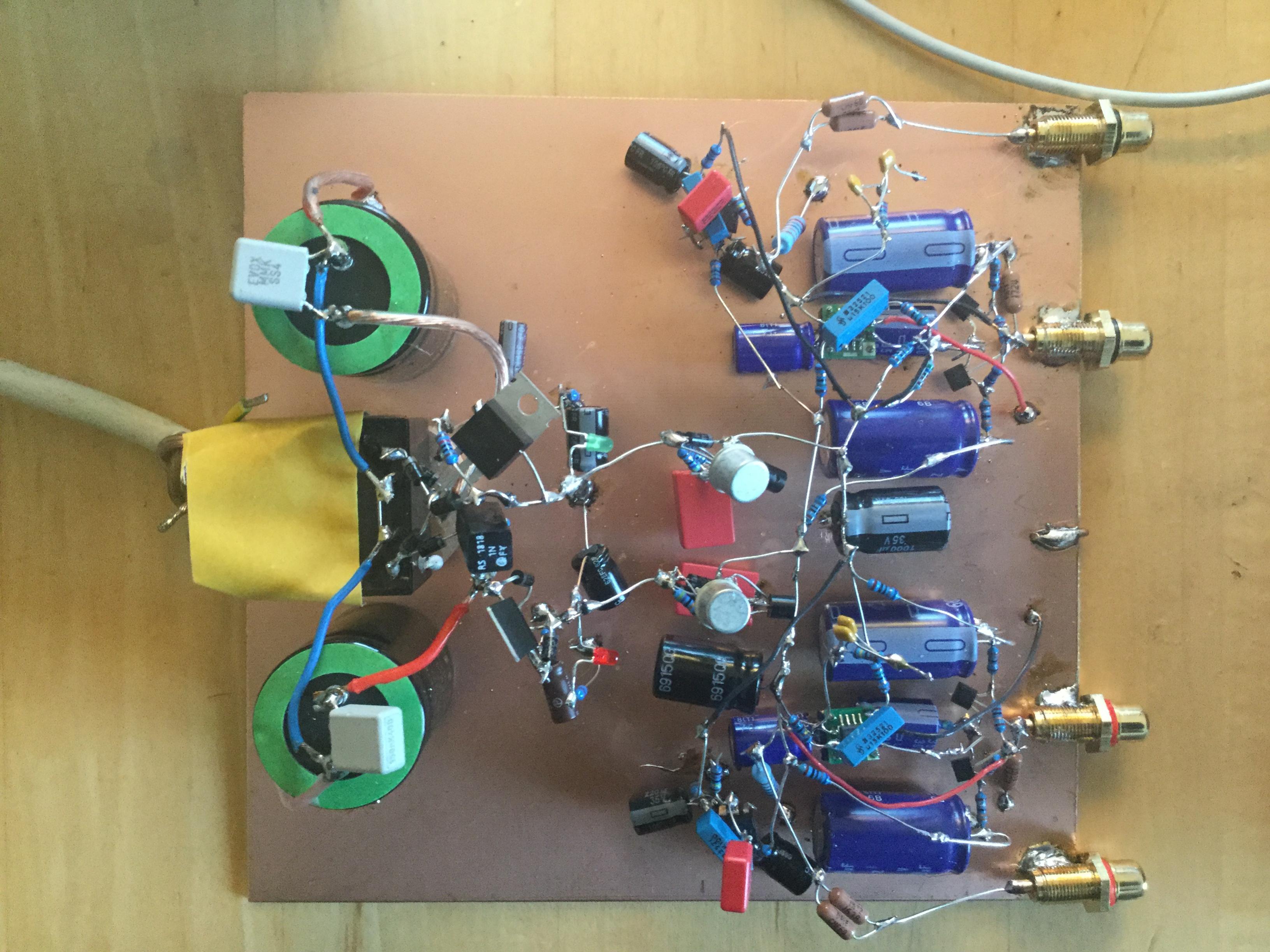

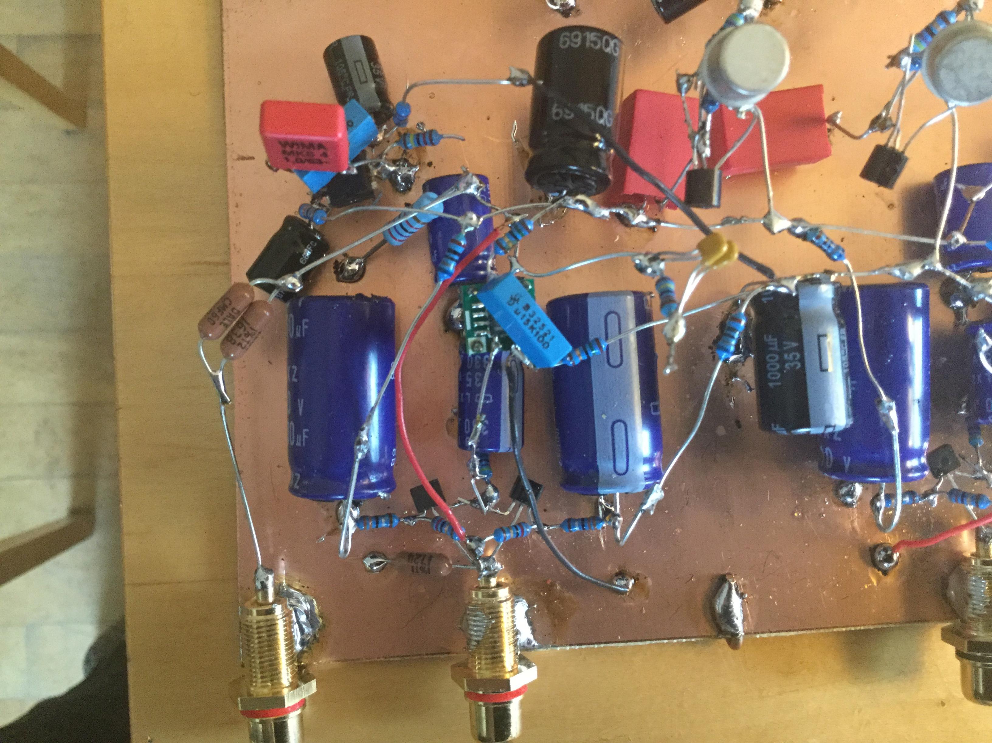

Just for fun I build the Renardson MC Pre-Pre, a design that is a bit similar to what QUAD did.
Unfortunately I could not make it work so far. I build several versions. All play music but it sound distorted and noisy.
I may be oscillation, on the scope the output shows spikes.
I tried to mail Mike Renardson but I can not find an email address on his site.
As far as I can tell he has not build the circuit himself so far.
Has anybody an idea what I could try to make it work ?

Hi Joachim. It might be worth building the Quad as it is a crazy idea that works. Everything Quad made was a bit crazy, Yet Quad always seemed the quintessential English gentlemen. Quad claimed the phono stage was influences by current dumping. Douglas Self said 0.05% thd too high. If I had presented it at college I would have been told off. To define crazy the valve power amp was a longtail pair with a short tail using EF86 driving KT66. It couldn't possibly work, yet did. Quad 303 is bonkers, I love my one. Crimson being a version.
Rendardson have a very interesting single input stage for a power amplifier. He uses a NPN PNP complimentary input pair which avoids any compromise on linearity whilst allowing the simplicity of 1960s designs. He also uses feed-forward correction. As phono stages often need current, why not adapt his power amplifier?
If it were me I would use 9 V batteries at first. Yours circuit looks that it should work. You can try 47 uF on the LM317/337. It is slightly better and I never had a problem. Takes noise floor down about 2dB. After the regulator a simple resistor will do as the circuit defines a simple current source. I love LM317's. It's very hard to make them work badly except in cascade. LD1084 seems no worse!!
