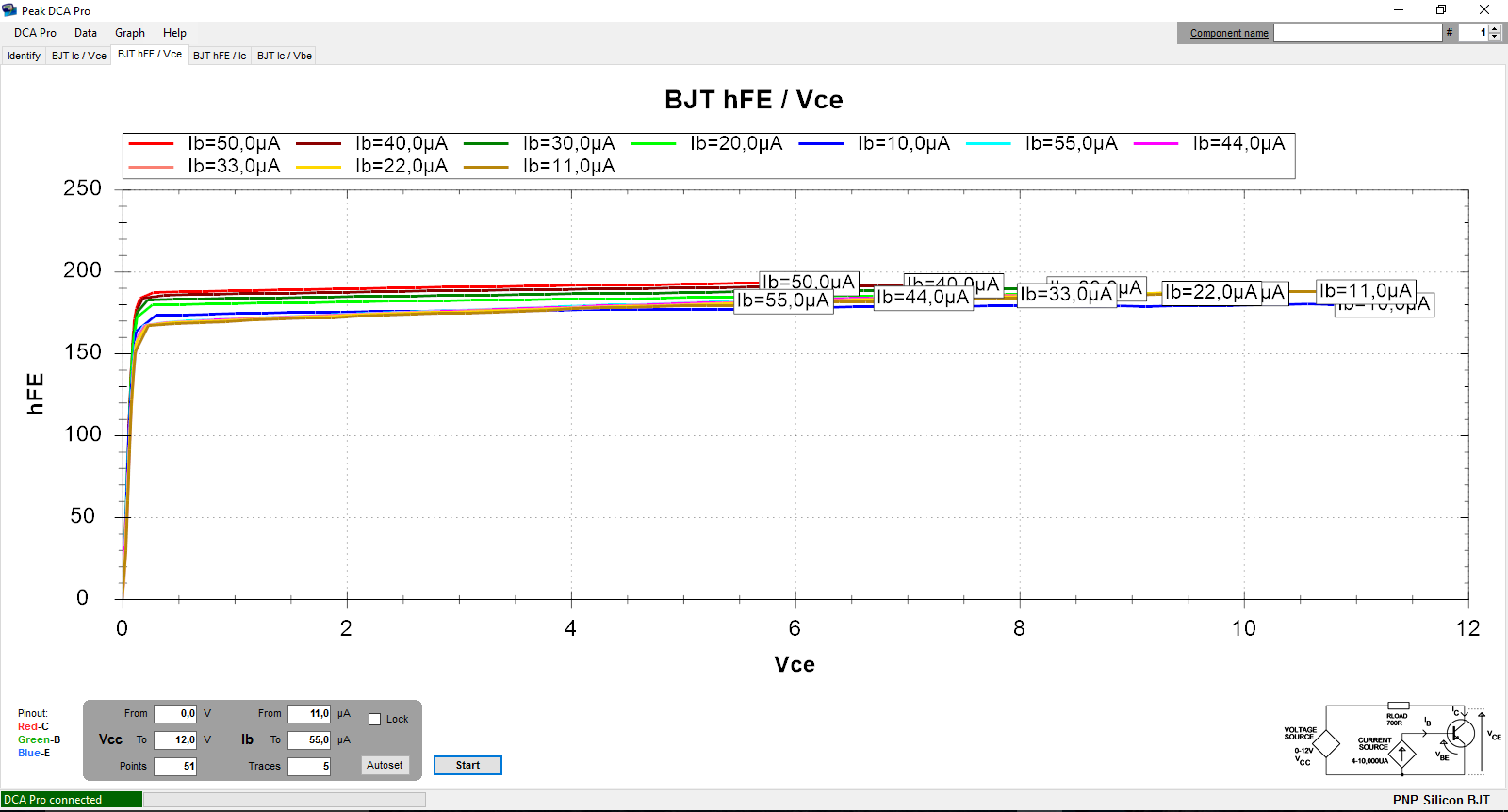

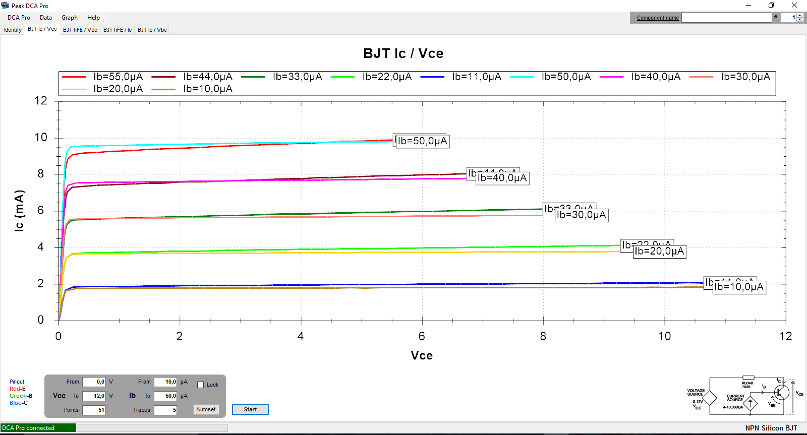

I put the ZTX851/951 pair on the curve tracer.
The result is very promissing.
Without searching much i found a well matching pair.
Early votage of the PNP is high and there is good Hfe linearity.
The graph shows both transistors overlayed.
