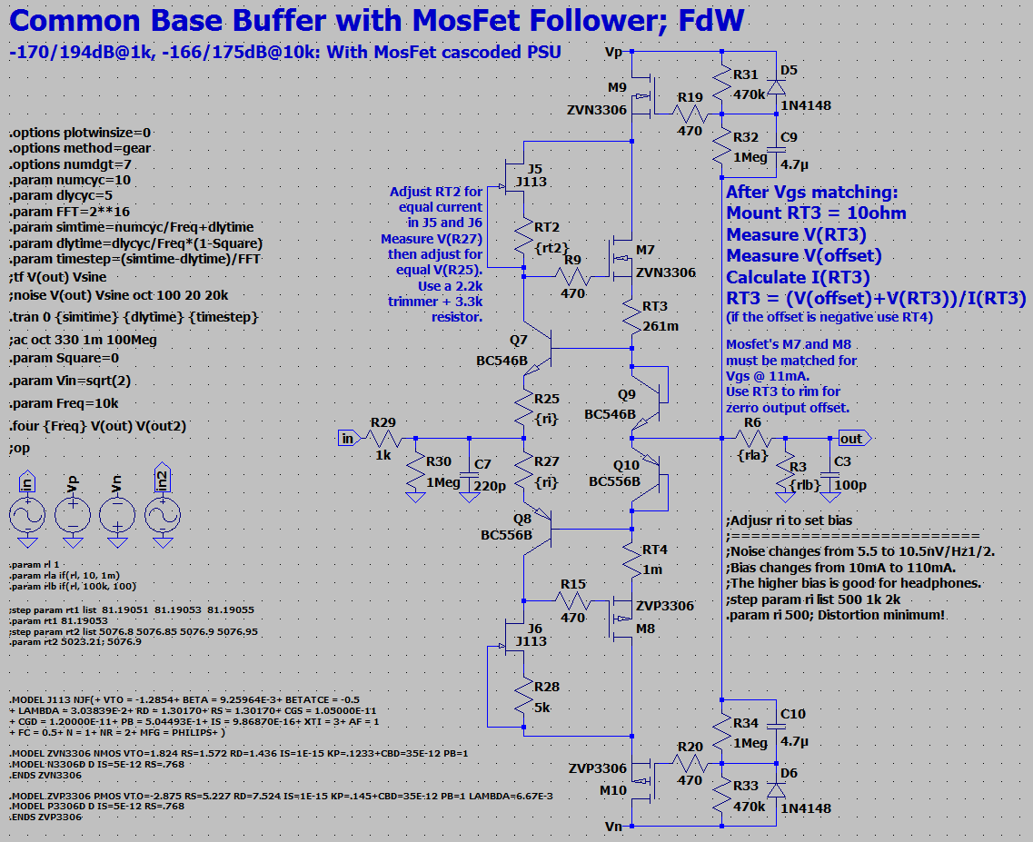

I have a look at your right hand circuit in post 9981.
Mosfets 7 and 9 have the same n-channel designation, but different polarity in the diagram.
But it is not the same on the negative side. Two ZVP3306 (8 and 10) are shown, p-channel from the datasheet.
I can not read the diagram in 9986, it is too small, but may be the same.
It is a small error anyway but it can be confusing.

The mosfet's are ZVN and ZVP 3306. As soon as Joachim is done testing (we are testing a new offset canceling solution) I will post a 'final' schema and .asc.
The offset trim works.
I have now put a 47 Ohm resistor in the source of the N-Channel output MosFet.
The rest i could trim with the negative CCS.
Offset is around 2mV, stable.
Then here the 'final' version 🙂

FdW asked for my contribution.
We see in post 10013 the edited and final version
of the right hand circuit in post 9981.
http://www.diyaudio.com/forums/analogue-source/154210-mpp-999.html#post4005947
This is a full feedback two stage amplifier.
For purpose of analysis the bootrapping mosfets M9 and M10 and
their associated components can be left away and replaced by a short.
Input transistors Q7 and Q8 work in common base mode.
They have high open loop gain because of
- current source load J5, J6 and
- high input impedance of the second stage M7, M8.
Output transistors M7, M8 are source followers.
Output is connected to the negative input (bases of 7,8)
as known from an opamp buffer, so the resulting voltage
gain is 1 and the input impedance goes up (it would be
as low as Ut/2Ic with a common base input without feed-
back). Q9 and Q10 are a short for ac, nicely coupling the
output to the negative input while preserving bias for the
input stage.
A desirable feature of this circuit (although not absolutely
mandatory with mosfet output) is the bias stabilization
performed by Q9 and Q10. Bias and residual (small) offset
may be adjusted by varying source resistors of J5 and J6.
The whole thing is bootstrapped by M9 and M10 and
associated circuitry. At this point two coupling caps C9,
C10 are required. If you want to avoid these, R32 and
R34 can be replaced by voltage sources and / or R31
and R33 by current sources, adding even more complexity.
With some resistors added, the gain can be increased,
giving a fine line stage. If preferably biased in A/B it may
also be a power amp output stage (leave away the boots-
trap transistors for this purpose).
