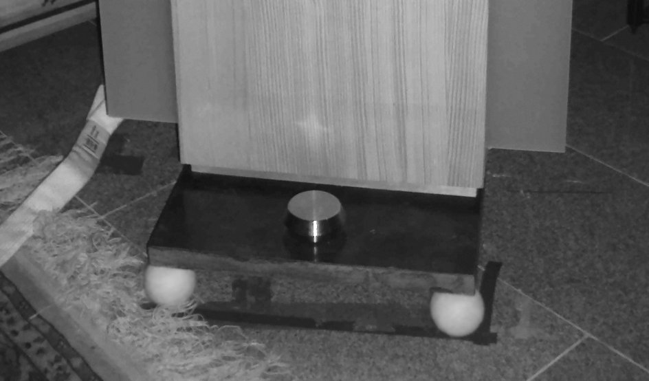

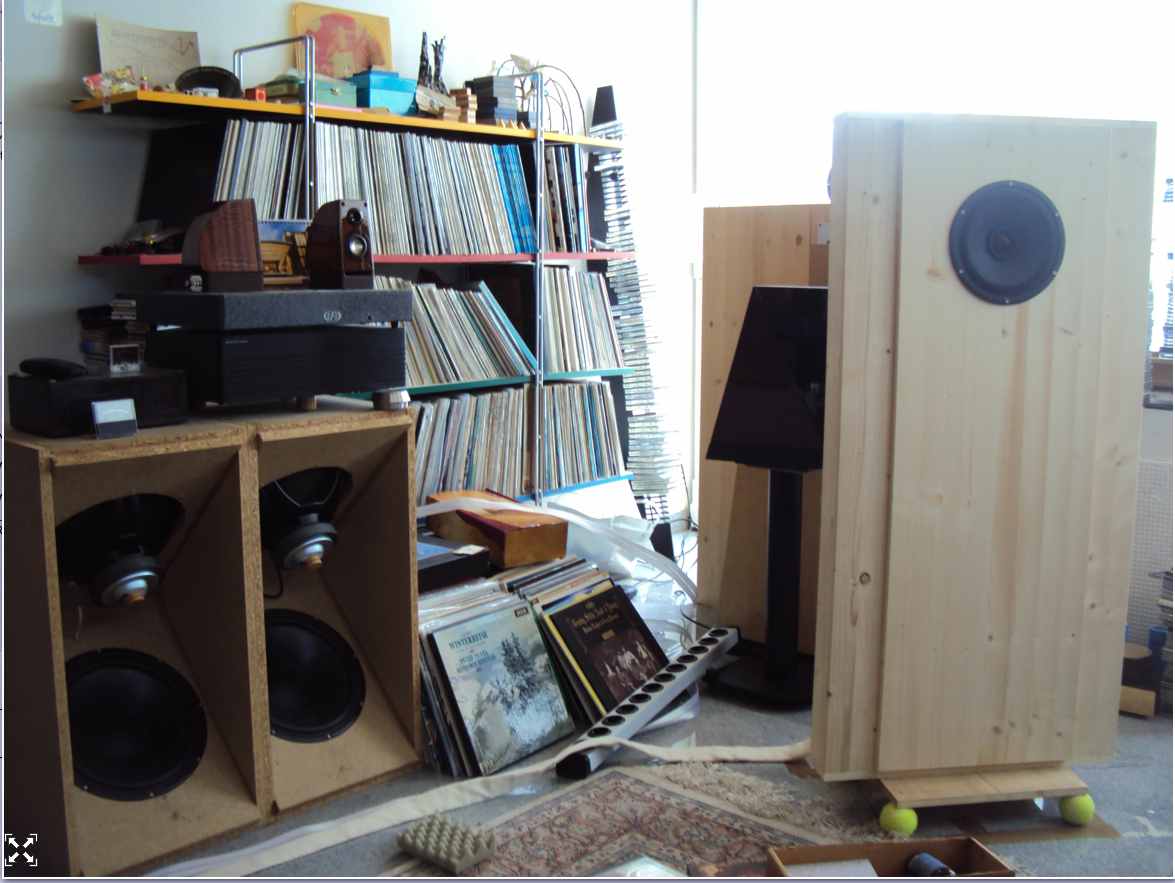

How on earth????!!! The tennis balls? How are they secured? And why does the speaker not zoom around all over the room? How is it tied down?
Or are the tennis balls used for shock absorbers so the speaker can go bobbing about, with the energy absorbed in the balls so the speaker doesn't scoot around? Surely, concert accurate bass impact makes that thing boogie, right? I'd love to know the details on it. Do tell?

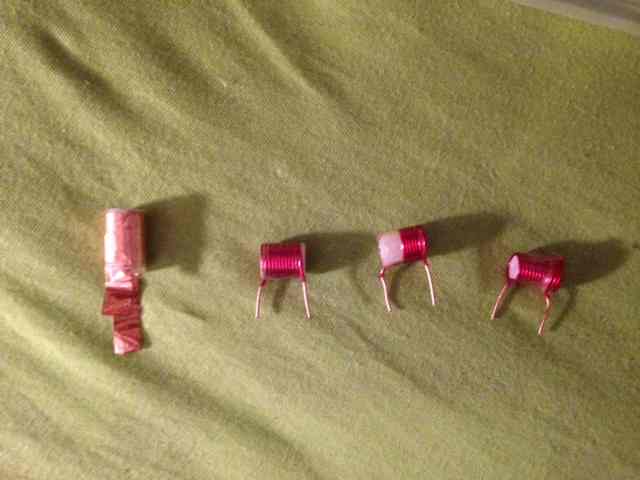

It bothered me that the coils needed in power amplifiers as part of the Zobel are often mechanically not very rigid.
So i commissioned Mundorf to make several prototypes.
One is a foil coil and the other 3 are baked copper wire.

Daniel, this panel only goes to 120Hz or so. The frequencies under that are handled by active M-Dipole subs.
You also have to consider that the weight of the Enviee wide range membrane ( including coil and everything else ) is only 10gr so there is not much force transferred to the baffles.
The stone base is quite heavy too so this baffle simply sits on the tennis balls without falling over to any side.
I measured vibration with an accelerometer on the baffle and contrary to popular believe, vibration was 20dB less over a wide range of frequencies with the tennis balls in place.
I think what happens is when you place the baffles right on the floor the mechanical energy is not dispersed but steered back in the baffle where it interferes with the vibration there so it gets worse.

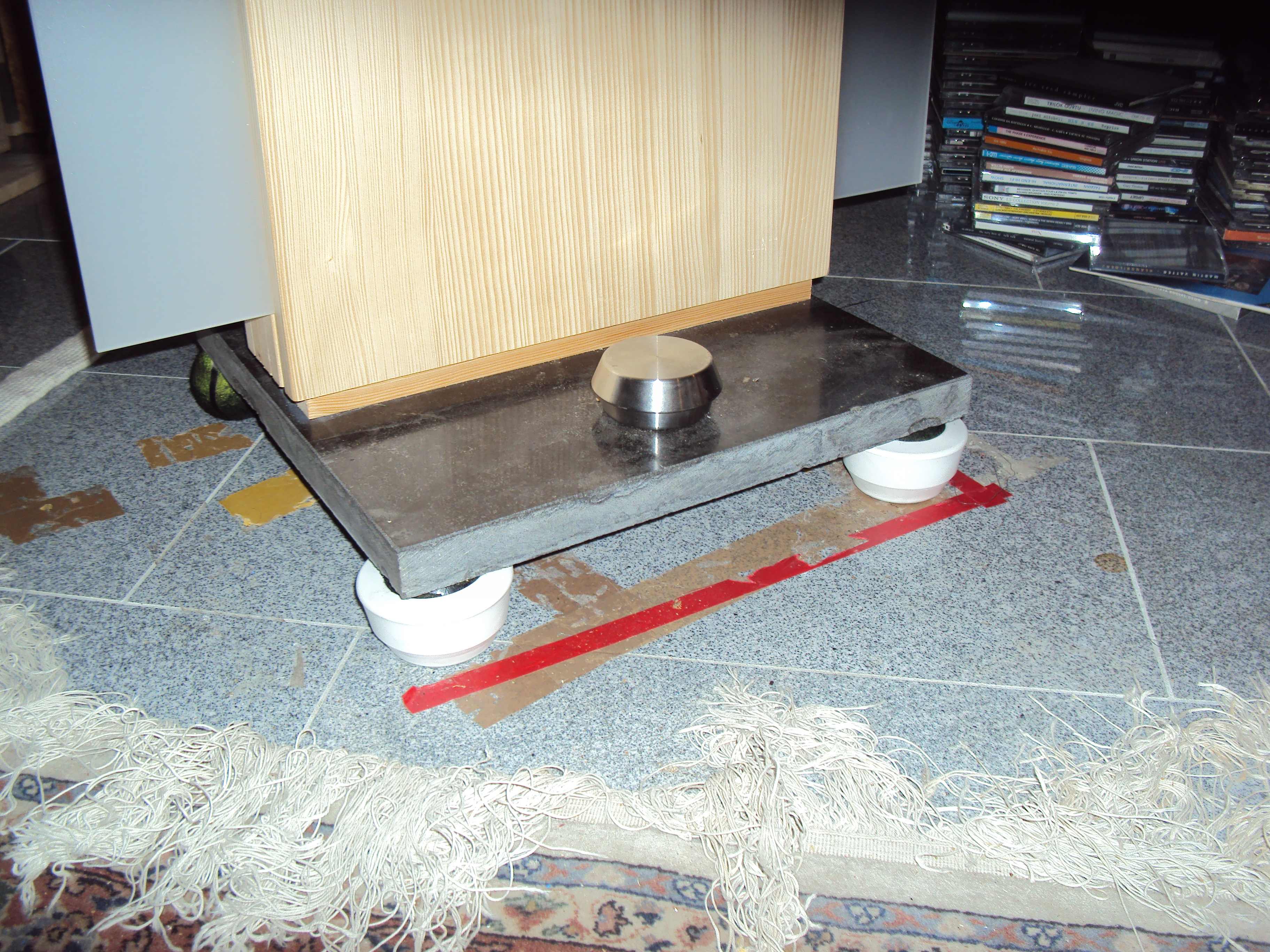

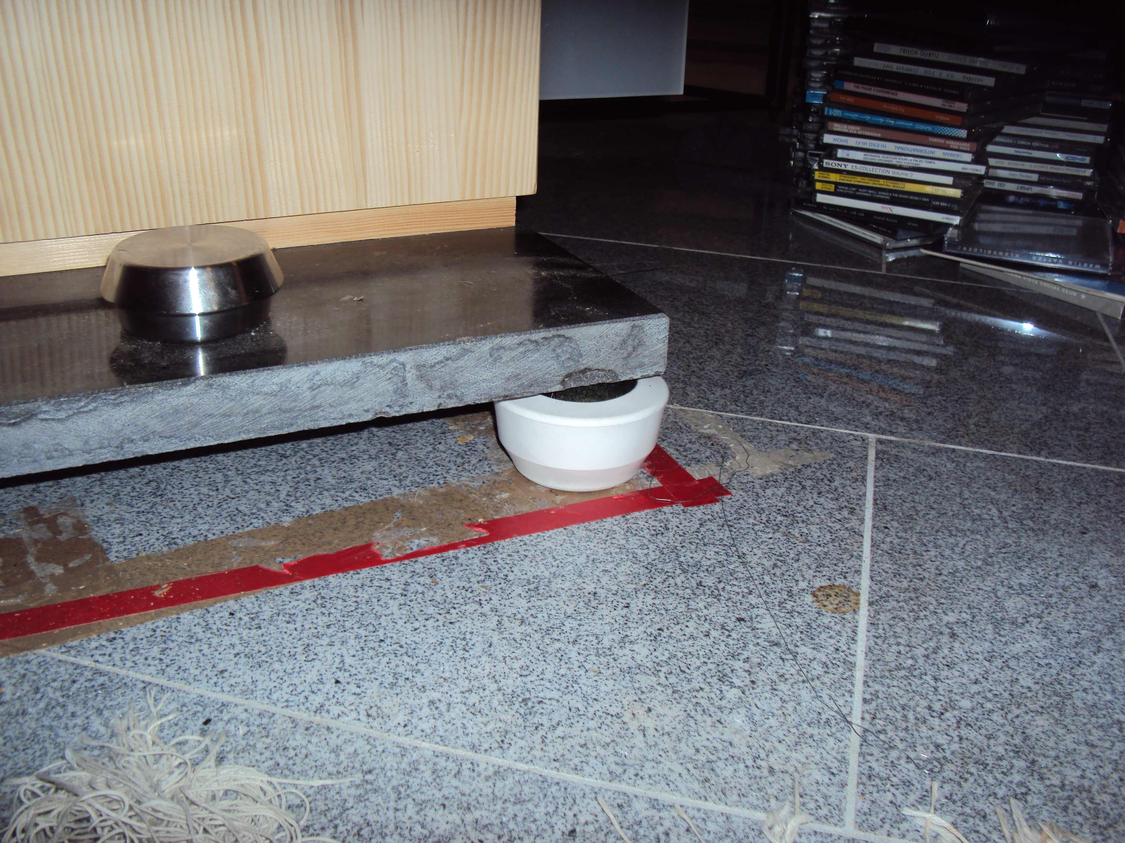

I will of cause not show the squeaky yellow tennis balls in public. They stir much too much attention.
Here is the " beautified " version. I spray them black and put them in a silicon rubber hose. That hose also helps to stop the tennis balls rolling but does not affect the vertical decoupling much.

Here's a photo without the yellow. They don't seem to collect scrutiny when the color is light/medium gray.
