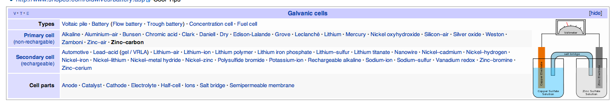

The 9V cells i use ( Alkali-Manganese ) have 280mA per hour so they can supply 20mA for 14 hours.
There are new cells based on the old Edison patent ( Zink-Carbon ) that could fulfill your requirement. I did not try them.
I friend of mine has build a preamp where the bias of the Fets is done by batteries. It works since at least 10 years.
Panasonic makes so called Eneloops that have superb low self discharge. There is a huge
variati of alternatives.
Here is a lineup of what is available .....

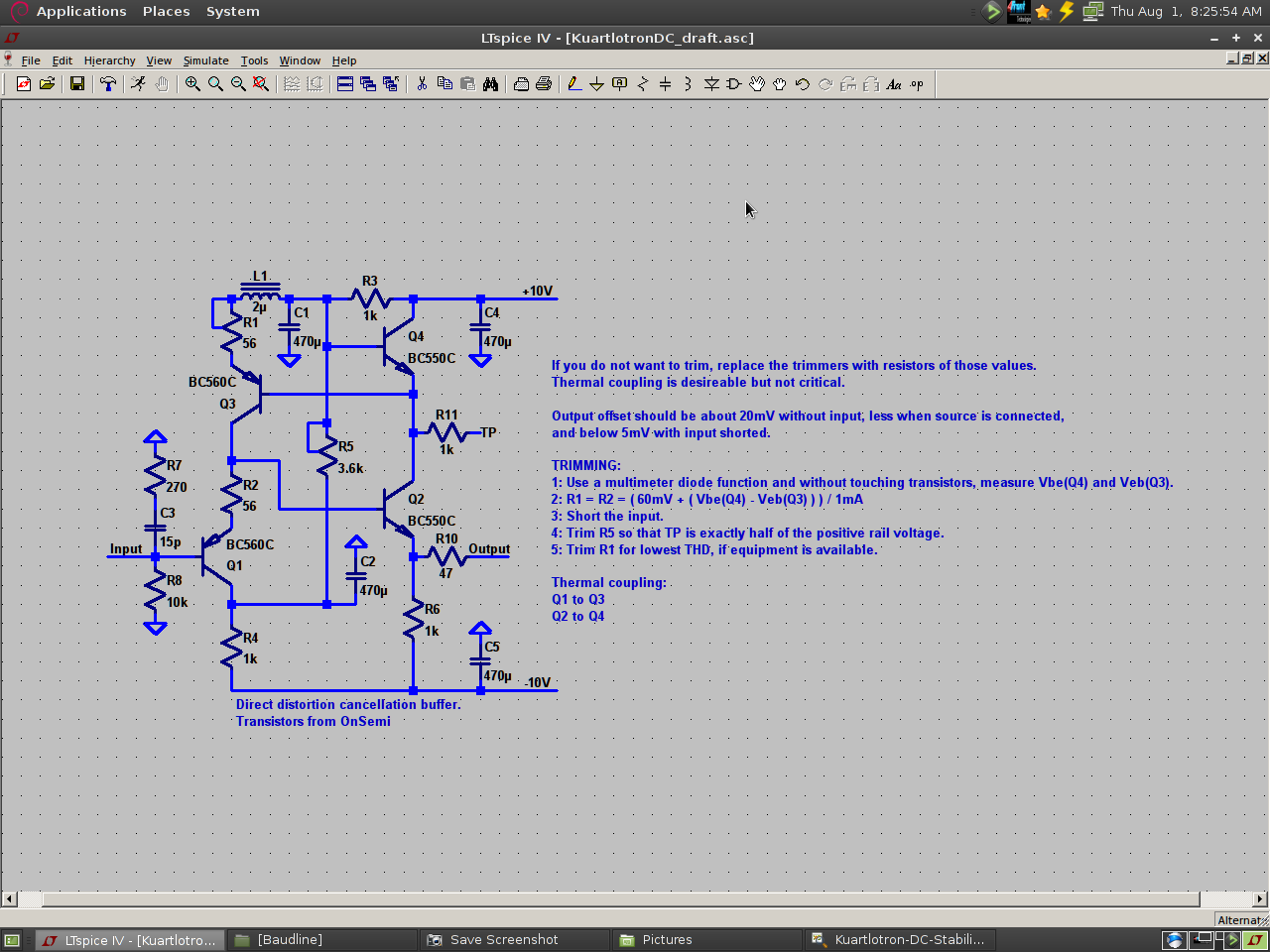

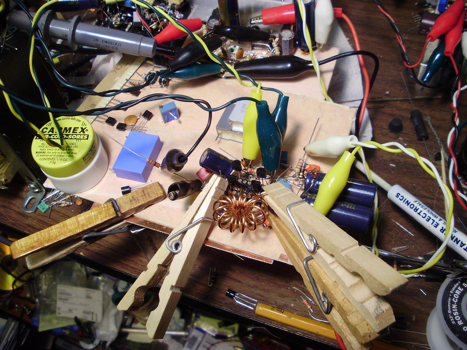

Here is what I've come up with. This preserves the natural focus of the buffer. I'm not sure why. As you can see I used a toroidal coil to rule out interference (and also just for fun). The coil I used is actually 500nH, but 2uH is what it takes for unconditional stability, and still sounds great. You don't necessarily need the 47R output resistor, but it keeps the cable from resonating too bad, and it is something I hesitate to leave out of any buffer.
I tried switching the collector of Q1 to the emitter of Q2. This sounds very good, but has .01% THD with H2 at -80db. I thought it may have better focus but I'm really not sure. In any case the effect is very enjoyable. However ultimately I settled on this version for sounding more accurate in general, to me at least, and having less distortion.
