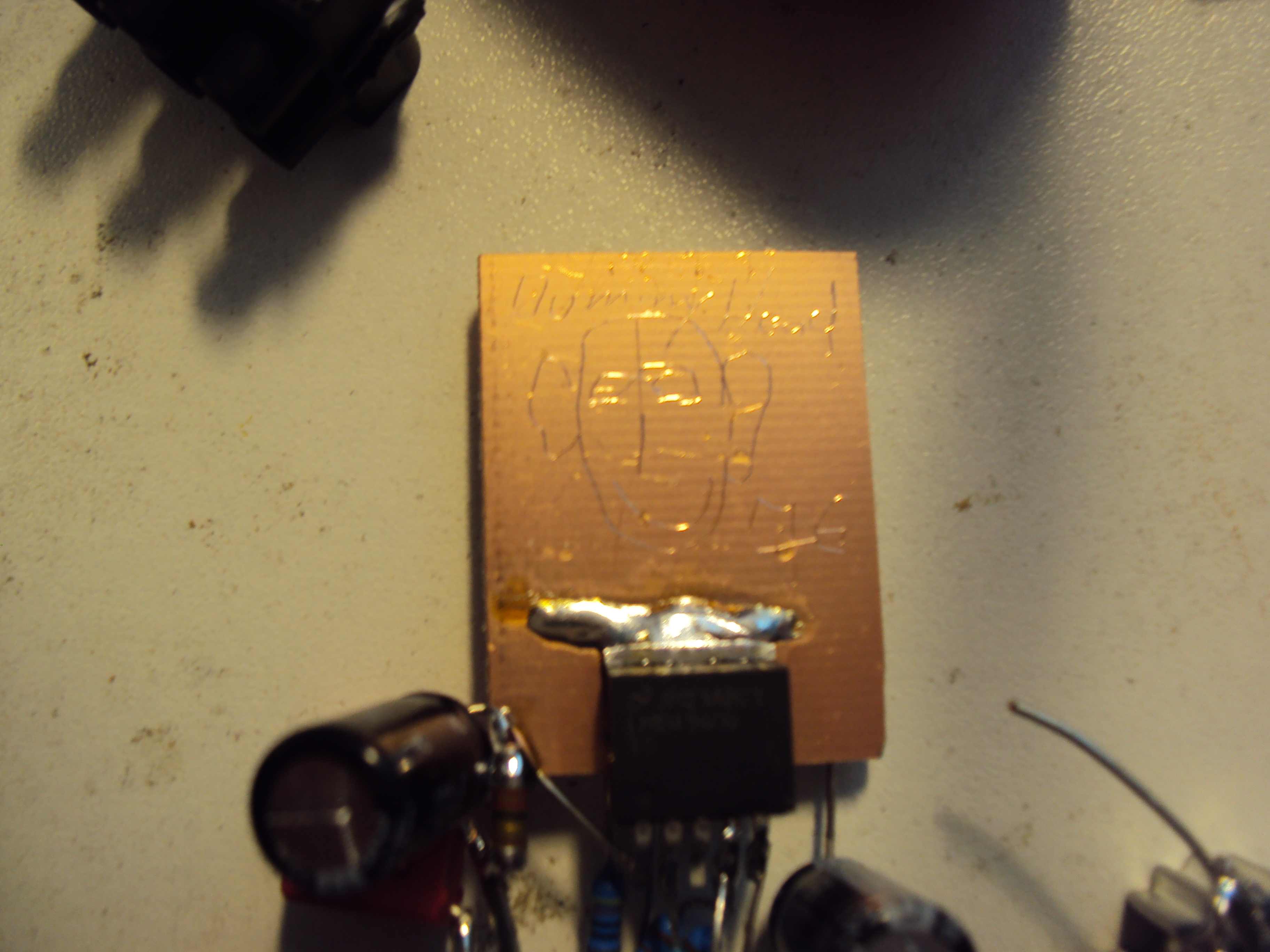

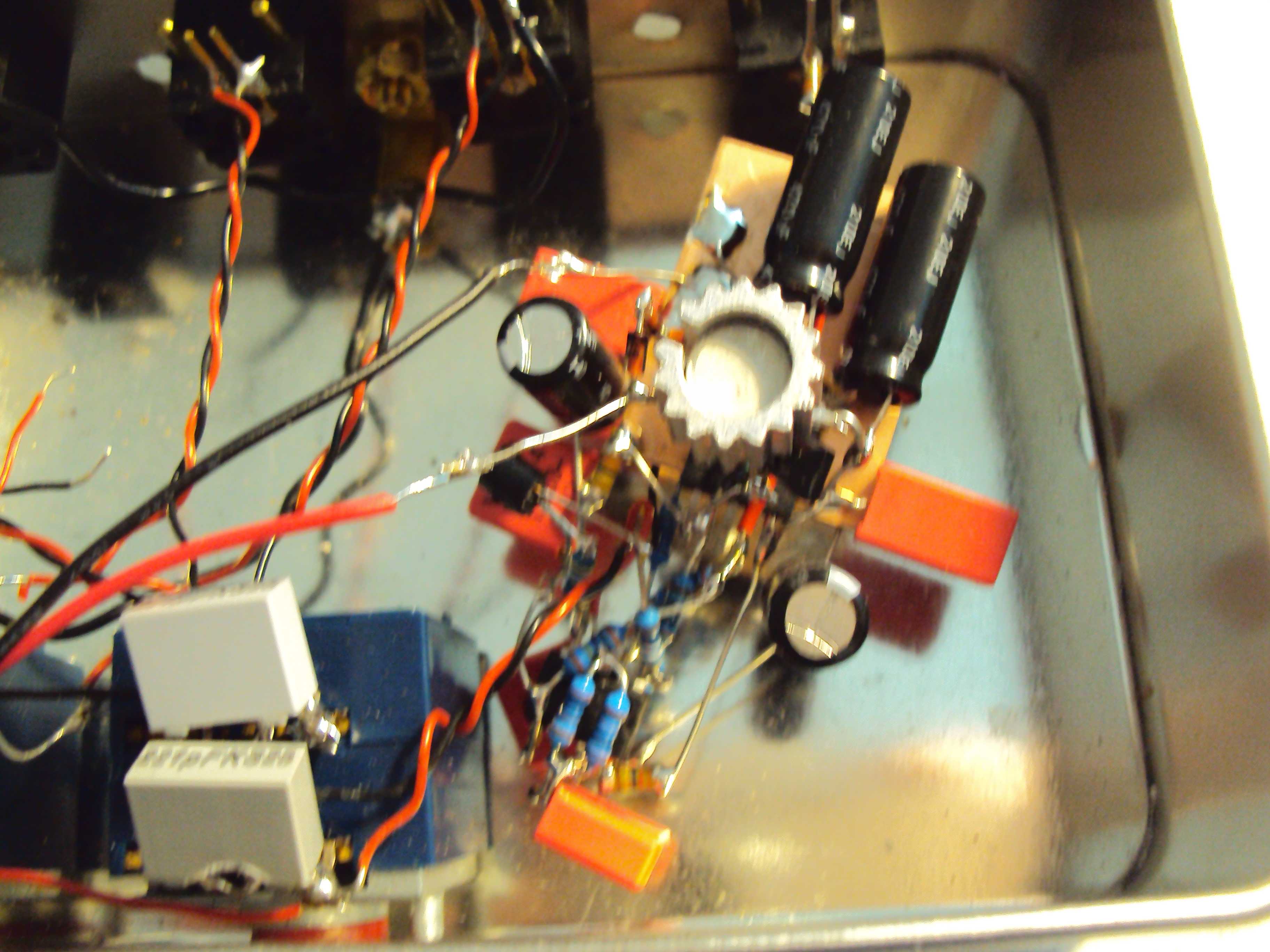

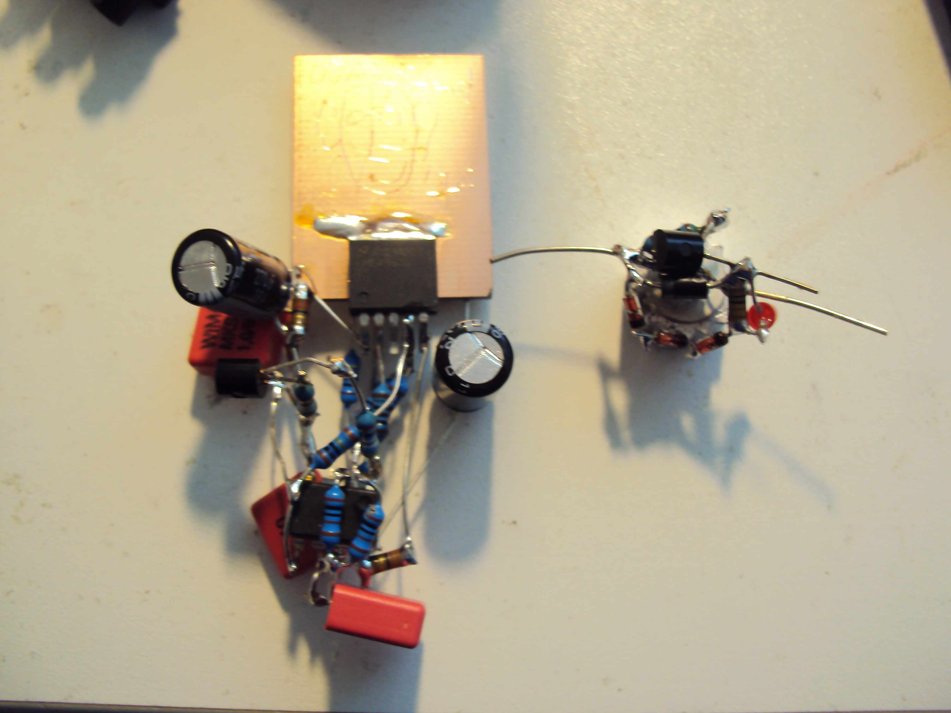

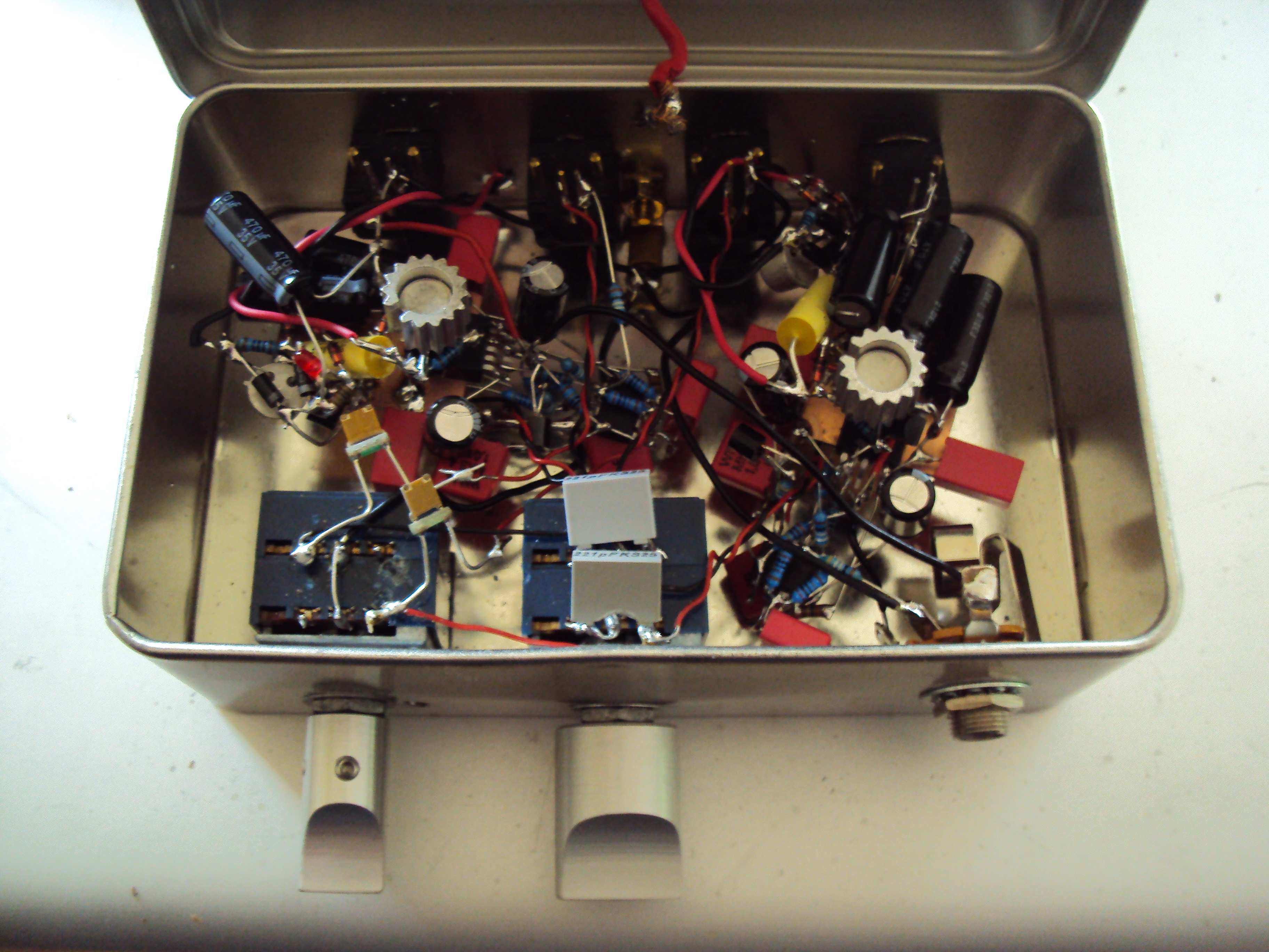

Here are some pictures of the building process....

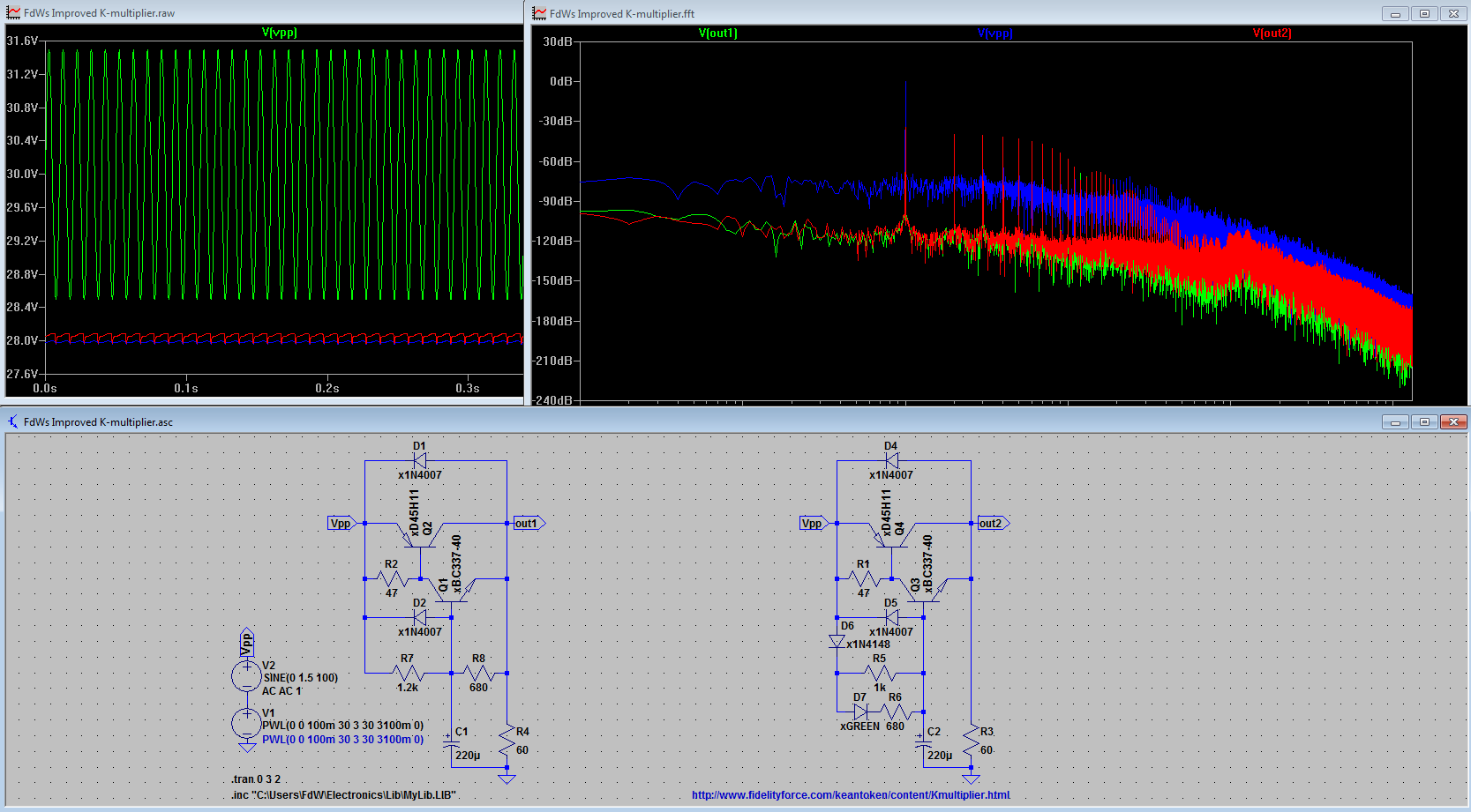

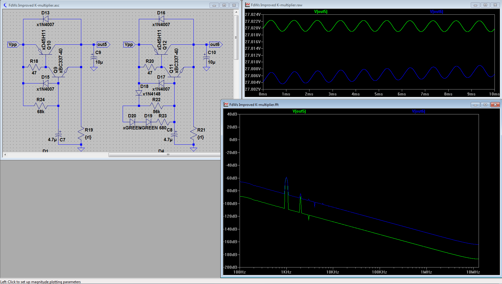

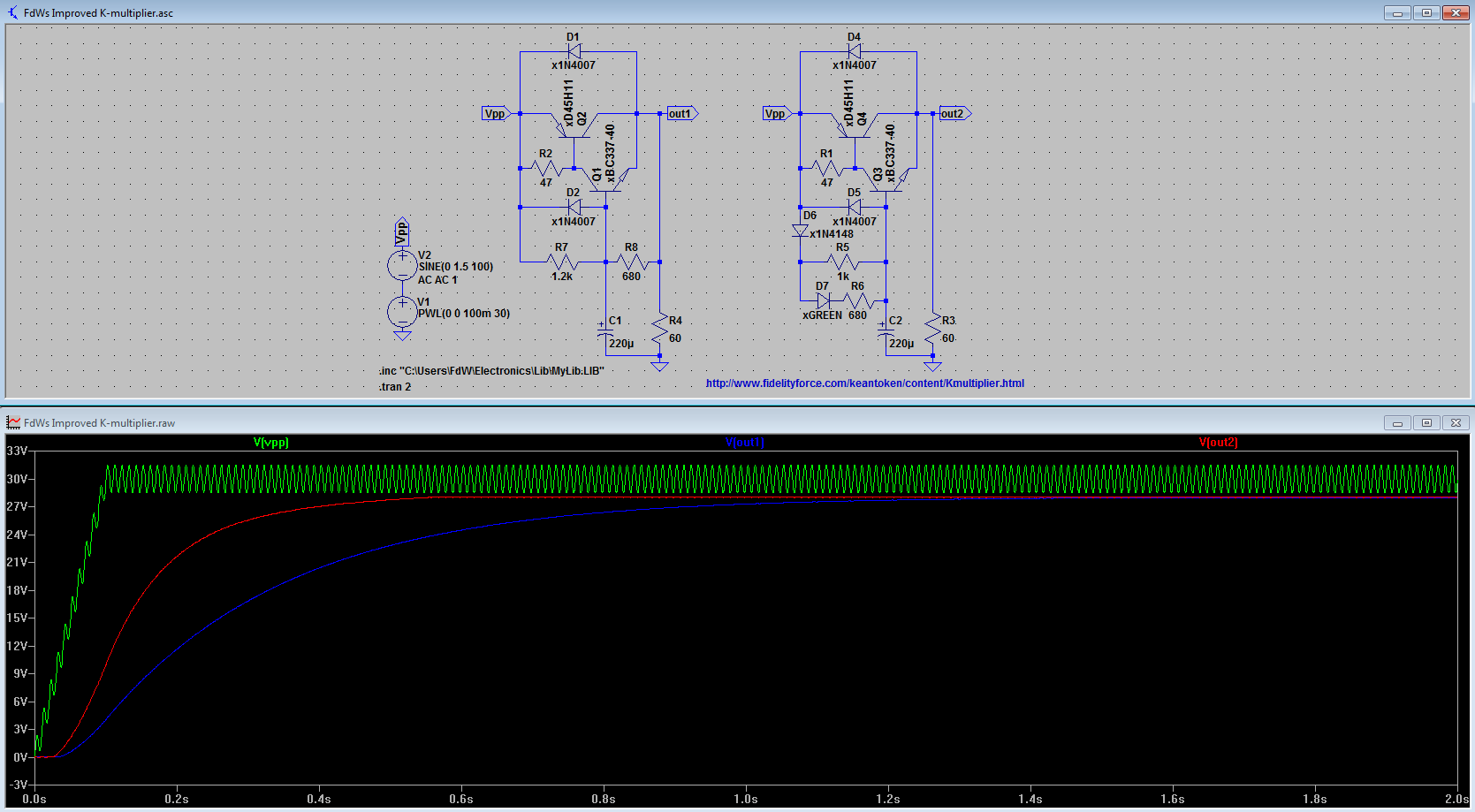

Here is an early simulation of two circuits.
The second simulation shows what happens when the 10uF at the output is taken away.
The second two circuits are not totally identical to the first ones but it shows that small differences can have a huge effect even in very simple circuits.

Alright, I'm excited to see someone's idea for the Kmultiplier. Let me address them:
1: D4xH11 output: The very large capacitances of a large output like this will decrease RF PSRR, which is one of the main ideas of the Kmultiplier. Output inductance will also increase, which shifts the rails away from their inherent self-damping point. Max inrush will increase, but this is only necessary if you use a lot of capacitance at the output. Transient recovery will also be worse. The D4xH11 are actually quite fast; I can't say whether there is a better device I would choose.
2: R8 is a great idea. It gets the required voltage drop without losing RC effectiveness or DC stability. This is not an absolute improvement, but it allows the reference C to be a bit smaller.
3: The higher harmonics on my version may be due to the higher output voltage, even though just a few hundred mV. Try matching the voltage drop of both versions, because Vce does matter quite a lot. The harmonics really only reflect the degree of Vcesat, which will depend on voltage drop which should be adjusted for the application.
I am going to investigate these ideas and see what improvements or drawbacks they may have. I think the reason I didn't use #2 in the first place was because I wasn't using high Hfe drivers, but now that I am, maybe it's a good idea.
My question is, what would you improve and why? There are many ways to customize the Kmultiplier, so knowing what is wanted helps. So far I have simply tried to achieve the best combination and balances of specs.
EDIT: Just remembered, the diodes are there to improve sag rejection, because it causes the Kmultiplier to track only the peaks of the input. This only works if the diode has very small bias current. Sag rejection is a dynamic mechanism that won't show up on AC plots.
1: 2SA1930 may be a better choice (Ft 300Mhz (from the top of my head)) Salas opted this one as a improvement for the CCS of the Paradise PSU.
2: When using high values for the filter resistor R24, the Rbe of Q9 is not needed (most probably not wanted).
3: From the graph (post #9007 left), the difference is 16mV (almost equal :)) For the other (post #9007 right) I think you may be right (although the difference is only 100mV).
One further thing. There is not much point in increasing the RC time constant. It won't improve output ripple because that is determined by the Early effect of the transistors, whereas the reference voltage is much quieter already. PSRR begins to fall below 100Hz. If you are using the Kmultiplier in a power amp, you may want to extend this to 20Hz. However due to the "sag rejection", output ripple may not be as bad as you expect for a conventional circuit.
However it doesn't seem the intent was to lower the LF PSRR, because the reference cap was made much smaller. I wonder why make the cap smaller?
Also, output risetime can become long with a large C, and some circuits don't like slow-rising rails. This is why the LED+680R, to improve turn-on time.
So, considering all this, it seems that the Kmultiplier is difficult to improve without undermining the balance of its features and thus the overall performance.

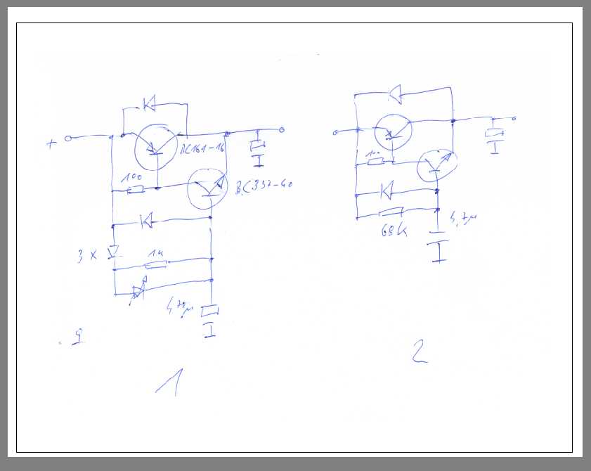

Here is the variety of the K-multiplier i used in the headphone amp. The negative one is build the same way. Do you think it is dimensined resonable ?
Circuit 2 shows a more conventional circuit i would like to build for comparison. It came out of the simulator well. I see the main advantage of circuit 2 in the use of a quite small shunt cap. There is a really small 4.7uF Wima foil so it could work without electrolytics.

I estimate the current gain of that to be around 28k depending on loading. The reference impedance is divided by the Kmultiplier current gain like in a conventional C-multiplier. A 1.4k impedance will cause an extra 50mR output resistance. With a 68k filter resistor, that works out to 2.4R DC output resistance.
Since your Fc is set to .5Hz, the point where reference impedance falls below 1.4k will be around 24Hz; below this point output impedance will be capacitive.
So, accounting for everything it looks like your circuit will work fine. However, the 100R resistor affects output resistance significantly. I chose 47R because usually it is best to bias the driver as high as you can, unless your load has very low current. And in that case, you might as well just hang a resistor off the output to get at least 20mA load to put it in more linear operation. If you don't want the extra loading, choosing this resistor is a balancing act and you will not necessarily get output resistance values comparable to good lytics. At the same time, the extra dampening may be appreciated as long as your output lytics are large.
EDIT: Actually, biasing the driver low may cause oscillation. That is the other reason I made this resistor 47R. Even if it doesn't outright oscillate, it will aggravate the Q of any adjacent RF resonances. I would not go above 150R.

I tested circuit 1 with a 220 Ohm resistor.
With 12V that is around 55mA.
The Headphone amp draws 25mA idle and i wanted some leeway.
I was referring to the 100R resistor at the driver collector. The load resistance shouldn't matter except as a load.
