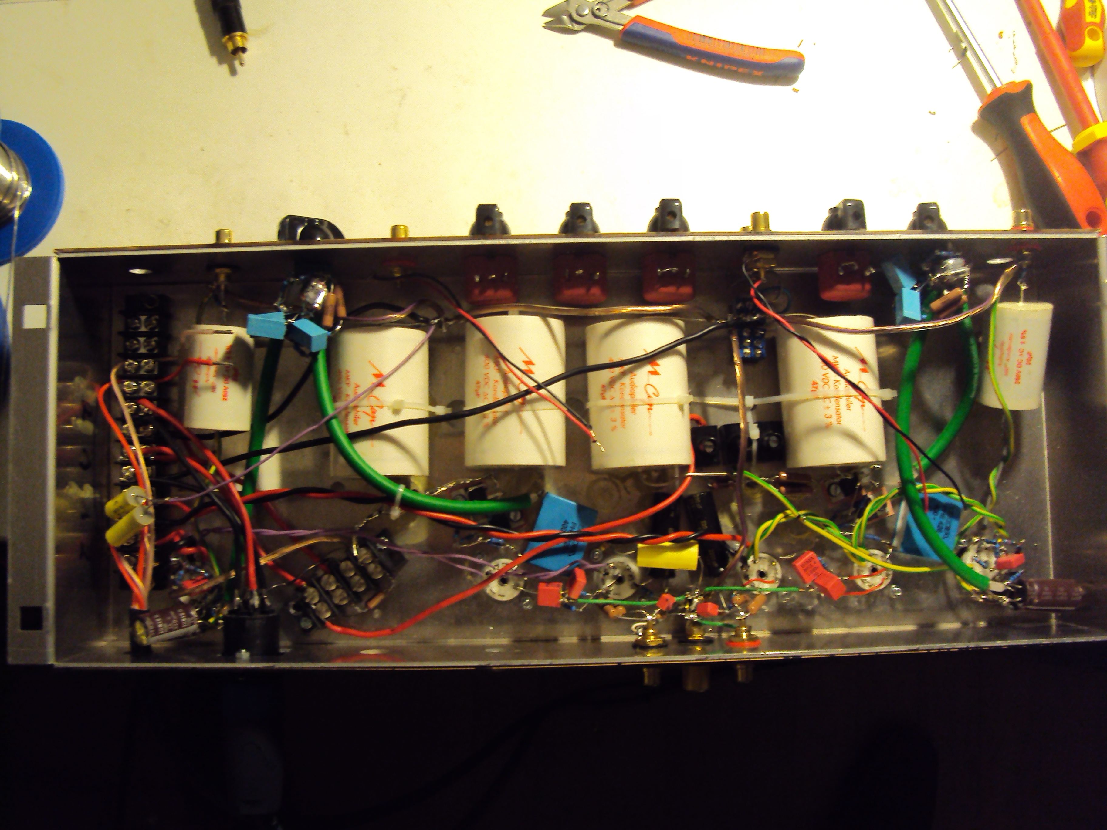

Just for fun i put back in my tube phono after some modifications.
I had a 6dB subsonic filter in the input and took that away.
I added a second output to drive my current system that has an active cardiod bass.
The tube phono has enough gain to drive the system without preamp and i added a 1:16
Lundahl amorphous core transformer.
The sound i got is pretty amazing. Before the modification the tube phono sounded a bit warm, nice but not very punchy. Now it is quite the opposite, extremely open and dynamic. On par with my best transistor stages.
The combination of transformers and tubes rooks,
