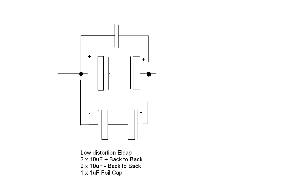

This circuit needs quite big 10uF coupling caps from the input to the shunt stage and i do not have much space on my proto PCB. So i build me a low distortion bipolar elcap. There is some controversy if bias on an elcap is a good thing but i trust the measurements of Bateman that found that for lowest distortion they like the least amount of bias posible. Bipolars faired better in his test too so i build my own version. It is made from four 10uF 63V elcaps. Two back to back positive and two back to back negative and then a good quality 1uF foil on top of that for high frequency bypass. I made one of my infamous little drawings and i hope you understand the concept. Some time ago i found a handy article about amplifier stability. I post it here for download.

Big elcaps are nessesary at the input but there is very low bias at that point and they work like a bipolar cap in this aplication so distortion from this source should be low.
They can be bypassed with a foil of say 1uF.
I have only 2200uF caps of good quality around so provided they work on a 10 Ohm feedback resistor they form a highpass with -1.8dB at 20 Hz. I can compensate for that in my sub. It has an equaliser that works in that low range.
The caps are Nichicon CL with very low ESR. They have an organic dielectric and have some leakage current so they may not be ideal here. I know at least one cap from Elna that is optimised for low leakage audio work, so that one should do a bit better. Anyway, leakage should cancel somewhat in that arrangement.
If you want to go low and have no provision to adjust here are some calculations what whould happen provided the feedback resistor is 10 Ohm. If a 5 Ohm is used the frequency doubles.
4700 uF : 20Hz -0.4dB 6.6Hz -3dB
10000 uF : 20Hz -0.1dB 3Hz -3dB
A measue of subsonic filtering could be intruduces this way and the sound can actually improve because of that.
