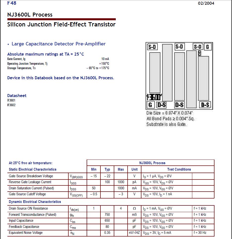

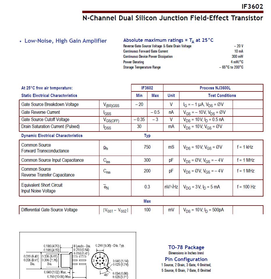

I got some data fir the IF3602 ...yes....the super Jfet.
I have 2 papers, one shows an Idss of 30mA another from 50mA to 1000mA which would seem to be basically terrible!
Also there are some plots shown and in order to reach out 250mS transconductance, Idss must be in the order of 300mA (!!!!)
Am I looking at it wrong?
Something does not come from nothing.
Yes, i know, the data is not very consistent.
I heard that from Scott Wurzer.
do you mean the data sheet are wrong?
Has anybody ever tested one of those devices? I have some coming this week.
I really hope gm is what it says it is and current is not 1A....gosh!!!
The data sheet does not say all we need, for example 1/F noise.
The high idle comes with the territory.
If you would parallel a lot of BF862 you end up with a lot of idle too.
The interesting question is if that Fet has massive Gm with less input capacitance then paralleled BFs.

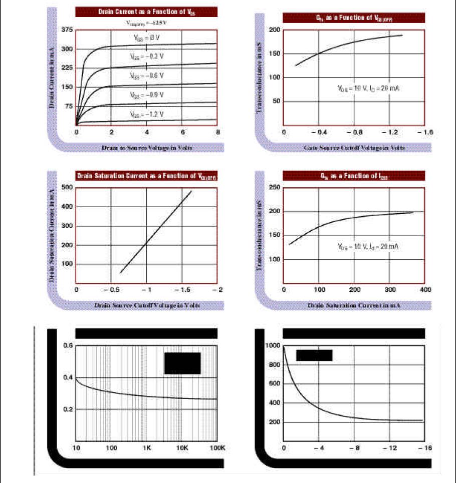

Drain current against voltage
looks really good.
This is a much better CCS then paralleled BFs.
looks really good.
looks really good.
yes I noticed it too. I just can't understasnd what the Idss is.
As an input stage, if you think about MasterPiece R7, I will try this out, but if the devicce needs to be biased at 200mA to get high gm it will be extremely hard to design the CCS around and shunt PSU and keep everything electrical and thermally stable.
Hoever, from the characteristics I can see, it looks pretty really linear to me a good linear input stage.
The 1/f, you can kinda see the noise behaviour on one of the lot shown on page 2 of doc 1.
The y shows equivalent noise en and on the x frequency.
It looks like noise is kept very low even at low frequency to a point that noise behaviour looks more like a BJT than a JFET 😱 😱

Well, this week I will reveive the Jfet, I will try to test Idss and transconductance to begin with!
I am afrrais, since I can't really deduce it from datasheet that Idss varies largely and can get huge.
If that is the case this device would be useless given the high price tag to find matched pair for a stereo amp.
Also, like I mentioned if it needs 200mA of biasing to reach out 400mS or 750mS like datasheet says, then still makes it hard to use!
