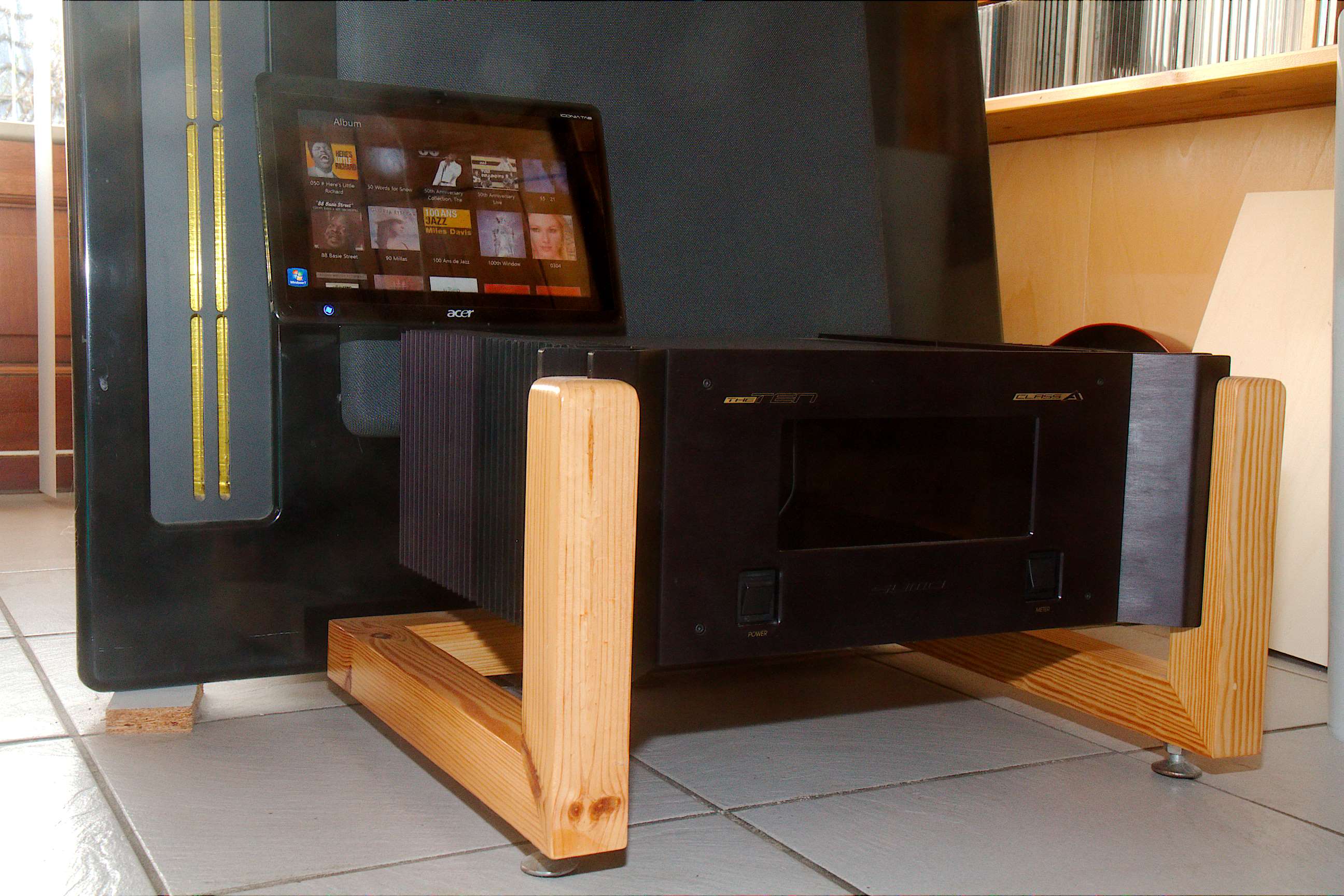

🙂 this here is a picture of Colossus at work 🙂
Nice panel !!!
This is a heavily damaged one that I got of eBay, I got a pair of them for 1000US and shipping to here was handled for flight cost only by a friend of me. My own 2 panels look mint, but one of the low-range-speakers is non-functioning, it will be replaced by the 'American'-spare 🙂. The 'American'-spare is currently in the system to test/evaluate it, these panels 'Carver Amazing, Platinum Edition' are now more than 20 years old, but I have 4 spare magneto-stats in the 'American'-spares 🙂. The sound is nice mellow and real loud as needed (one American magazine claims the have gone to 118dB).
This is a good/nice read: Carver Amazing Loudspeaker (Platinum Edition) | Stereophile.com
Is that the hand-held one light year model?
Good catch 🙂 yes it is 🙂 actually giving the right circumstances it will do a few light years more. The guys from ATL sometimes play tricks when controlling my system from their home (go figure). I never give them my passwords again 🙂

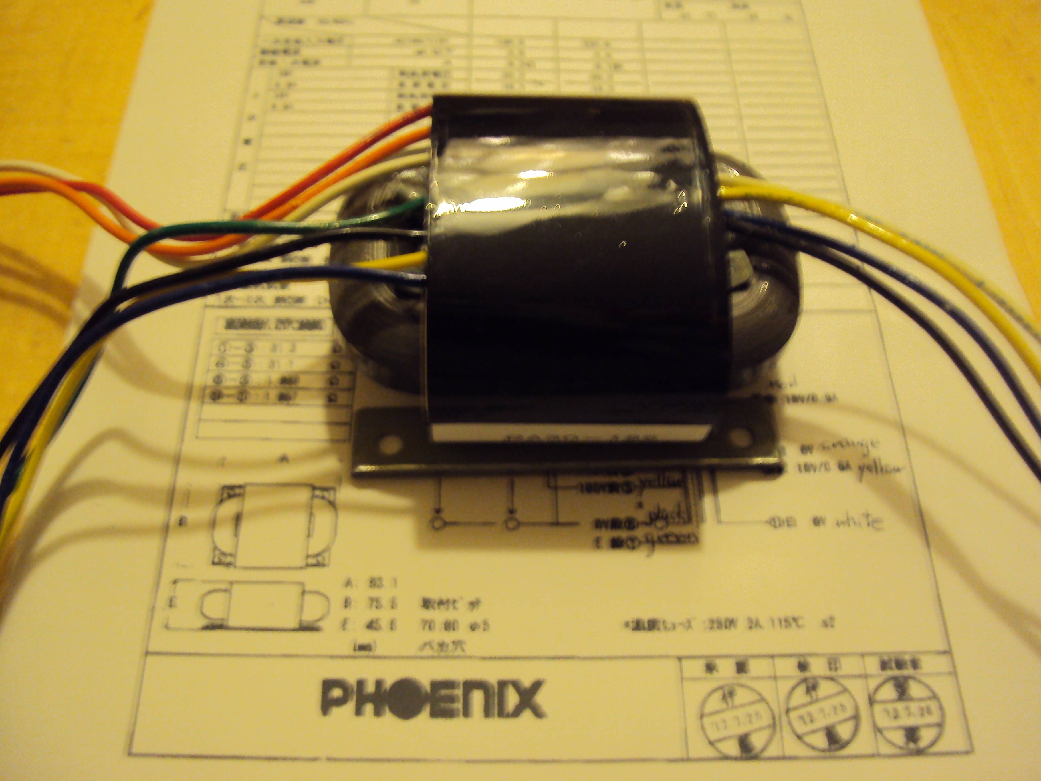

Got some nice R-Cores from Japan. They are not cheep though. Over 100,-€ per pc. plus tax and shipping. They are 30VA and give a plus-minus 18V DC supply.
Can be used for the Paradise.

Cool r-cores JG... any hint on how to get some of those ?

I can get this transformers from Japan but as i told you they are not cheep.
