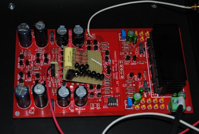

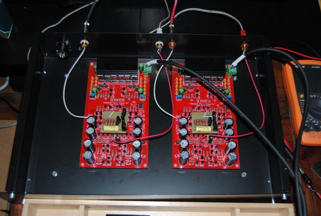

Yes.. amtrans.. They sound ok but I will never use those again as they differ more than 20% from spec and present great variations between samples.
The yellow cap is my fav... Polystyrene on tin foil... quite juicy stuff.
The vertical trim pot I use for cart load is a bulk metal from vishay... quite good.
The 6800u caps are FR and the others are 2200 FM + 470u BG
