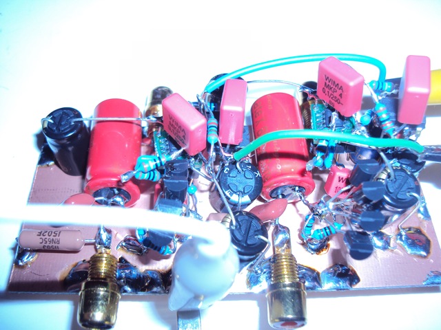

I have build his MM stage in modified form many times ( JG-Self RIAA ) and it is dead accurate like a passive but with the advantage of 14dB more dynamic range in the treble. From the traditional, series feedback based circuit, this is one of the best.
I never have build his MC head so i did that today. Of cause i made some changes. I took out the Elcap at the outout, it is not needed. Istead of an NE5532 i used an OPA1641 and the servo is not a TL071 but and LF411. I used very good passive parts, the input cap is a Black Gate for example shunted with a PPS. In result this stage works very well. It is very low noise and sounds very even without grain and sharpness. Space is great too. I would say an underrated design that deserves more attention. OK, it is not very innovative except the shunt bias of the input transistors. I have seen circuit like that that trace back into the late 60th. On the other hand it is a mature and sound design, compact, inexpensive, easy to build and efficient. I like it as a quick fix and also for much more.
Here is a picture of my build. It is quite compact.
The ouput stage is a bit unusual. DS burns around 5/6 of the voltage swing in a resistive devider that gives an acceptable load to the opamp and gives a low output impeance. I would use a buffer and a current source on the input transistors. That way an all in one go RIAA can be made. I build something like that with Fets at the input that workes very well.
I think he does that because this stage has lots of gain and is not easy to stabilize. With the values i use plus my different opamp i had to raise the compensation cap to 43pF. With Selfs 10pF it oscillated.

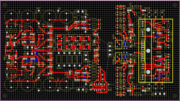

Saw that too, I think its a lot of components... Paradise is a good example of how that can be achieved with much less components, and in my opinion much more elegant. But I am not a phono stage designer at the level of you or Self, so who am I to tell....
This is what "Paradise regained" looks like right now. Schematic is captured, placement of components done, routing has started. This now has the current source on the left side, input stage in the middle, the RIAA elements and current source next to it and very close, and the output buffer. The servo is at the bottom in the middle, close to the buffer. The shunt regs are where they were before. Board dimensions are the same as before. More as it progresses.....
