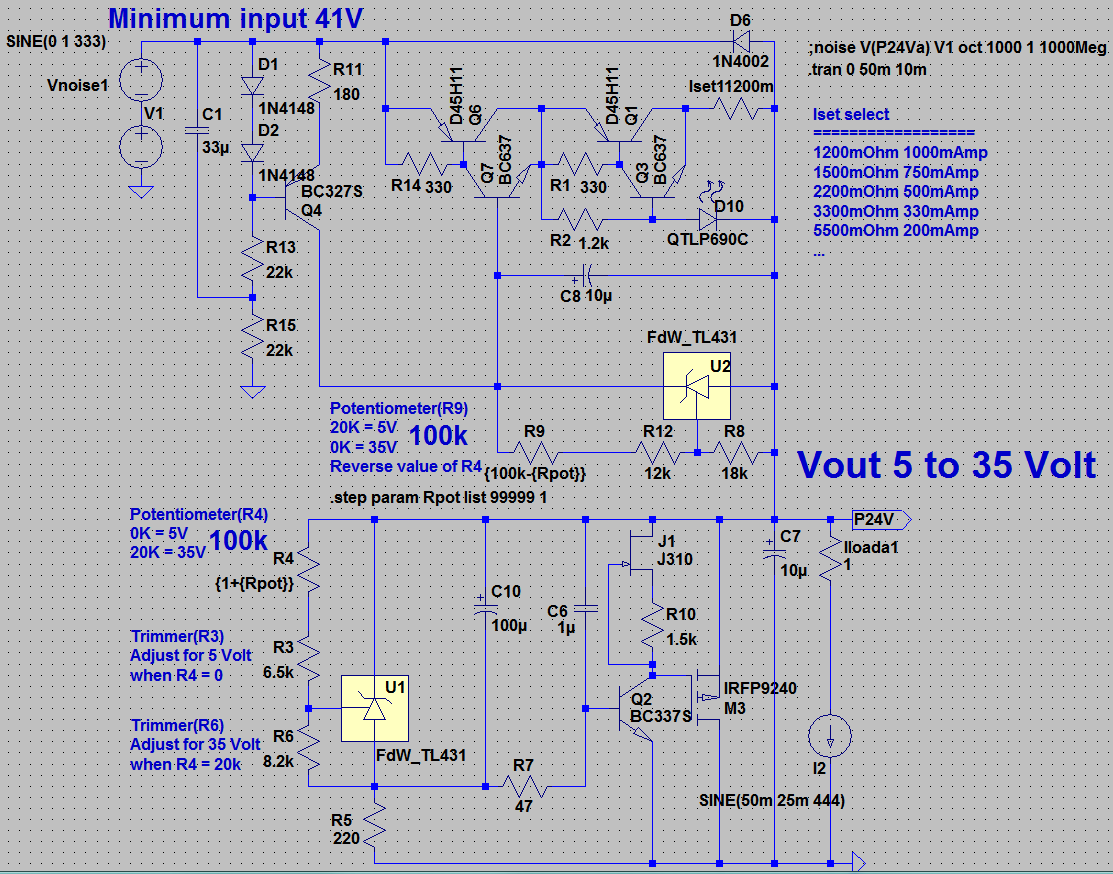

So here it is 5 to 35V up to 1Amp, maximum dissipation at IRFP924 35Watt (when Vout 35Volt @ max 1Amp), and at each of the power transistors 17Watt (when Vout = 5Volt @ max 1Amp).
Tanks Frans
briliant that wuld make prety decent lab suply to try things out and most of all real good circuit to study and learn.

Don't happen to have a larger image of the LT413 power shunt ?

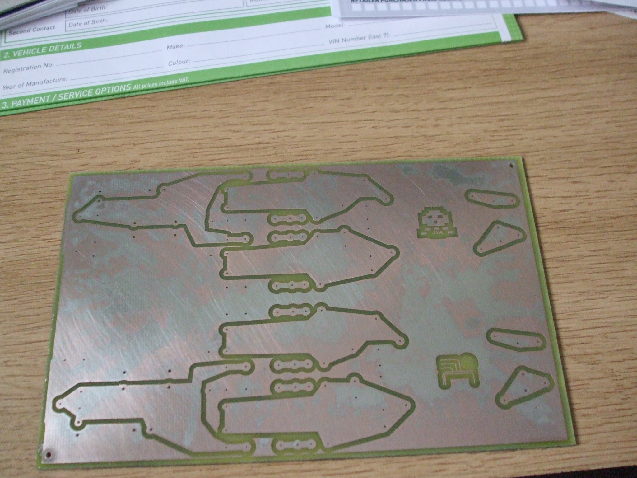

I will draw now the new version of the Paradise.
The input will be virtually unchanged, the mirrors get an improvement, the RIAA gets Ricarrdos values, the complicated output buffer will be substituted with my floating cascode J-Fet buffer and Fans new PSU will be implemented. Hesener will make a new layout with all he learned debugging the orininal version.

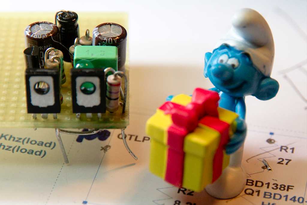

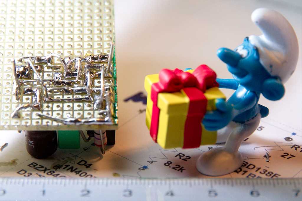

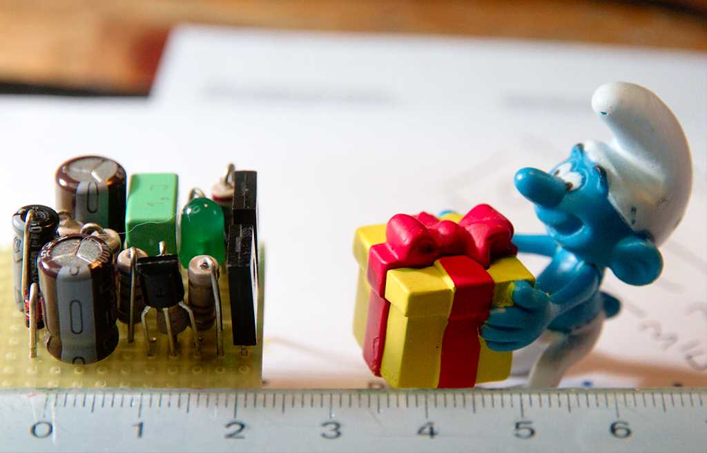

Nice, I did not finish the regulators this weekend, I did destroy my new (currently being build) amplifier and took most of Saturday and a large part of Sunday to fix that. (I did made some re-wire errors after a small modification on the vero board).
Now my regulator proto types will be finished by the end of this week. I am aiming for a board size of 4 or 5 cm2 (that is half of an square inch).
And, yes, the transistors need a heatsink (5 to 10 deg/watt).
P.s. This design is not intended for the Paradise (it is to under powered for that).
P.s. This design is intended for amplifiers that may have a few, 2 or 3, opamps that need to be fed from the amplifier supply at up to 80 volts.
Here is one, the mini ATL PSU + side. About 5 cm2 🙂
