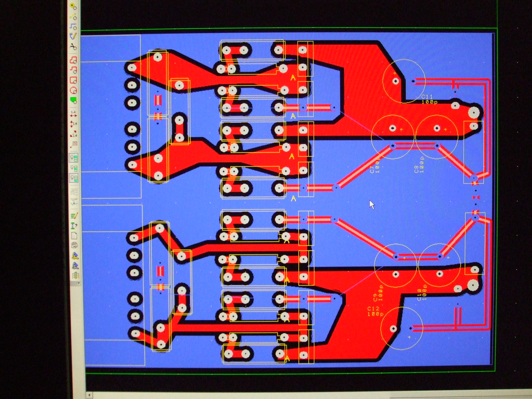

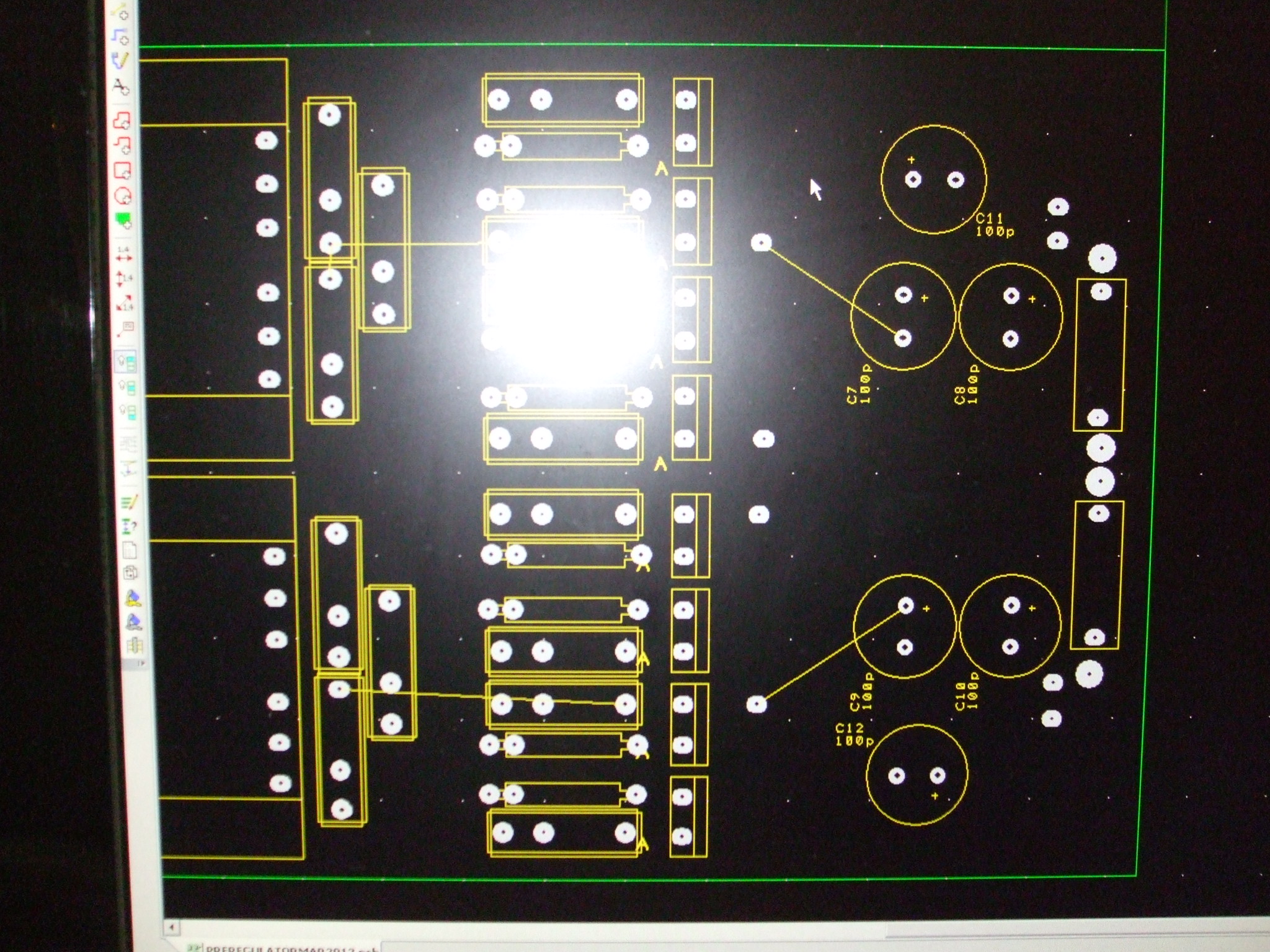

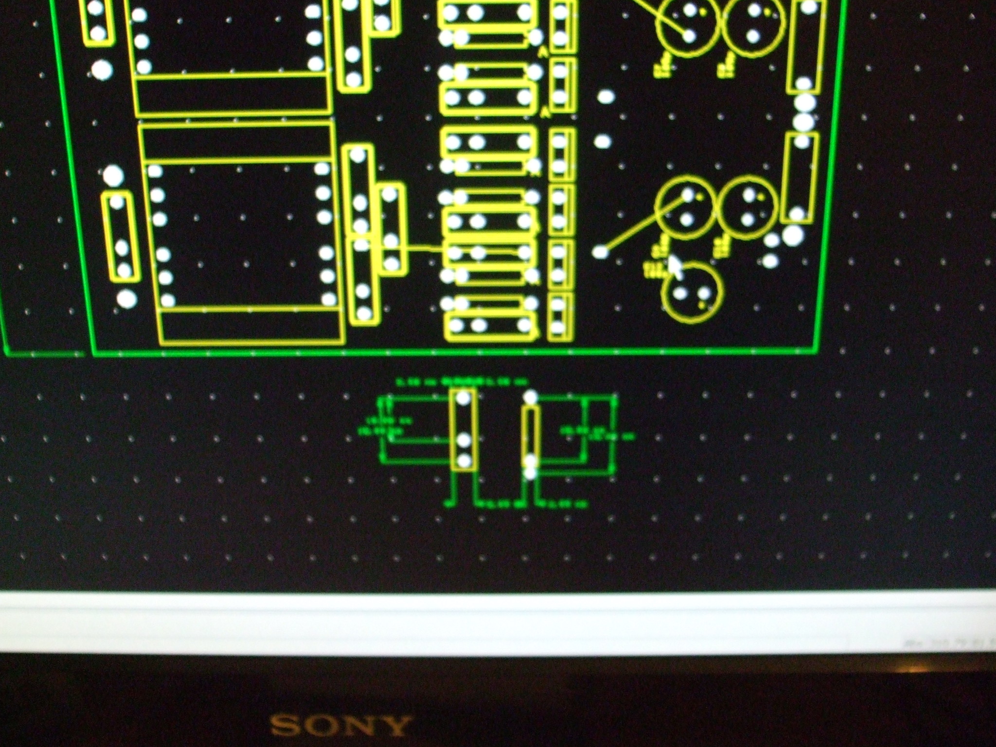

I will have to play about with the resistor position on the current board...
There you have it
(bit of tidy up to do but not much)
Same board caps foot print 10 and 15
Resistor foot print 15 and 18 mm
Straight pictures from monitor (take less to change a board around than to print and post new drawing.
Board blue HI light on ground (botom half need same cooper poor area... later
Silk screen
And silk screen close up for new foot prints

There you have it
Silk screen
beautiful!
Metal films chosen by Frans are supposed to be less noisy then the metal oxide i use. At that low value of resistance it does not make a difference i think.
Even 63V is enough for the caps. I would prefer MKP4 though.
Also they (maybe) a little more stable, but you are right about the application context here, it will not differ.
Setting the resistors upright might an advantage, the proposed resistors are 75 K/W and getting a bit more air around them will help. So I do not mind the selected drilling spacing.
P.s. The board looks real nice!
