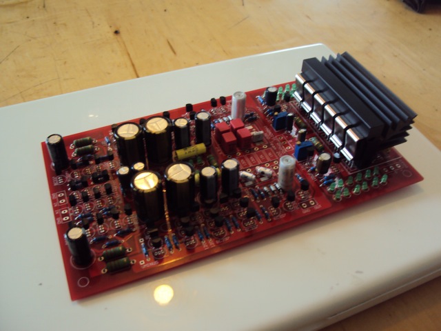

The first Shunt is mounted. It is a bit tricky to adjust the "legs" but it is possible.

But does it work (now you would like those bridges 🙂)
P.s. Is that one leg in the neck 🙂
Yes, that PCB comes out looking nice, no matter how you stuff it.
No, Frans, it is not working yet. I go the Ricardo all in one way, love me or leave me.

I used a lab supply with both voltages tracking to power up, and the Paradise should draw 150mA each rail. If it doesnt, or the supply voltages after the shunts go above +/-24V its time to power back down.... didnt happen to me though.....
Just waiting for feed back I had no chance to buid proto so far
I have posted 2 boards one with diodes lined up on long side which my be better for my own build.
If FDW let me know first impressions and further changes needed I be more than happy to carry on.
