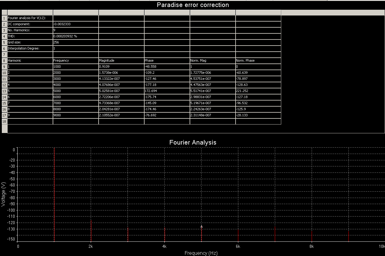

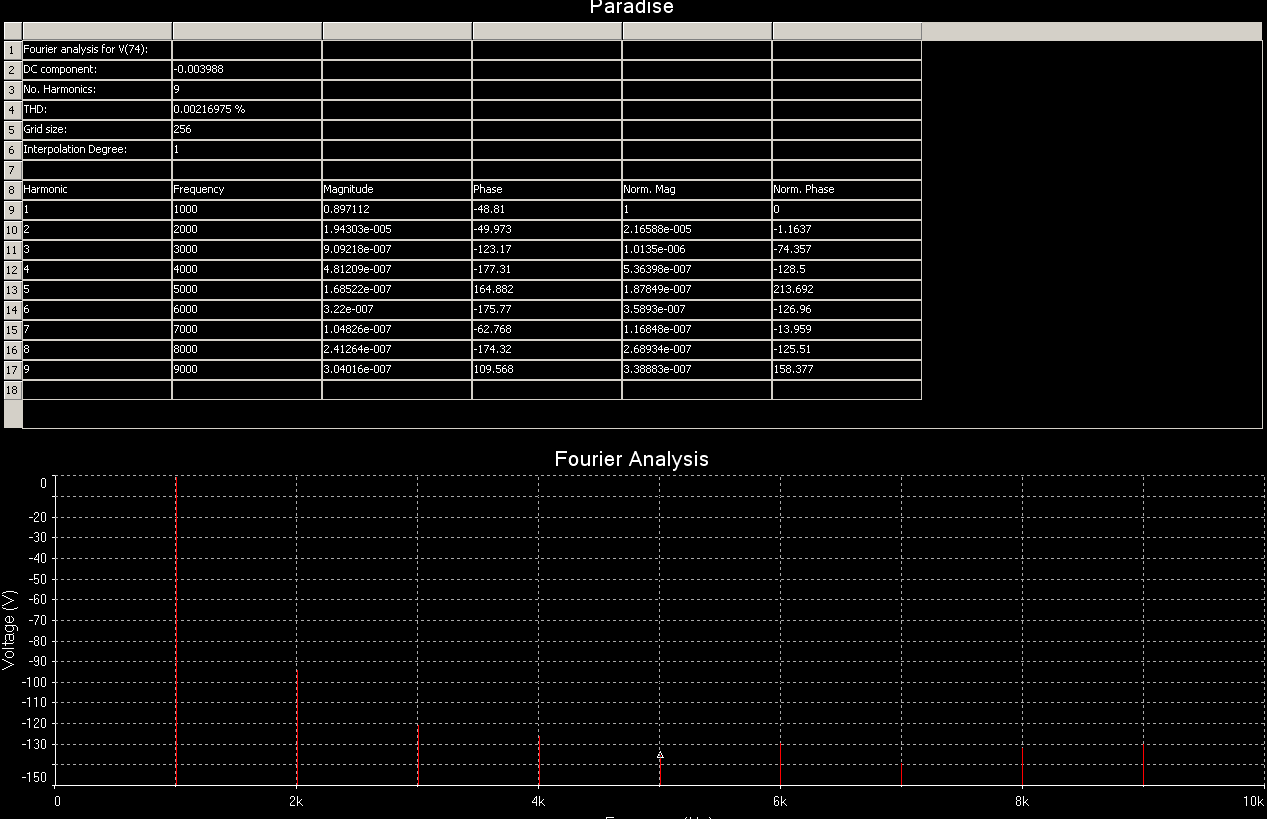

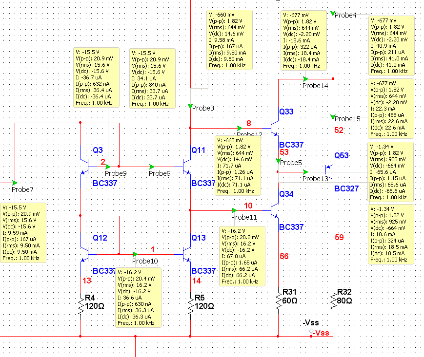

I promised some ideas, regarding basic building blocks (mirrors and buffers in particular) of phono stages that we are discussing here, so here it goes… I know you Joachim are crazy about buffers, so I can understand that this paradise mirrored driven diamond cascode (or whatever you can call it) in all it’s glory is really excellent, but is it not over engineered a bit ? This is not a problem at all with current el cheapo parts, but it sure looks like it could go straight to space (ATL labs put a hand on it I’m sure 🙂). Now the way I see it, largest non linearity's (and hence thd) arises from our beloved current mirrors. Although helper transistors do help with beta matching and further cascoding reduces base current modulation, early voltage effects are still visible even in sim’s. So I gave a thought or two about addressing these issues. One could through GNFB loop around it and call it a day (look ma, no thd! at last I have ideal components!), but that is what I personally would call bad practice and it's like fighting birds with ballistic missiles. Now I'm sure there is a couple more ways to skin this cat, but this one I actually saw implemented in one peace of very expensive measuring gear, that I had for repair. I will be honest here, I didn't get it at first sight, and thought it was just kind of bootstrapping buffer, but yesterday I remembered this piece of circuit, took that repair manual again and clearly this was error correction. I don't know if I have to go step by step here on how it works, as I'm sure most of you can figure that out just by looking at attached pic, but the basic idea behind this trick is to keep the net value of incoming and outgoing currents from mirrors to 1 by introducing “lost” base currents. What we have here is simple cascoded current mirror and addition of Q33, Q44 that runs at 2 times more current then mirrors, introducing approximately 2 times base currents for correction and bootstrapping Q53 who ensures that Q33 Vce stays constant, hence no base current modulation occurs. But the best part of it (cherry on top) is that you get quite a buffer for bonus that can swing 1Vrms to 600 Ohms all day long almost without any significant increase in thd. Headroom is also increased from 22Vpp in original paradise running from 24V rails to 32Vpp on only 18V rails before clipping. Now that is a clever piece of engineering or what ? 3 in 1 as they say. I attached thd sim’s for current paradise version and paradise front end with error correction + buffer. It works in theory and I’m sure in practice to some extend as well. Device power dissipation can be solved with paralleling (I didn't wonted to spoil the picture) and hfe matching (except maybe Q53) is a must.
I have to put a disclaimer here that this is not a bashing of great design, and I’m not proposing to implement this to current release of paradise, as this would require a lot of remaking for psu and pcb’s. Just a food for thought as how things could be made more optimal in future.

Sampler, i have to digest it but error feed forward is a great way to do it. I can make a better mirror too then in the Pardise but i decided on moderate output impedance because of DC offset issues.
What i would really like to see is your design in parallel symmetric ( if better or necessary ) with a balanced, differential input stage. J-Fet input or not. If we only use N-Channels this is not a component sourcing problem anyway. We can call that the Starless-Balanced and i would 100% support that design.
