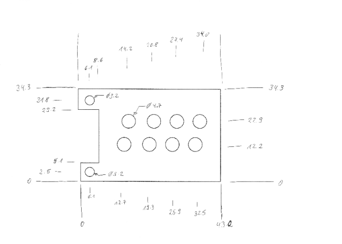

Here is a drawing of the dimensions. All in mm.
I have added two flanges where the thing may be fixed on the PCB. This would accept a 30x30mm heatsink on top of it quite nicely, aluminum or other (silver?). Not sure its needed though, some thermal grease to make good contact is probably enough.
Have measured a few different TO92's in the lab, and they all are between 4.58...4.63 in diameter where the belly is the widest ;-)

Sorry Alfred,
by looking to the pictures of the Boards
i'm in doubt your drawing is correct.
5mm thick should be good ?
I'll go for CuSn bronce.
Should we do the mounting holes with M3 threads ?
Will there be screwholes in the final boards ?
Or shold the 24Q-legs be strong enuff ?

Hi Benedetto, I have taken the dimensions from the PCB layout tool (in mil) and converted to mm, that is why there are some strange values. The drawing is not to scale, but the dimensions should be correct. The legs of the transistors are somewhat bendable so it doesnt have to be super-precise. I would prefer to not rely on the transistor legs to hold it, thats not good for reliability purposes (solder joints should not see mechanical stress, thats a no-no in power electronics).
5mm thickness should be good enough. Right now there are no screw-holes in the boards but they can be added. The places I suggested would fit with the wiring on the PCB, only groundplanes there. Threads in the holes would be great, and with 5mm there should be enough metal for good holding.
