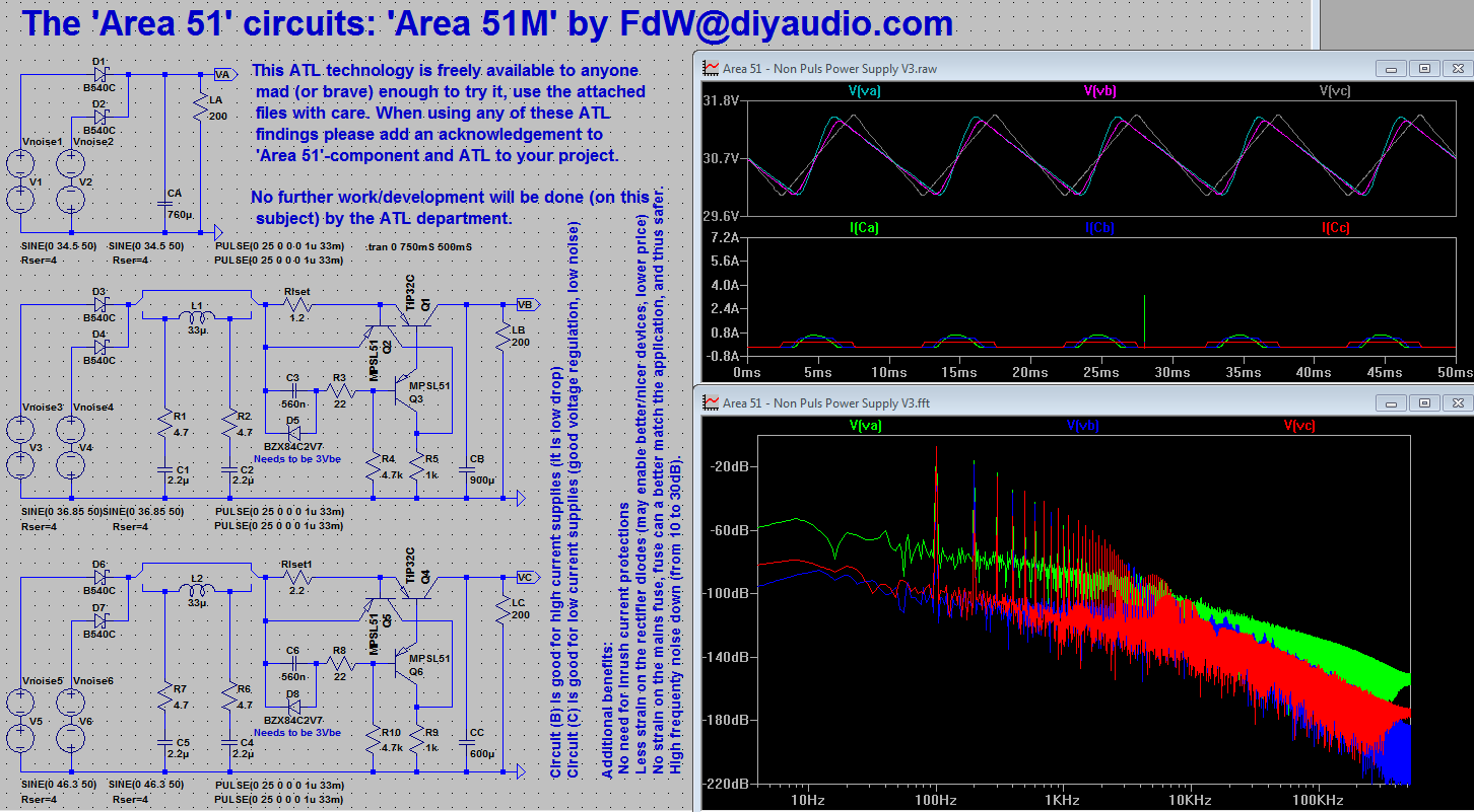

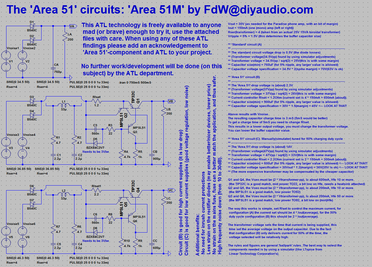

Today the man at the ‘Alien Technology Laboratory’, short ATL, are back from the party, they are now supplied with a nice, migraine like, headache. It seems that these man (from ATL) think better with the headache then with a party coming up (but boy do they like that enclosure).
They are sorry for the mistakes that crept in to the text posted message 4722 (http://www.diyaudio.com/forums/analogue-source/154210-mpp-473.html#post2873390). Also they improved there component choices, the circuits, as now presented, are more ‘real world’ applicable.
Any way here is there text:
We are sorry, sorry, sorry, sorry, sorry (sorry for the mistakes …) :headbash: :headbash: :headbash:
This ‘Alien Technology Laboratory’, short ATL, technology is freely available to anyone mad (or brave) enough to try it, use the attached files with care. When using any of these ATL, long ‘Alien Technology Laboratory’, findings please add an acknowledgement to ‘Area 51’-component and ATL to your project.
No further work/development will be done (on this subject) by the ATL department.
Circuit (B) is good for high current supplies (it is low drop)
Circuit (C) is good for low current supplies (good voltage regulation, low noise)
Additional benefits:
No need for inrush current protections
Less strain on the rectifier diodes (may enable better/nicer devices, lower price)
No strain on the mains fuse, fuse can a better match the application, and thus safer.
High frequency noise down (from 10 to 30dB).
Vout = 30V (as needed for the Paradise phone amp, with an bit of margin)
Iout = 150mA (one (mono) amp (left or right))
Rser(transformer) = 4 (taken from an actual 25V 15VA toroidal transformer)
Vripple = 5% = 1.5V (this determines the buffer capacitor size)
** 'Standard' circuit (A)
** The standard circuit voltage drop is 0.5V (the diode losses)
** (Transformer voltage(34.5Vpp) found by using simulator adjustments)
** Transformer voltage = 34.5Vpp / sqrt(2) = 25V(this is with some margin)
** Capacitor size(min) = 760uF (for 5% ripple, any larger value is allowed)
** Capacitor voltage specification = 34.5V * 2(spike margin) = 70V(63V is ok)
** 'Area 51' circuit (B)
** The 'Area 51'-drop voltage is (about) 2.3V
** (Transformer voltage(37Vpp) found by using simulator adjustments)
** Transformer voltage = 37Vpp / sqrt(2) = 26V(this is with some margin)
** Current controller RIset = 1.2Ohm (current set is 4 * 150mA = 600mA (about)).
** Capacitor size(min) = 900uF (for 5% ripple, any larger value is allowed)
** Capacitor voltage specification = 30V * 1.5(margin) = 45V <--- LOOK AT THAT!
Above results with Vnoise.
The resulting capacitor charge time is 3 mS (5mS would be better)
To get a charge time of 5mS you need to change RIset.
This results in a lower output voltage, you must change the transformer voltage.
You can lower the buffer capacitor value.
** 'Area 51' circuit (C). Manually(simulator) tuned for 50% charging duty cycle
** The 'Area 51'-drop voltage is (about) 14V
** (Transformer voltage(47Vpp) found by using simulator adjustments)
** Transformer voltage = 47Vpp / sqrt(2) = 33V(this is with some margin)
** Current controller RIset = 2.2Ohm (current set is 2 * 150mA = 300mA (about)).
** Capacitor size(min) = 600uF (for 5% ripple, any larger value is allowed) <--- LOOK AT THAT!
** Capacitor voltage specification = 30Vout * 1.2(margin) = 36V(35V is ok) <--- LOOK AT THAT!
** (The more expensive transformer may be compensated by the cheaper capacitor)
Q1 and Q4, the Vceo must be (2 * Vtransformer-pp), Ic about 600mA, Hfe 10 or more.
(the TIP32C is a good match, mid power TO22, a bit low on Hfe, needs a heatsink attached)
Q2 and Q5, the Vceo must be (2 * Vtransformer-pp), Ic about 200mA, Hfe 10 or more.
(the MPSL51 is a good match, low power TO92)
Q3 and Q6, the Vceo must be (2 * Vtransformer-pp), Ic about 200mA, Hfe 50 or more.
(the MPSL51 is a good match, low power TO92, a bit low on (min)Hfe)
The way this works is simple, set RIset to control the maximum current, for
configuration (A) the current set should be 4 * Iout(average), for the 50%
duty cycle configuration (B) this should be 2 * Iout(average).
The transformer voltage sets the time that current is being supplied, this
time set the average voltage on the output capacitor. Due to the fact
that configuration (B) only delivers current for 50% of the time, the
voltage selected will be relatively high.
The rules and figures are general 'ballpark' rules. The best way to select the
components needed is by using a simulator (like LTspice from
Linear Technology Corporation's).
Under NDA for ATL
Frans.
