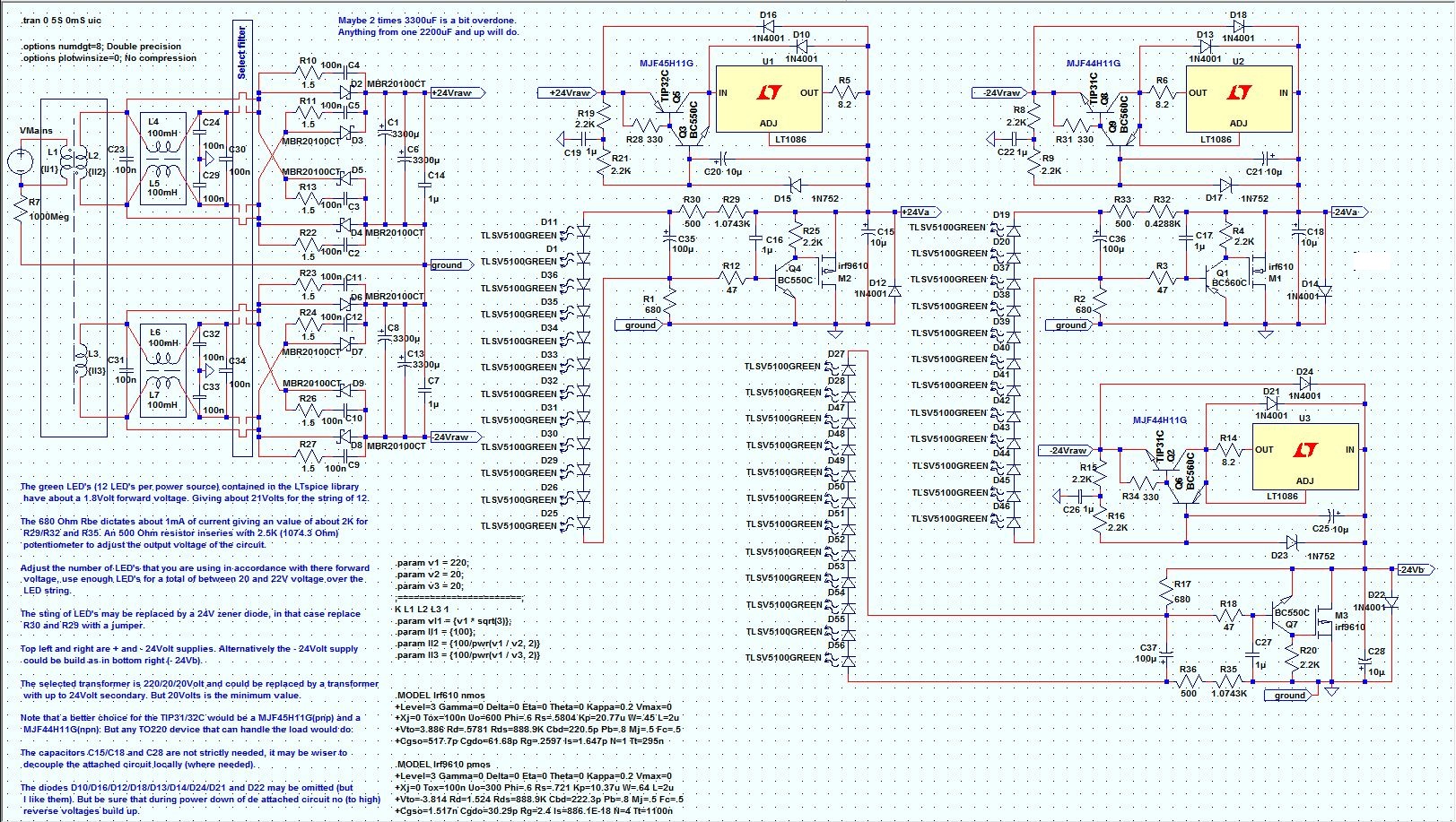

Jose`, these are LC Audio low noise regulators. Then there is on board RC filtering plus all Opamps decoupled locally. All double mono.
Thanks Martina. This thread changed for the better since we have teamed up. Things get faster and more professionally done ( although this is a hobby ) and we will now have a completed circuit with PSU including PCBs.
That will enable people to build the Paradise stage much easies then before where i only posted fragments or perfboard 2p2 and dead bug designs. Some miss my porcupines though.
Does it answer the question that i always get : "How can i build the best phonostage in the world for minimum outlay, success guaranteed". Maybe not but we come close.
In my simulation C16 and C 17...makes the shunt prone to oscillation...How does this look in real life..??
michael
