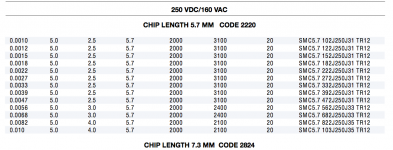

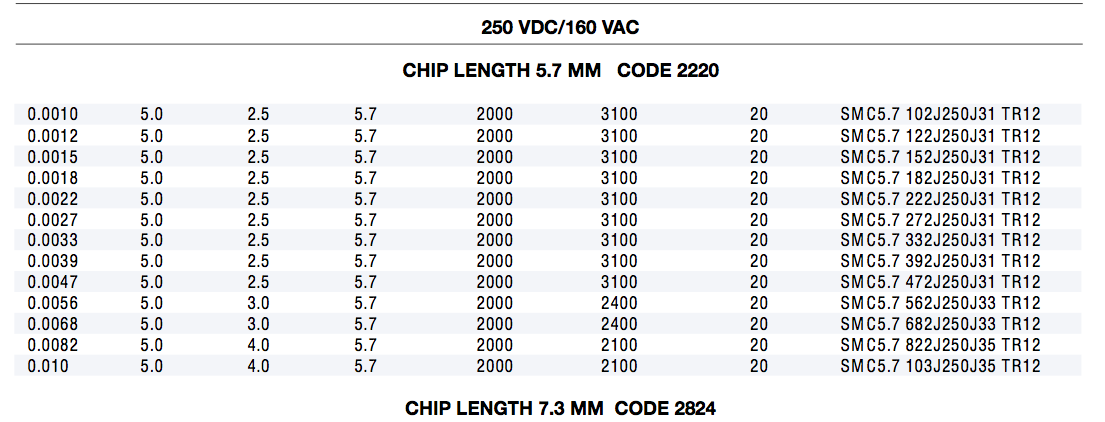

I also like Evox-Rifa PPS SMD. The same ones that the late Allen Wright used.
They are a bit expensive anyway and the stages i build with the Wimas sounded fine.
The tolerance is 5% but in praxis they are much better. They also have no steel caps and they solder like in heaven. https://www.distrelec.de/folienkond...0-vac/evox-rifa/smc5-7-682j250j33-tr12/828213
Hesener, could you modify the layout so that we can use them as an alternative ?

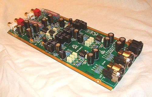

HiRicardo,
my first approach was to put place for two caps so people could select and put whatever they want in parallel.... anyway, the choice right now is to put Wima FKP1 so I will change the footprint to that, should fit most others anyway.
what is the size and grid spacing of your caps, just curious?
My p2p program (ExpressPCB) uses 2,54mm spacement between holes.
The 40n cap is 9 holes long (23mm) and the 14n cap is 12 holes long (30.5mm)
