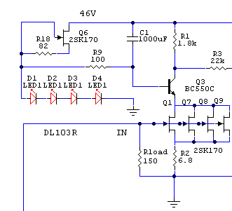

looking at an old circuit (the elektor preamp with MAT02/MAT03) i remembered that we used LEDs as low noise voltage references in the old times. i can not remember which ones had the lowest noise. we used red ones because they were the only ones awailable at that time. i implemented that idea into the MPP and added a resistor in series with the bias fet to reduce capacitive loading. actually in one of my commercial designs i use that capacitance to optimise square wave response so this "flaw" came in handy. in our times i may try the new ultraviolet ones because they are so pretty.
Red,Green,Yellow or IR, absolutely lowest noise depends on the particular batch or model. I use Leds a lot for that. First stage's cascode bjt on fet in the Simplistic Riaa has its base referenced on a ccs jfet fed led string at about 7.5V.
