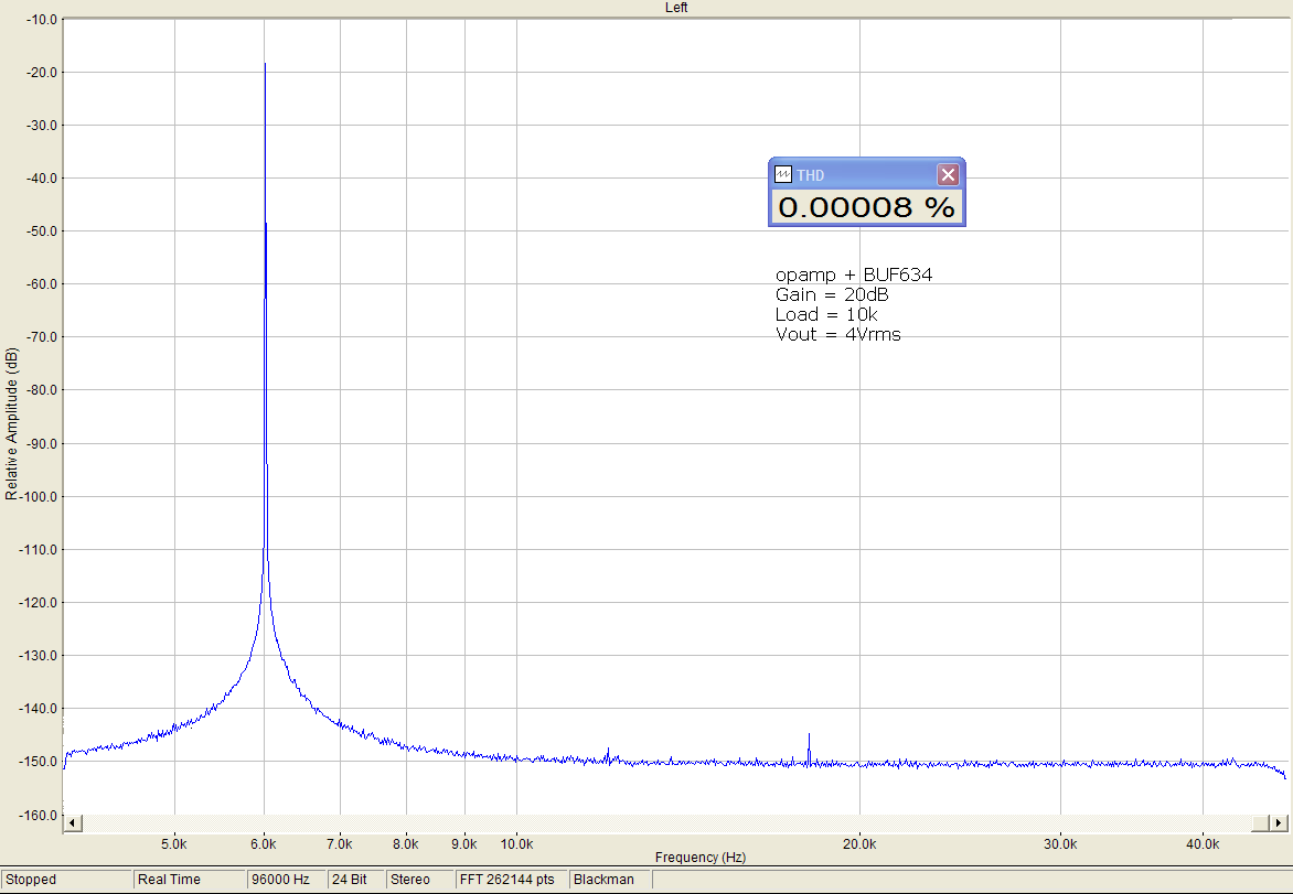

That's a perfect idea, please consider my 2 cents:
Hi Pavel ! I thought so too. So this is your new buffer. Looks good. I hope you will post things like that on my new thread.
