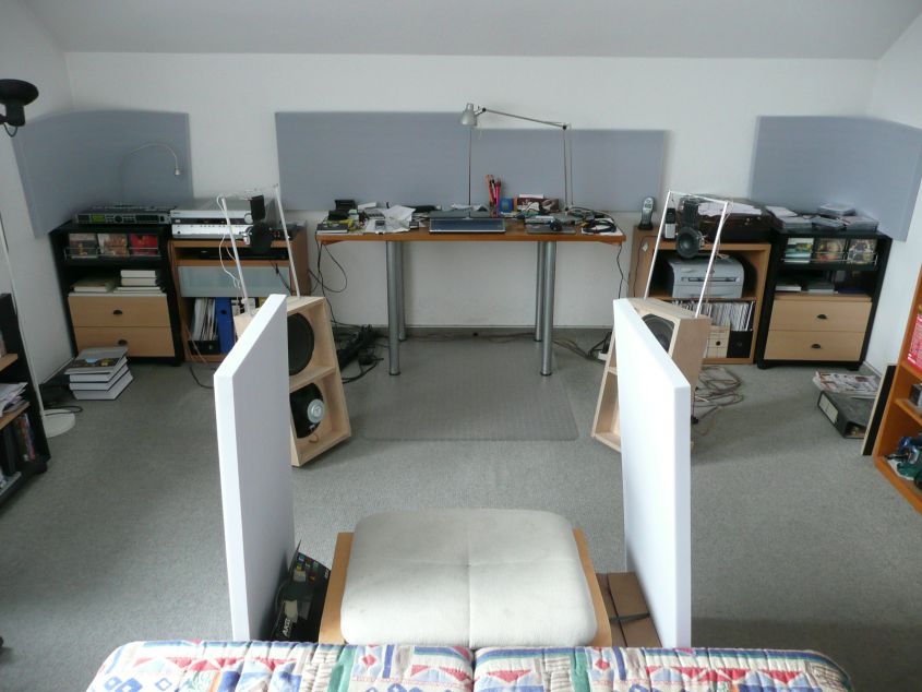

Lately I did somewhat the opposite of your experiment. I placed two absorptive baffles of 4 cm thick Basotect left and right from my listening position:I saw in another thread a discussion how reflective baffles can be used to advantage.
Above 1kHz they (hopefully) kept all the contralateral and some of the ipsilateral reflections from my ears. It was very instructive to learn how those reflections can change the auditory scene.
