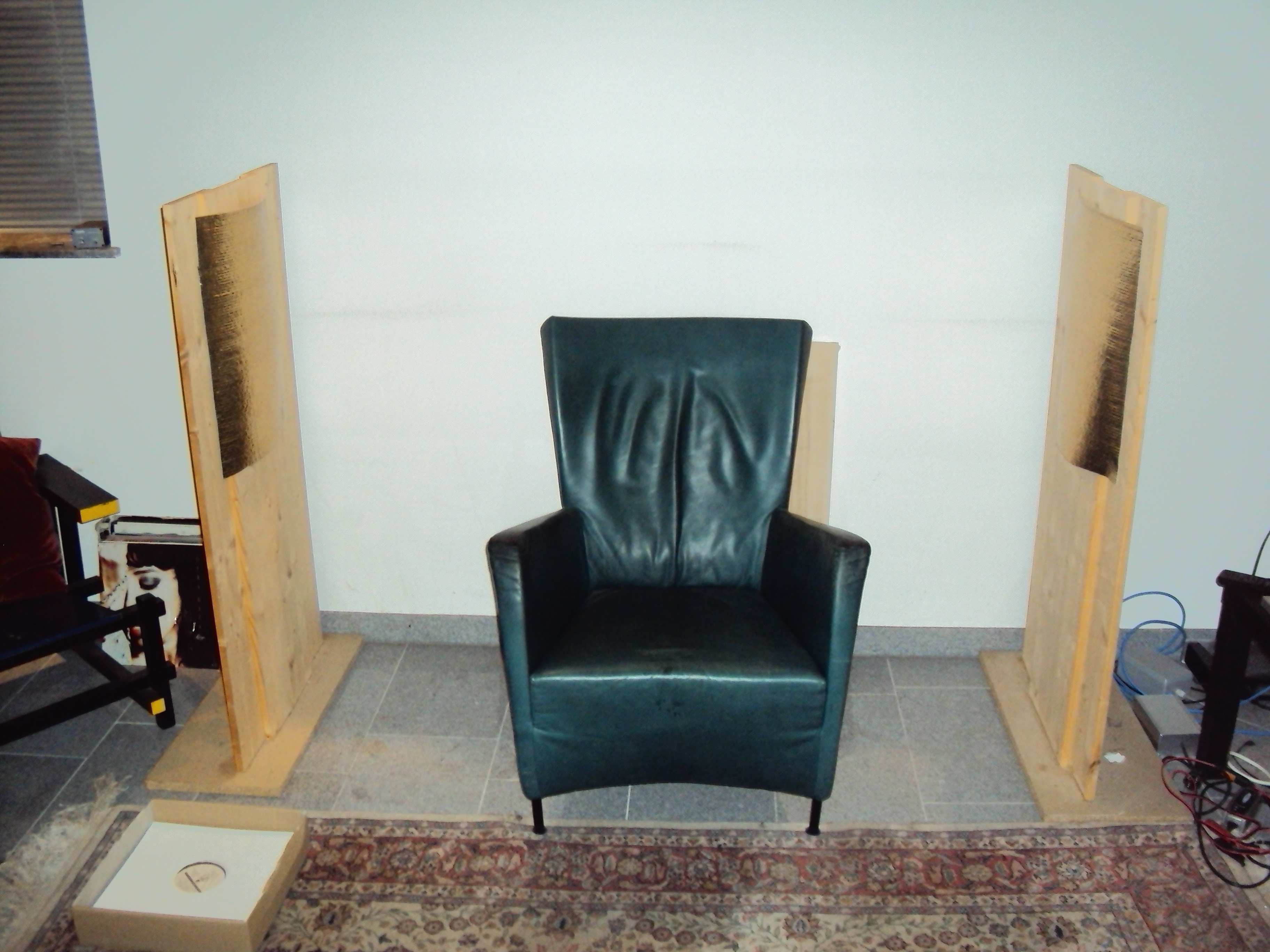

I saw in another thread a discussion how reflective baffles can be used to advantage.
I liked the version with the baffles on the sides of the ears. I think they do at least two things : producing lateral reflexions and mixing some of the output of the left speaker into the right ear and wise versa. They are also shielding longer lateral reflexions from the side walls.
So i build two baffles and listened.
The effect is a bit like the Linkwitz Watsons but without the pressure on the ears.
This system also does not need an amp plus delay and it is dirt cheep.
The L-R, R-L cancelation should improve separation and it does to a certain degree.
The lateral reflexions should give some pleasant spaciousness and the shielding of the side walls should reduce artificial reverberation from the listening room.
Actually the sound is more focussed and separated. The effect can be adjusted a bit by sitting more or less backward and forward. Sitting maximum backward gives the strongest focus but also a slight claustrophobic effect.
I found the sound best when the reflexions of the speakers are focussed on the ears.
That gives very good focus with natural spaciousness when the recording allows.
That is approximate when the ears are in the middle of the panel.
See a picture where i hold a mirror to the right panel and you see the left speaker.
What drive units are you using ? What is the purpose of the shinning cover ?
This reflectors are all passive. The gold foils covers some holes from another experiment.
The foil is slightly bend so i thought that the refections get a bit scattered.
I did some more listening tests. It is quite fascination to move the seat back and forward.
I am now sitting 5cm more forward then yesterday and the sound is even more natural.
If i sit even more forward then this the sound gets less focussed and "weaker" in energy. If i sit more backwards there is more slam ( much more ) and focus ( slightly more ) but there also comes a kind of hollow tonality.
